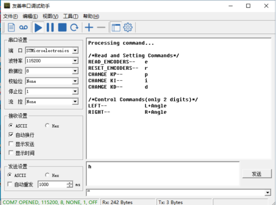

    Power on the STM32. If the STM32 is using a USB-emulated serial port, software installation will be needed. I'll include the relevant details at the end of the document. Open the serial port debugging assistant, type 'h' and then press the Enter key, and click Send. The help information will be printed out. You can see the supported commands, such as reading the encoder position, modifying PID parameters, and rotating left and right, etc.
    Control software user interface with commands for setting motors
    Next, in the serial port debugging assistant, send "L90" and press Enter. Then observe the motor rotating 90 degrees. However, note that the motor has some wobble and the response speed is relatively slow.
    After that, gradually increase the Kp value until the wobble amplitude decreases and the motor's response speed gradually rises. When vibrations near the target position are noticed, start increasing the Kd value to suppress these vibrations. When the Kp value is adjusted to 500 and the Kd value to 900, the motor's wobble situation improves significantly, as shown in the video.
    Although the vibration issue is resolved, after several rotations, the motor's error gradually emerges, as shown in the figure below. After a full rotation, it fails to return to the original point.
    So next, I increased the Ki value. But it's recommended not to increase the Ki value too much, usually within a range of a few tenths of a unit. Here, I set the Ki value to 0.01 to correct the error generated after each rotation.
    With this, the basic adjustment of the PID parameters is almost completed, and the motor can execute my instructions very well.
