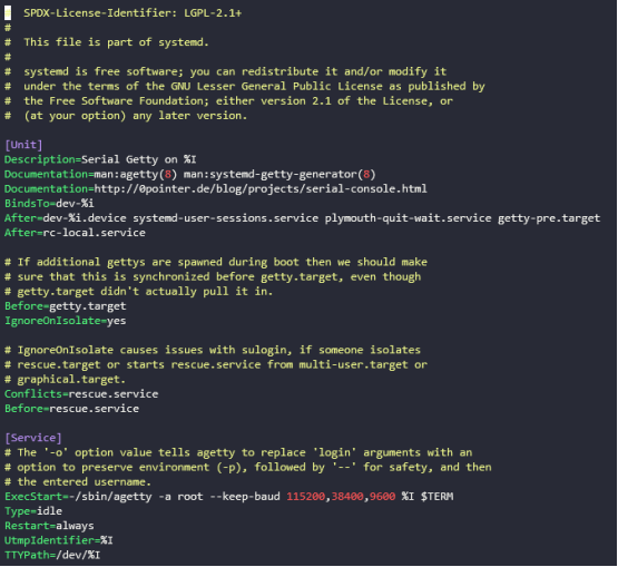

    Configure automatic login for the serial port.
    A code snippet changing the configuration of a serial port service in Linux.
    Modify BindsTo: Change dev-%i.device to dev-%i;
    Modify ExecStart: Change -/sbin/agetty --keep-baud 115200,38400,9600 %I $TERM to -/sbin/agetty -a root --keep-baud 115200,38400,9600 %I $TERM (If there is an -o parameter after -/sbin/agetty, please delete it to ensure consistency after modification).
    Systemd configuration file for getty service on a serial port
    Modify process

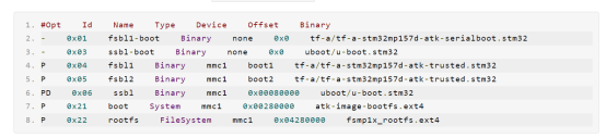

    Locate the flashlayout file "atk_emmc-stm32mp157d-atk-qt.tsv" in the accompanying package, and open it with a text editor. Edit the last line corresponding to the ext4 filesystem name for the rootfs, and modify it to "fsmp1x_rootfs.ext4" (copy this file to the destination).
    Table showing the system partition layout for STM32MP157.
    Copy this file to the destination

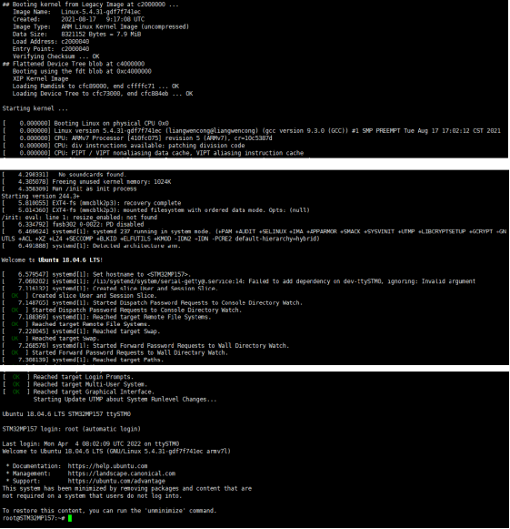

    Monitor the system startup status through the serial port. Here, capture three significant checkpoints: kernel boot, system boot, and successful startup.
    Linux boot screen on STM32MP157 Mini
    startup status

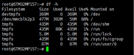

    By using the command "df -h" to observe the disk usage of file systems, it was discovered that the size of the root file system is only 477M, and it is already 88% full. This is due to the fact that the created ext4 empty file has a size of 500M.
    Screenshot showing the results of the df -h command on STM32MP157.

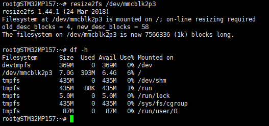

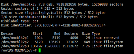

    Execute the command "fdisk -l" to display all partition information. At the end, you will find that the partition "/dev/mmcblk2p3" has a total capacity of 7.2GB.
    Terminal displaying disk partition information.
    Therefore, the resize2fs command should be used to adjust the size of the /dev/mmcblk2p3 partition. After the adjustment is complete, check again and you will find that the space of this partition has been fully utilized.
    Screenshot of terminal with filesystem commands
    Adjustment of the space

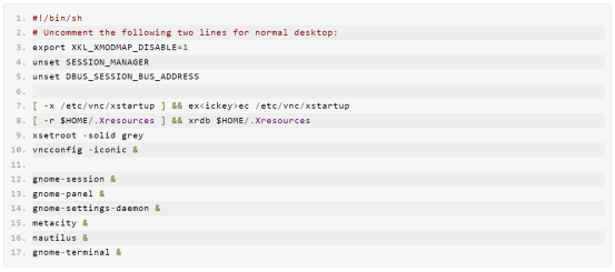

    Please refrain from starting the VNC server hastily, as connecting to it at this stage will only display a gray screen and an 'x' shaped cursor. First, proceed with installing xfonts.
    Fragment of documentation for installing xfonts on Ubuntu.
    Please proceed to delete the original content of the ~/.vnc/xstartup file and replace it with the following:
    Screenshot of VNC startup script.

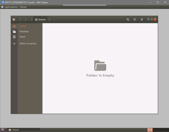

    To start, enter "vncserver". The first time you start it, you will be prompted to set a password. Then, use a VNC client to connect, making sure to add ":1" after the IP address. You can also use the "-geometry" option to specify the resolution.
    Screenshot showing a Linux desktop with an empty folder displayed in the file manager. \
    Enter "vncserver"

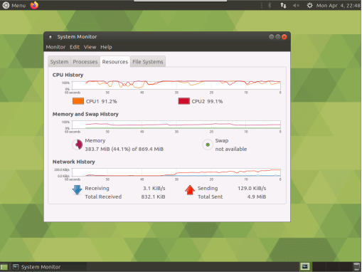

    3.Installing the MATE Desktop
    The aforementioned GNOME desktop is rather simplistic. To install the MATE desktop, please execute the following command. It should be noted that this process will require a minimum of 2GB of available space and may take a considerable amount of time.
    Command to install Ubuntu Mate using Linux terminal.
    After completing the installation, restart and reconnect using VNC. Wait for about ten seconds, and you will be able to see the Mate desktop. To be honest, it looks great, but one drawback is that when idle, this board can fully utilize its 800MHz CPU without doing anything.
    Screenshot of system monitor in MATE on STM32MP157 Mini
