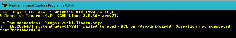

    I have a board with the RK3066 processor on which I installed the linux system, namely Linaro, downloaded from this website http://www.haoyuelectronics.com/service/RK3066/Images/ubuntu/
    I communicate via the UART interface connected to the laptop adapter. Here's what the system looks like right out of the box

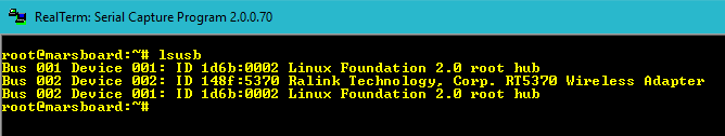

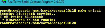

    Now to the point. The board has a RT5370 WiFi module on board. So I would like to be able to connect to wifi, but there is a problem, this system only has drivers for the 8188EU chip, which I don't have. However, the system detects the current module, because when I give the command "lsusb", I get
     Linux Linaro Installation: Connect RK3066 Board with RT5370 WiFi Module and UART Interface
    I found a tutorial on YT where someone installs wifi card drivers in Kali Linux. The guide at this link https://www.youtube.com/watch?v=n3EJk44MOU4
    Unfortunately, I cannot download the compat wireless 2010 package mentioned in the movie, because the website where the packages were located has been "rebuilt" and the packages themselves are now called backports. Here is the link to these packages
    https://www.kernel.org/pub/linux/kernel/projects/backports/stable/
    But going back in the catalog of these packages, you can see the "2012" catalog there. In it I chose the directory "09" and then "18". Now the list with "compat drivers" packages has appeared, so I have downloaded the "compat-drivers-2012-09-18-p.tar" package.

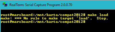

    I put it on the SD card, mounted the medium in the linux system and performed the next steps according to the movie.
    So, I unpacked the package (to the compat2012 folder), entered its folder with the command "cd" and ran the command "make unload".
    So far, it is kind of in line with what they showed in the film. Because in response I got
    The problem starts now because when I do "make load" I have a bug
    Does that mean the driver cannot be installed?

    There should be a Makefile in that folder. Send its content.

    Thank you for your interest in the topic.
    Here is the contents of the makefile

  • #4 16800734
    md37
    Posts: 73
    Rate: 9
    There is no "load" in the file, so this error pops up. Send the contents of /etc/apt/sources.list Do you have an Ethernet socket?

    Kamil 1 wrote:
    I have a board with the RK3066 processor,
    Kernel 3.0.36+ Sneaky Weasel is too old. Current versions of many programs will not work on it due to the lack of some new system functions (e.g. memfd).
    It is best to compile the latest stable kernel longterm from www.kernel.org.
    For a marsboard it shouldn't be difficult, at least the dts is ready.
    There is a WiFi driver in 4.x kernels:
    CONFIG_RT2800USB_RT53XX
    rt2800usb.c: {USB_DEVICE (0x148f, 0x5370)}

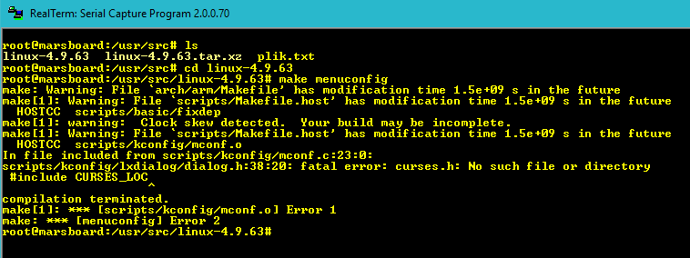

    I am trying to compile the kernel in the newest version, 4.9.63. I use this guide: http://www.linuxportal.pl/wpisy/prosta-kompilacja-jadra-id182976
    So I downloaded the kernel archive from https://www.kernel.org/, unpacked it, and placed it in the / usr / src / directory. Then I follow step 6 of this tutorial and that's where the problems start. I skip the "make clean" and "make mrproper" commands (I also executed them the first time, but it started to warn, so I uploaded a fresh system image and on the second attempt to replace the kernel I skipped these commands).
    The problem appears already with the command "cp / boot / config-`uname -r` ./.config" because I do not have any configuration file in the boot directory.
    And running "make menuconfig" only gives me this:

    Kamil 1 wrote:
    The problem appears already with the command "cp / boot / config-`uname -r` ./.config" ...
    The errors are caused by:
    1. libncurses5-dev package not installed
    2. it is necessary to set the date, e.g. date 20171120
    Then the initial configuration (due to missing config file):
    make multi_v7_defconfig
    and proper:
    make menuconfig
    kisses

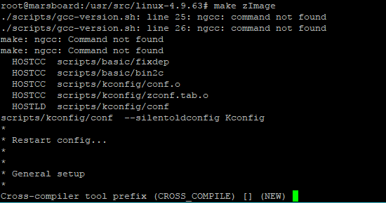

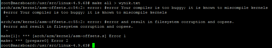

    Ok, success. Once again I uploaded a fresh system to this board and I did everything in order, including setting the time and installing the ncurses-5.9 package and this time it worked - after issuing the command "make menuconfig" this kernel configuration window appeared :)
    I have such a question now, my colleague PDT mentioned the preconfiguration with the command "make multi_v7_defconfig", resulting in a .config file
    If now in this kernel configuration window, I load this generated configuration using the "load" option, will I not have to modify this kernel? However, would it be appropriate to change something? If you do without modifications, it's better for me because I can spoil something :P
    Added after 27 [minutes]:

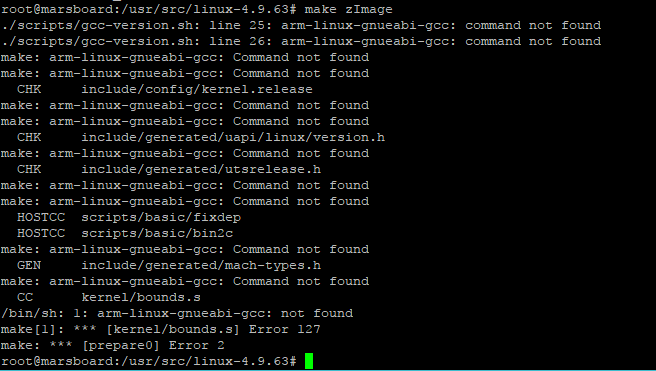

    I am trying to compile the kernel without modifying the kernel configuration.
    In some tutorial I read that you should give the command " make all "to compile the kernel. I do so too, except that I redirect the result of the compilation to the file" result.txt "- I think that it will speed up the process a bit because the processor takes care of the compilation itself and not an additional push of the entire compilation run through the terminal the physical UART) Unfortunately, an error appeared on the good morning ... here it is:
    Forgive me for not dealing with these errors myself, but I do not have such knowledge, unfortunately ...
  • Use marsboard_rk3066_sdcard_defconfig for kernel build
    #17 16846878
    PDT
    Posts: 511
    Help: 79
    Rate: 50
    I can see that you are making some progress and that for the first time there are also mistakes.
    NOTE: Many tips available on the net concern cross-compilation of the kernel (compile on PC and run on ARM). This is not the case.
    But shortly to the point, instead of make multi_v7_defconfig, you 'd better create a .config file with the contents:
    https://raw.githubusercontent.com/powermcu/ro...arm/configs/marsboard_rk3066_sdcard_defconfig
    This is the kernel 3.0.8+ configuration customized for this marsboard . Most of the settings have not changed.
    We compile with commands:
    make zImage fixed kernel, you need to copy it from arch / arm / boot / zImage to / boot (this is my case, the place depends on the loader)
    make modules loadable modules
    make modules_install install modules to target / lib / modules / ...

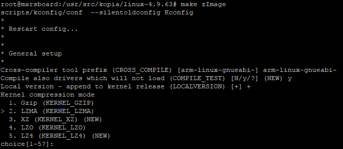

    However, if I create this .config file with this content from the link and no longer use the "make menuconfig" command, I just run "make zImage" immediately then I have some additional configuration process in the terminal which looks like this:
    The question is which method is correct?

    From kernel 3.0.8 to 4.xx a few options have been added / changed, the first way takes them to default values, usually good ones.
    These two lines need to be removed from .config, they are for cross-compiling:
    CONFIG_CROSS_COMPILE = "arm-linux-gnueabi-"
    CONFIG_LOCALVERSION = "+"
  • #20 16849940
