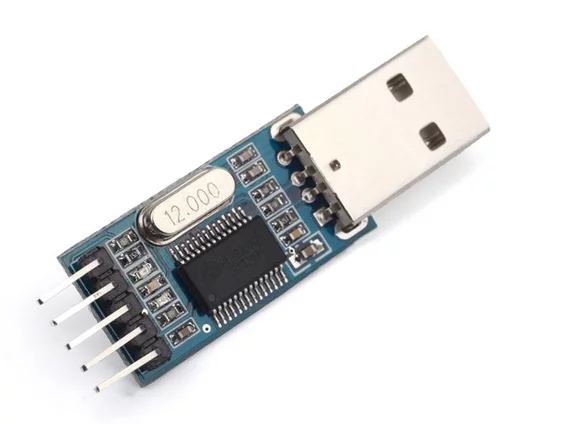

    In addition to the module itself, we also need a USB to UART TTL converter to upload the first program - bootloader - to the microcontroller's memory. An example converter is shown in the photo in the article. In principle, any converter will do.
    Finally, of course, we need cables to connect the controller to the module, but this is something that every Arduino enthusiast definitely has in his workshop.

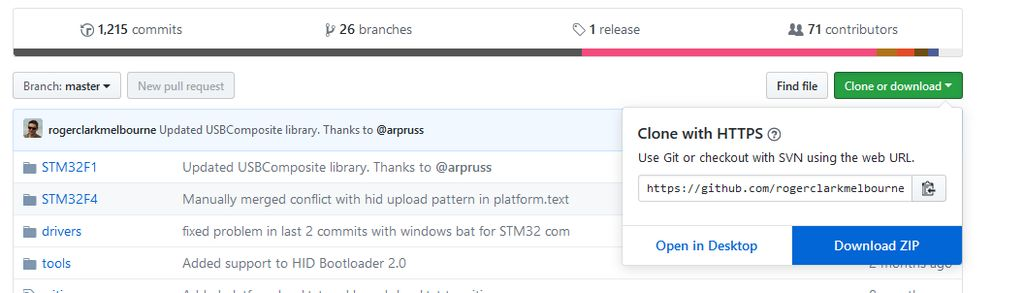

    Step 3: Drivers
    After connecting Blue Pill to the computer, Windows will not automatically detect this device, it is necessary to install drivers. It's also a very simple process. We start with downloading the drivers. They are located here .
    After entering the repository, press the green button "Clone or Download" and select "Download ZIP". After downloading it, download the package and copy it to the folder with the Arduino IDE. If we installed the software in the default location, we will find it in C: \ Program files (x86) \ Arduino. We find or create a folder under the name "hardware" and copy the file "Arduino_STM32-master" from the downloaded ZIP file there. Let's change its name to Arduino_STM32.
    At this stage, the software preparation is almost ready. There is only one more step ahead of us.

    We need to upload the bootloader. For this, we need two things - the program udo loading the firmware to STM32, which can be downloaded here (you need to register on the site and you will be able to download it) and the bootlader itself in binary form, which can be found in this repository . Select the file "generic_boot_pc13.bit" and simply download it.
    Now we have everything we need. We need to connect the USB-UART converter to Blue Pill and load it. The connections are very simple as described in the table:
    USB UART converter Blue Pill
    TX A10
    RX A9
    VCC 3.3 V
    mass GND
    We also set the highest jumper on the module with STM32 in the right position. We can now connect the converter to the USB port on the computer.

How do I wire the USB-UART adapter for first flashing?
Connect: 1. Converter TX → A10, 2. Converter RX → A9, 3. 3.3 V → VCC, 4. GND → GND. Move BOOT0 jumper to 1, reset, flash, then return BOOT0 to 0 [Elektroda, ghost666, post #17841316]

Blue Pill ships without a USB VID/PID; install the Maple DFU driver from Arduino_STM32/drivers/win, or use Zadig on Windows 10 [Elektroda, ghost666, post #17841316]
