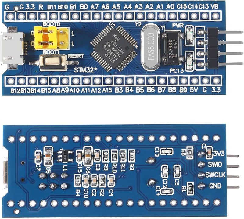

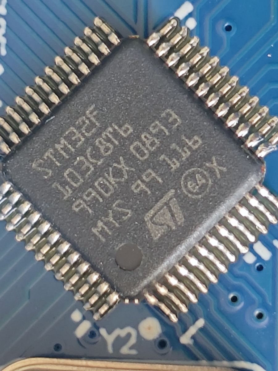

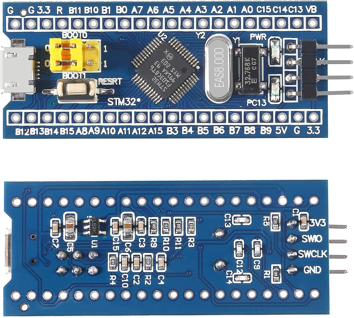

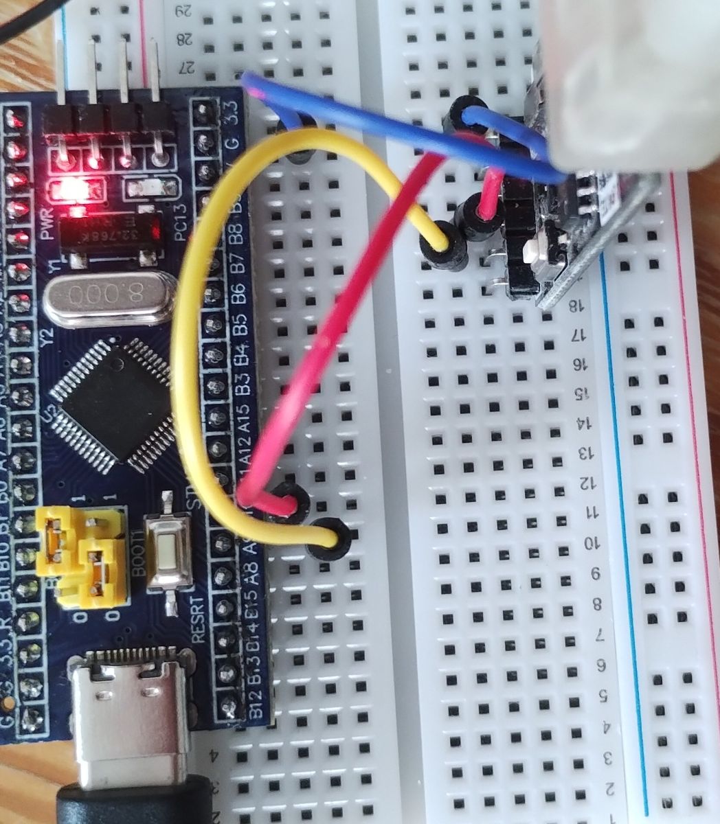

    Here I'll document my journey with a cheap STM32F103C8T6 "blue pill" dev/hobby board bought from Ali Express. Despite the IC labelled as "STM32F103C8T6" the internal flash appears to be 128k instead of 64k making it more like an STM32F103CBT6. It seems this is not unexpected with STM32 fakes/clones.
    The purpose of this purchase is to make a cheap C-SKY CK-Link / T-Head CPU debugger in the hope that I can access and dump the flash of C-SKY based chips like the WinnerMicro W800/W801/W806 which are C-SKY CK804FGT.
    Close-up of an STM32F103C8T6 microcontroller on a blue PCB, with visible chip markings and soldered pins.
    STM32F103C8T6 blue pill development board with microcontroller, pin headers, and micro USB port, shown from top and bottom views.
    I bought 3 from the YouKeyi Store https://www.aliexpress.com/item/1005006999051681.html

    Using cjacker's developments at https://github.com/cjacker/cklink-lite-fw-convertor we can convert the 'cklink_lite.hex' file that ships with the T-Head debug server so it will run on the STM32 after flashing. cjacker also supplies a binary that's already been converted https://github.com/cjacker/cklink-lite-fw-con.../blob/main/cklink_lite-2.36_for-stm32f103.hex and version 2.37, along with a Windows-compatible Python conversion script can be found in this PR https://github.com/cjacker/cklink-lite-fw-convertor/pull/1/files. I'll attach all files here for safe-keeping.

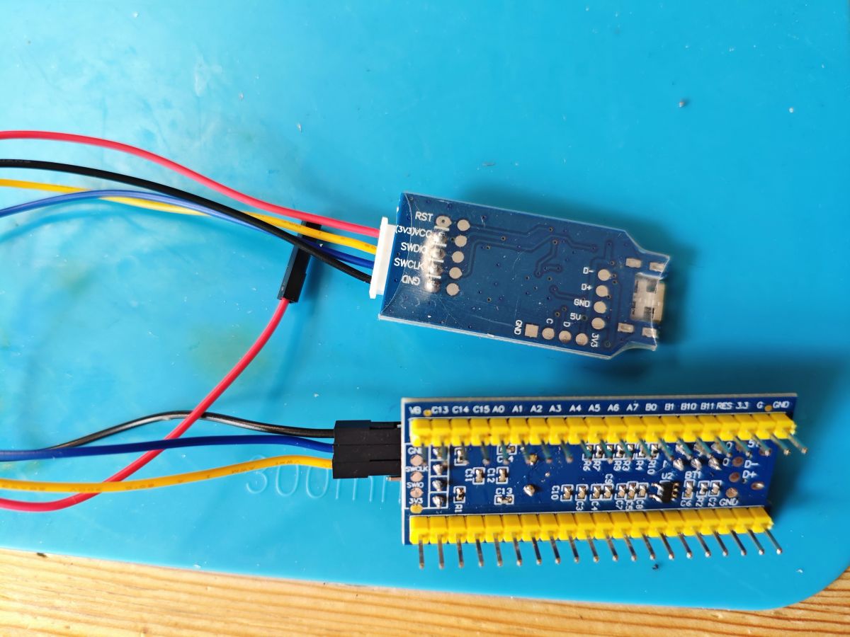

    But how do we program the STM32? SWD - Serial Wire Debug!
    Using one of these cheap clone J-Link programmer/debuggers we can flash the STM32 using J-Flash.
    Cheap J-link OB programmer/debugger board with wires, USB-C type, on an online shop page, promo price £1.99.
    J-Flash can be downloaded from https://www.segger.com/products/debug-probes/j-link/technology/flash-download/

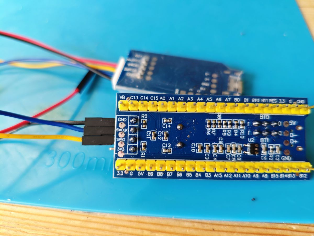

    Connect like so
    J-Link GND -> STM32 GND
    J-Link SWDIO -> STM32 SWIO
    J-Link SWCLK -> STM32 SWCLK
    J-Link 3V3/VCC - <disconnected>
    STM32F103C8T6 blue pill development board wired to another module on a blue electronics mat. J-Link programmer and STM32 blue pill board connected with jumper wires on a blue work mat.

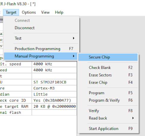

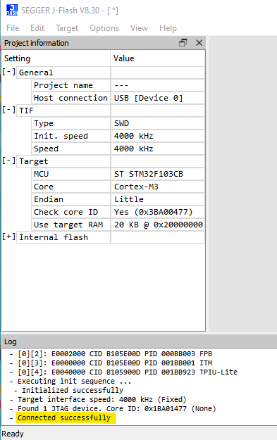

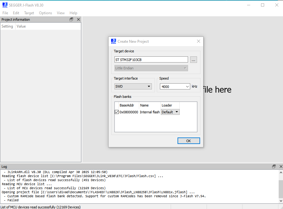

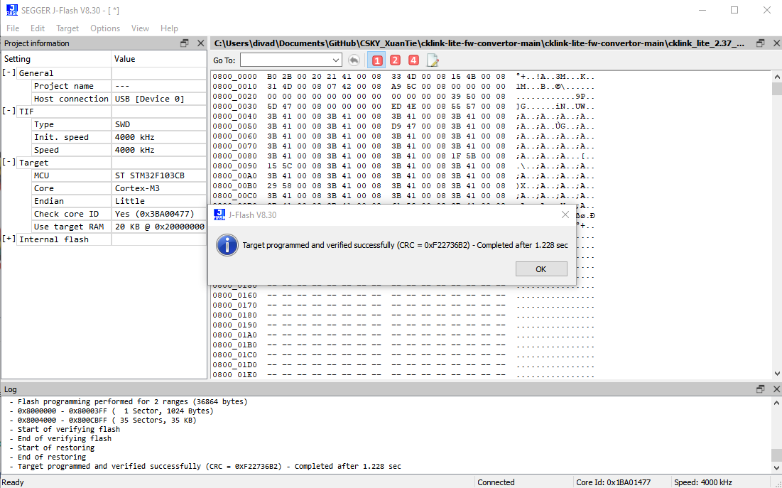

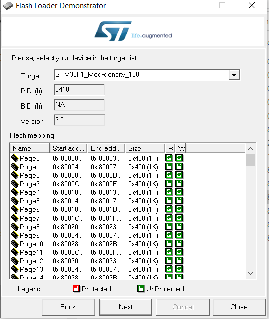

    run J-Flash, make a new project and select "STM32F103CB" (128kb) from the target device list
    SEGGER J-Flash program window creating a new project for STM32F103CB microcontroller.
    with both devices powered from their micro-USB ports 'Target' and 'Connect' in J-Flash menus should see the device connect successfully
    SEGGER J-Flash V8.30 window displaying project information and log, showing successful connection to an STM32F103CB microcontroller.
    Now you can erase/write or read entire chip from the Target-> Manual Programming menu. First I read the Keil USB memory stick emulator demo thing that shipped with the STM32.
    Screenshot of the J-Flash tool with the “Target” menu and “Manual Programming” submenu open.
    To flash cklink_lite-2.37_for-stm32f103.hex just drag the file into J-Flash window -> Erase Chip -> Program & Verify
    SEGGER J-Flash program window with a successful target programming and verification message displayed.

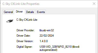

    Power off the STM32 and re-plug it. If using Windows it should be detected as a C-Sky CKLink-Lite device
    Properties window of C-Sky CKLink-Lite device showing driver details tab.

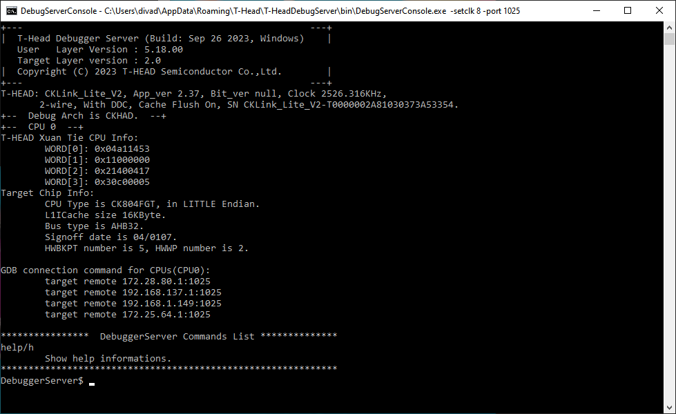

    Now that this is done we need to engage with the T-Head debugging server so we can interface with C-SKY-based devices.
    Register for and download the T-Head debug server from https://www.xrvm.cn/community/download?id=4380347564587814912 - I'll be demonstrating the Windows variant. I attach Windows and Linux downloads at the latest version at time of writing, as well as the debug user guide PDF.

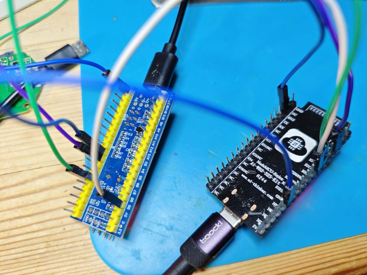

    The CPU I'll be connecting to is the CK804 in a Hi-Link HLK-W806-KIT dev board, the same as explained here https://github.com/cjacker/opensource-toolcha...your-own-ck-link-lite-debugger-with-stm32f103

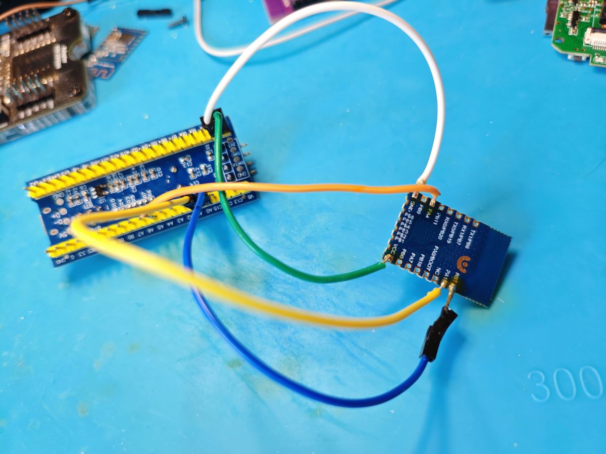

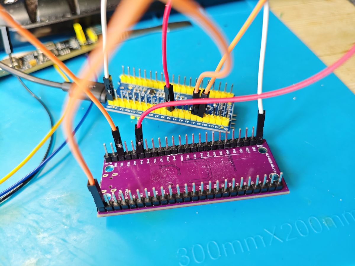

    STM32 is connected to the HLK like so
    Table comparing the pinout of STM32F103 microcontroller with XT-E804 module.
    Two electronic modules connected with wires on a blue work mat.

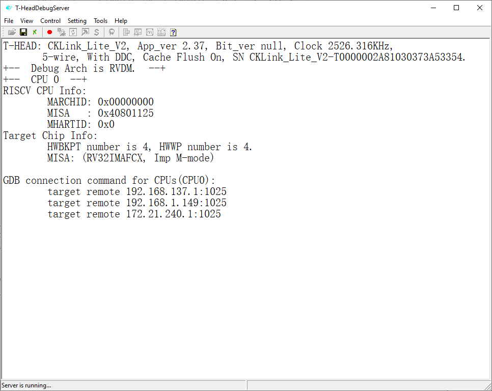

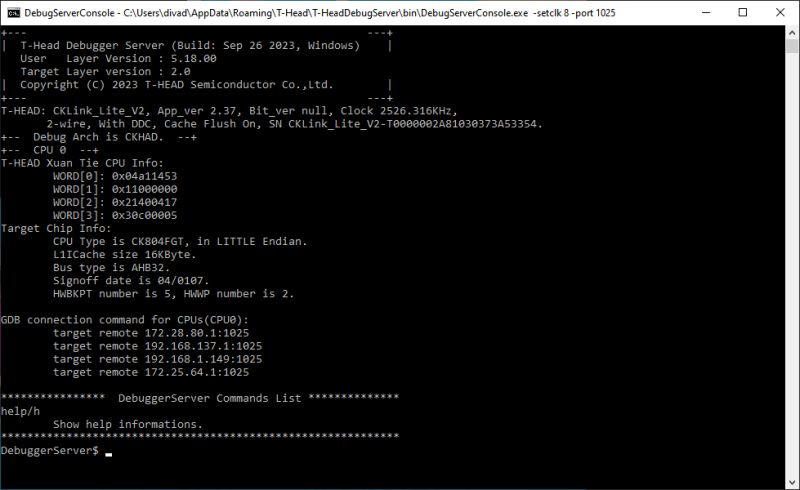

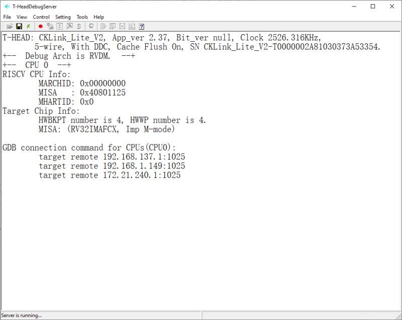

    With power to STM32 and the W806, running the DebugServerConsole app should put the CPU into debug mode and show information about the CK-Link firmware version and the W806 CPU
    DebugServerConsole window displaying T-HEAD Debugger Server and T-HEAD XuanTie CPU parameters.

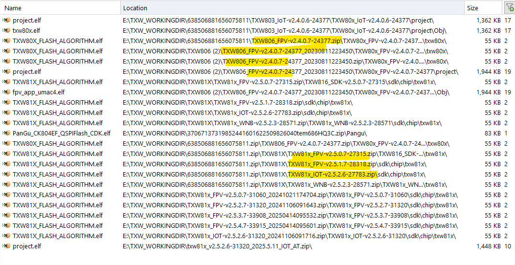

    Extract the attached w806.elf file and put it into the \bin folder alongside the debug console executable - C:\Users\xxxx\AppData\Roaming\T-Head\T-HeadDebugServer\bin if installed to default location
    Information about the elf file can be obtained with command flash -al w806.elf from the debug console
    DebuggerServer$ flash -al w806.elf

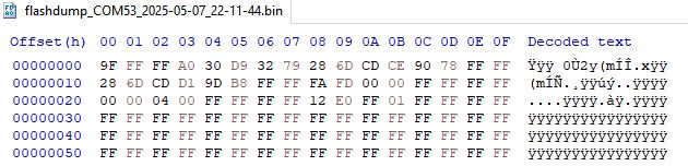

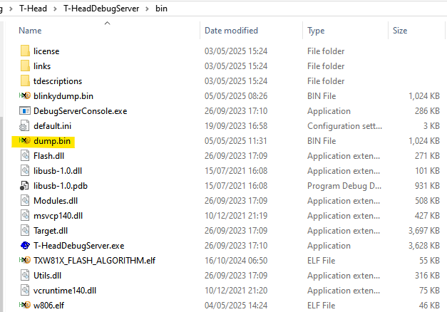

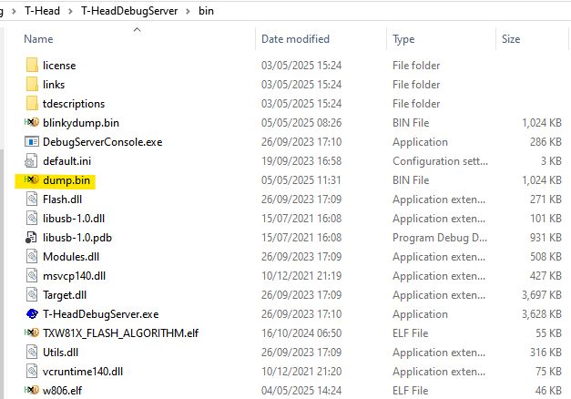

    The dump appears to work. 1mb took 56 seconds.
    The dump lands in \bin folder
    Screenshot of a Windows folder named bin showing various files and folders, including dump.bin.
    The resultant file appears to contain data and even some plain text from the W806 demo flashed using Upgrade Tools

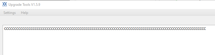

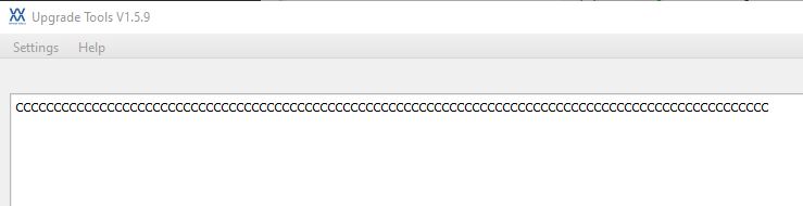

    Unfortunately flashing back as-is using command flash program -f blinkydump.bin -b -a 0x08000000 -al w806.elf does not appear to result in a bootable app, leaving the device waiting for an upload in the xmodem "CCCCCCCCCCC" mode
    Upgrade Tools V1.5.9 window with a long string of the letter c in the text field.

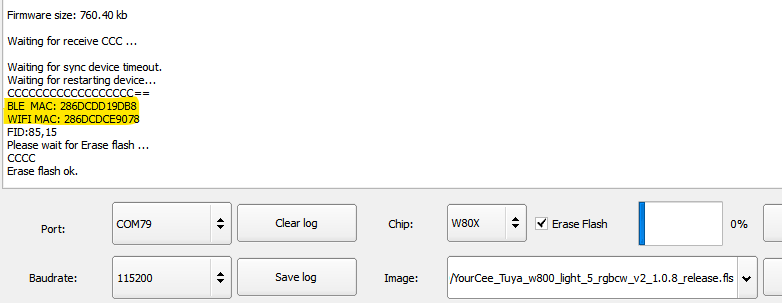

    A flashing tool window with process logs, showing BLE and WiFi MAC addresses, and a progress bar.
    These commands, and others, can be seen in various WinnerMicro documentation eg https://arduino.winnermicro.com/w800/en/2.3-beta.1/component_guides/rom.html

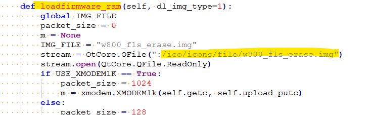

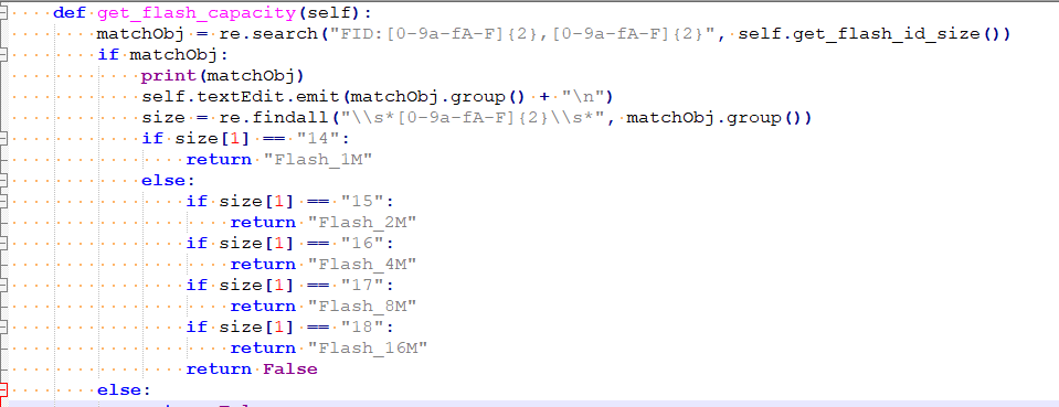

    We know the GUI doesn't offer a flash read option, but there might be something in the code to suggest this is possible.
    In SerialThread.py:
    Code: Python
    but how and what is needed to be running on the chip before these commands can be received and actioned?

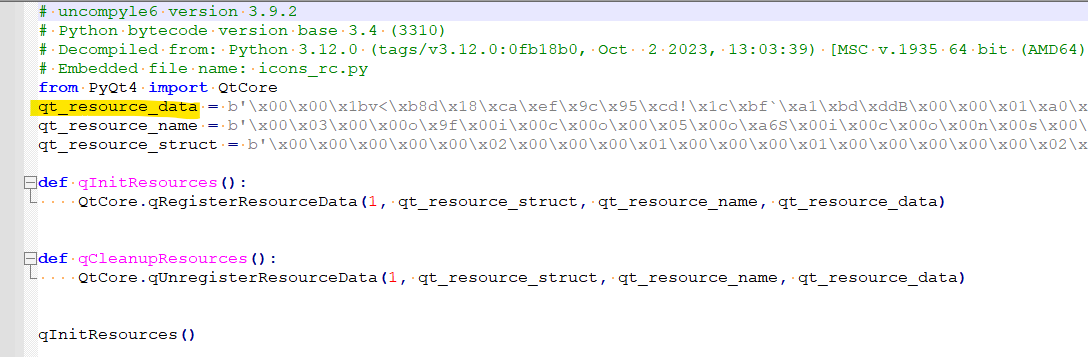

    Screenshot of a code editor showing a Python function loadfirmware_ram with a file path highlighted.

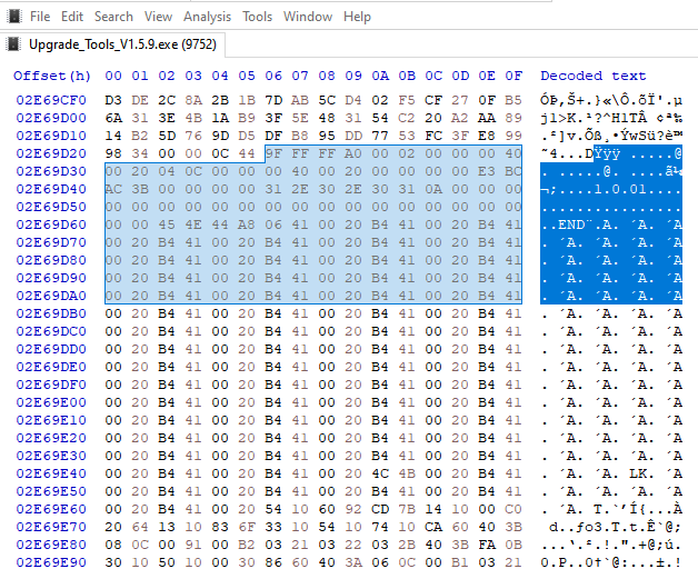

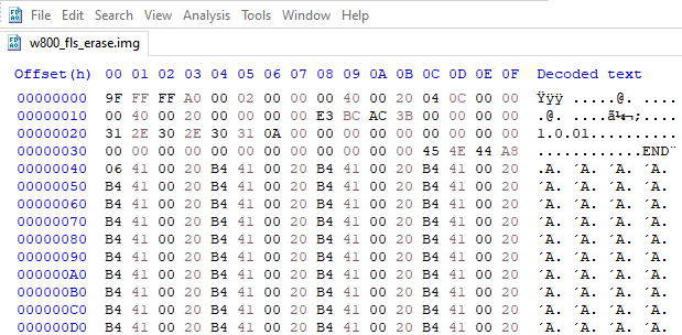

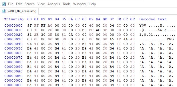

    there is no sign of w800_fls_erase.img in any of the extractions so far. Fast-forward several hours of trying things, it turns out to be some virtual path in some Qt resource. It's pieced together from this Python byte code string in icons_rc.py
    Screenshot of a decompiled Python code fragment with the “qt_resource_data” field highlighted.
    Confirming the extraction was sound took some working out.
    As it happens, you can also see the same code in HxD live memory viewer. Here's the start of the same data as from byte code extraction
    Screenshot of a hex editor with the file Upgrade_Tools_V1.5.9.exe open and a block of data highlighted.
    Screenshot of a hex editor with a binary file open, displaying hexadecimal and decoded text data.

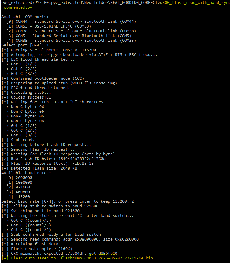

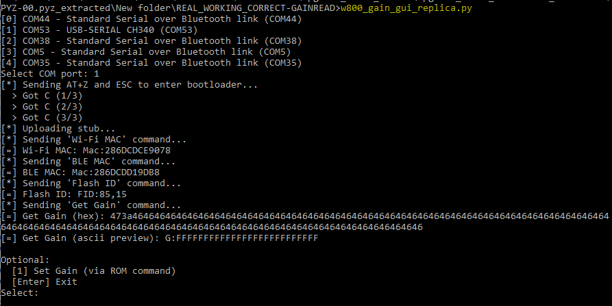

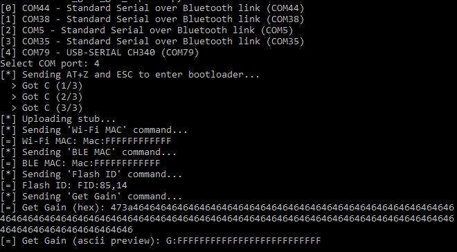

    Using SerialThread as a reference point GPT and I made some script to mimic resetting the device via AT+Z command and RTS, waiting for Xmodem CCC, uploading flash stub and sending commands. This script gets wifi mac, ble mac, flash ID and gain info from the device, it also asks which com port you want to use first.
    Terminal window running a Python script that reads data via serial port, displaying MAC IDs and Gain values in hexadecimal format.

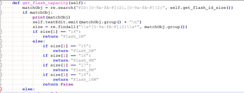

    Flash ID 85, 15 = manufacturer and size, so, Puya and 2mb.
    The official tool uses this to detect flash size
    A code snippet in Python that checks flash memory capacity based on an identifier.
    Script correctly detects 14 as the flash size on W806 - 1MB
    Screenshot of a console displaying COM port selection and serial communication with commands and responses from a bootloader.
    (wifi and ble macs are FF even in GUI flasher tool, so not worried about that)

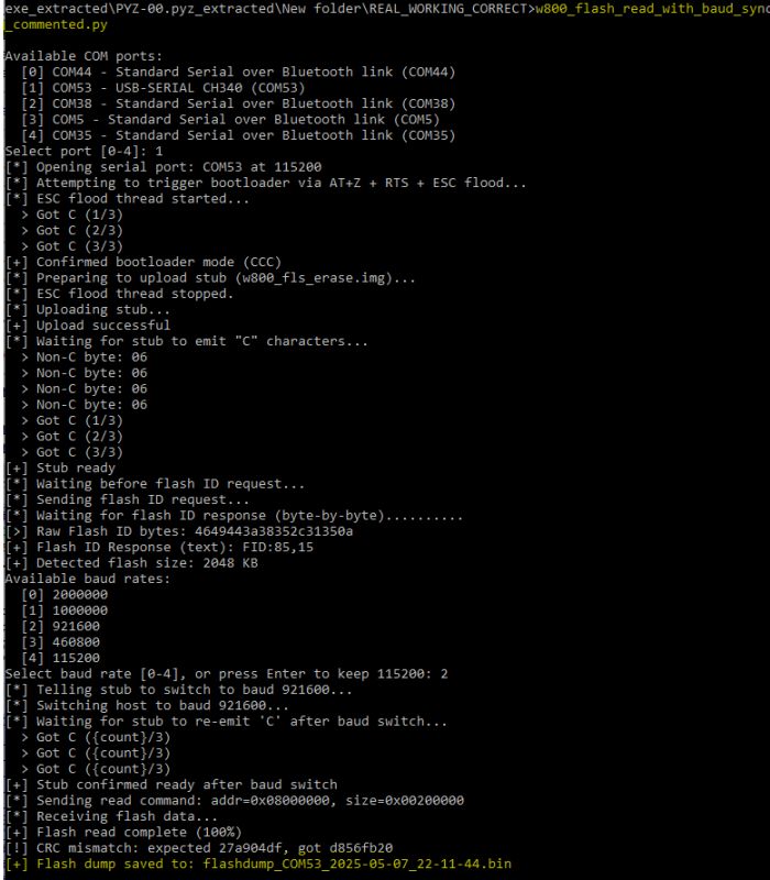

    what about adapting the flash read so the whole 2mb can be captured?
    Terminal displaying the process of reading flash memory from a device via serial port.

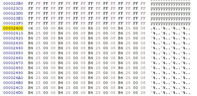

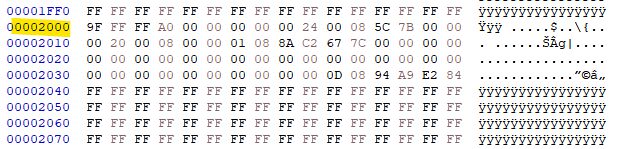

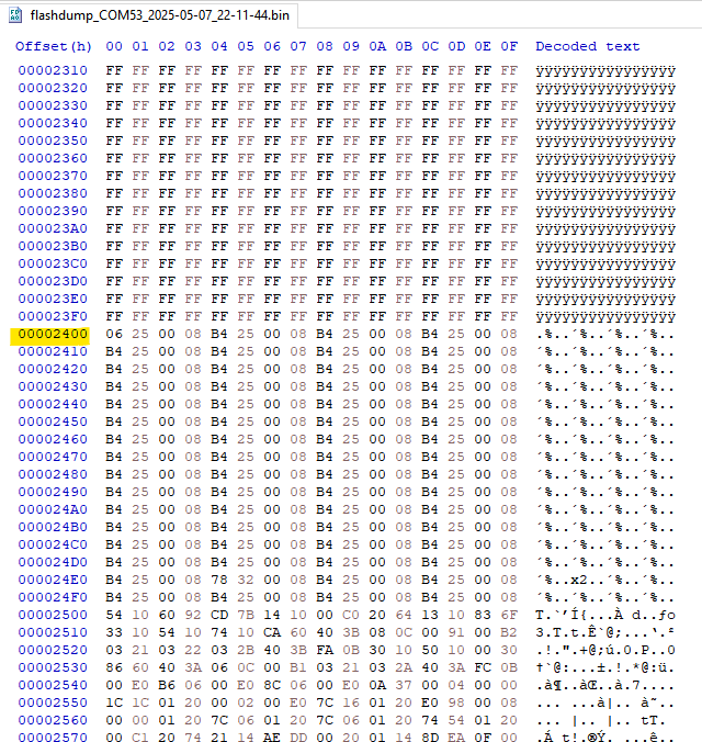

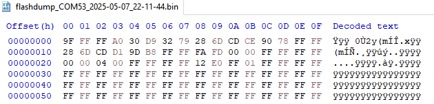

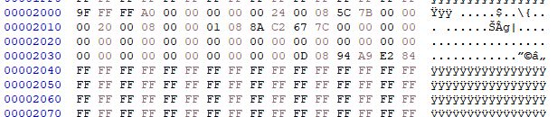

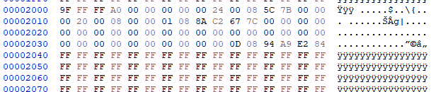

    in the dump we see data at 2400, the main image
    Screenshot of a hex editor showing the contents of a binary file, with hexadecimal addresses and data, as well as decoded text.

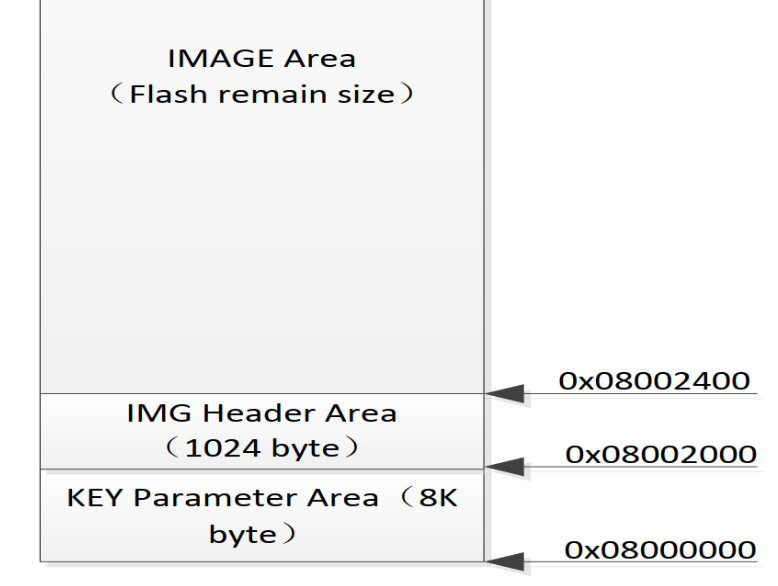

    and some other bits before that 0 and 2000
    Screenshot of a hex editor displaying binary data from a file.
    Diagram of flash memory layout showing key parameter, header, and image areas with addresses.
    Screenshot showing a section of a file opened in a hex editor.
    I've had quite a few variation of script and it seems timing and flushes are critical to a clean dump. Oftentimes without the right flush or pause the end or beginning of flash would contain Xmodem CCC.
    I also played with set gain a little, but I think this is in ROM so cannot be changed. My 3 boards return this though for the gain read

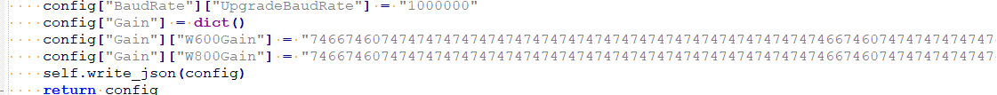

    In ConfigHelper.py we see a gain value for W600 and W800. I'm not sure why this is set or its effect. It does not appear to be persistent.
    A snippet of Python code with dictionary assignments and configuration saving.
    I think that's as far as I've got for now. I'll attach the scripts used in the screenshots (and more - some may not work), the stub and the py files. If anyone wants more let me know.

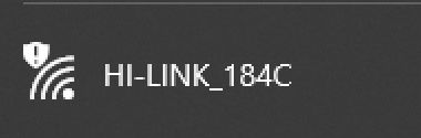

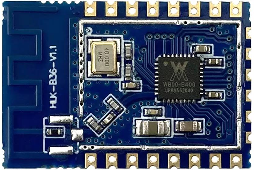

    I remembered I had a Hi-Link HLK-B36 - a W800 module - that I had not flashed OBK to. It still boots Hi-Link firmware
    HK-B36-V1.1 electronic module with W800-B800 chip and visible SMD components.
    and broadcasts AP "HI-LINK-184C"
    Wi-Fi network name HI-LINK_184C with signal and lock icon.

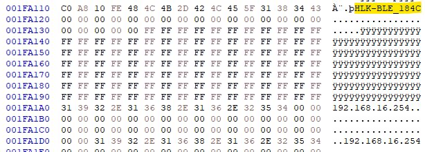

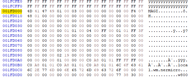

    Dump using w800_flash_read_crc_flush_double.py shows no captured CCCC whereas w800_flash_read.py does
    we clearly see data at the expected points in file
    Screenshot of a hex editor displaying hexadecimal and ASCII data. A section of a file in a hex editor, showing addresses, hex values, and corresponding ASCII characters.

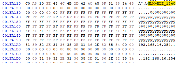

    A file fragment in a hex editor showing the ‘MAGI’ signature and ASCII text on the right.
    and signs of HLK
    A section of a hex editor with the text HLK-BLE_184C visible and IP addresses shown.

    and following the Bouffalo Lab part we can connect to BL602 MCU with the T-Head debug server too
    https://github.com/cjacker/opensource-toolchain-bouffalo-lab
    T-HeadDebugServer window displaying debugger connection and RISC-V CPU information.
    I am using BL602 Ai-Thinker NodeMCU Ai-WB2-32S-Kit
    Two electronic modules connected with wires on a blue mat.
    STM32F103 assignments for BL
    STM32F103FunctionBL602/BL604BL702/BL704/BL706BL616/BL618BL808
    A5TMSGPIO12GPIO0GPIO0GPIO6
    A1TCKGPIO14GPIO2GPIO1GPIO12
    A4TDOGPIO11GPIO9GPIO2GPIO7
    B9TDIGPIO17GPIO1GPIO3GPIO13
    This is maybe how you could fix your BL602 @p.kaczmarek2 if UART is not successful

    #6 21642427
    Harbour
    Anybody having the TXW8301 FLASH ALGORITHM ELF file ? Getting the error "ERROR: Current CPU is not in debug-mode, can't do any flash operations" while trying to dump the flash when using other elf files.
    P.S.
    The flash is SPI 16Mbit W25Q16JVSSIG
    The CPU inside TXW8301 is CK803SG:
    +--  Debug Arch is CKHAD.  --+
    +--  CPU 0  --+
    XuanTie CPU Info:
       WORD[0]: 0x04901053
       WORD[1]: 0x11000000
       WORD[2]: 0x21400417
       WORD[3]: 0x30c00000
    Target Chip Info:
       CPU Type is CK803SG, in LITTLE Endian.
       Bus type is AHB32.
       Signoff date is 04/0107.
       HWBKPT number is 9, HWWP number is 2.
  • Suggests wrong connection or ICE clock speed
    #7 21643082
    Posts: 5183
    Help: 445
    Rate: 912
    im not seeing any additional flash algorithm files in the TXW8301 SDK.
    Your error sounds more like a not connecting type of thing though rather than a flash read problem.
    looks like we have read CK803SG variant successfully here https://www.elektroda.com/rtvforum/topic4129331.html
    Maybe this is the kind of error you'd expect with wrong flash algo file?
    https://www.elektroda.com/rtvforum/topic4134923.html#21640179
    Have you tried lower ICE Clk speeds?
  • Missing TXW83X flash algorithm files confirmed
    #8 21643230
    Harbour
    divadiow wrote:
    I'm not seeing any additional flash algorithm files in the TXW8301 SDK.
    The TXW8301 SDK never contained flash algorithm files. These files were supplied with programmer. I see the files:
    Taixin_TXW80X_FLASH_ALGORITHM.elf
    Taixin_TXW81X_FLASH_ALGORITHM.elf
    WinnerMicro_W800_FLASH_ALGORITHM.elf
    WinnerMicro_W806_FLASH_ALGORITHM.elf
    But there are no TXW83X files present!
    This link is about TXW816 for which algorithm file is definitely present.
    Exactly as I have no TXW83X FLASH ALGORITHM file. This was the my question.
    Will try, but seems like Linux Debug server app just ignores ICE speed command line option and I do not use Windows.
    P.S. Tried with 12kHz
    XuanTie: CKLink_Lite_V2, App_ver 2.38, Bit_ver null, Clock 12.027KHz,
    The same error
  • TXW8301 SDK may contain the correct flash algorithm
    #9 21643295
    Posts: 5183
    Help: 445
    Rate: 912
    sure. The TXW80X and TX81X algorithm files were pulled from the SDKs for those platforms so I wondered if the TXW8301 SDK might also contain some specific to that platform
    List of ELF files and SDK paths for TXW806 and TXW81X in Windows File Explorer
    with reference to this error: https://obrazki.elektroda.pl/6958044300_1755725962_bigthumb.jpg
    anyway, I'm not sure what to suggest next regarding the TXW8301 and flash dump/programming.
  • Proper TXW83x flash algorithm required
    #10 21643718
    Harbour
    Okay, debug mode error gone just after connecting gdb to the debugserver. But new error appeared:
    DebuggerServer$ flash dump -o dump.bin -b -a 0x0 -s 0x1000000 -al Taixin_TXW81X_FLASH_ALGORITHM.elf
    ERROR: Load Flash Algorithm File: Failed to load algorithm to target.
    Can't run FlashAlgorithm to bkpt_label, restore destoryed registers and memory.
    Dump failed.
    Now is definitely clear that proper TXW83x elf file is needed.

    UART flashing STM32 via boot0 jumper and ST flasher
    #13 21695356
    max4elektroda
    Posts: 758
    Help: 49
    Rate: 189
    Maybe you allow for a short alternate approach (if it's there and I simply overlooked it, sorry).
    I didn't have a J-Link programmer at hand, so I tried with a simple UART (as done here).

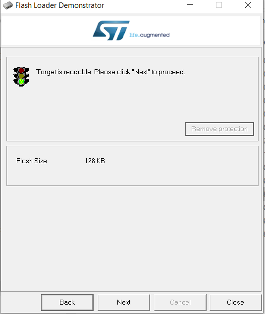

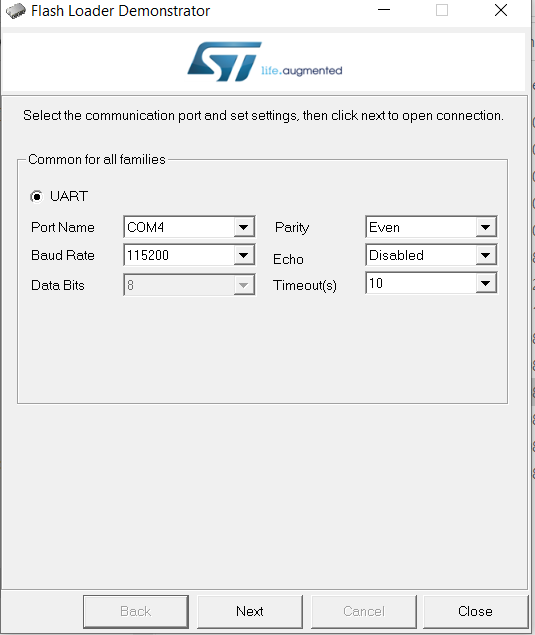

    Connect
    GND -> G
    UARTs RX -> A9
    UARTs TX -> A10
    Download Flasher from ST site https://www.st.com/en/development-tools/flasher-stm32.html#get-software (you'll need to get an access code with a valid mail address, mailinator.com works ;-))
    The process is straight forward, but you need to set the "Boot0" jumper (the one opposite to the button):
    STM32F103C8T6 Blue Pill as CK-Link Debugger: C-SKY/T-Head/XuanTie CK804 Flash Backup Investigations
    Flash Loader Demonstrator window showing readable target and flash size of 128 KB.

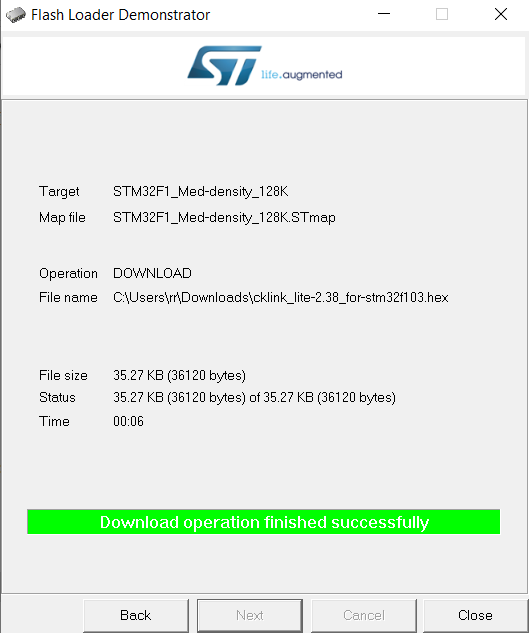

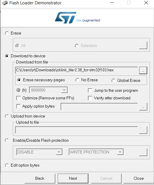

    Flash Loader Demonstrator window showing STM32F1 flash memory mapping.
    Flash Loader Demonstrator interface with selected .hex file download options.
    Screenshot of Flash Loader Demonstrator after successful STM32F1 firmware download
    Setting both "BOOT" jumpers to 0 again and re-connecting STM to USB:
    USB device list showing CKLink-Lite under USB devices
    Done!

✨ The discussion documents attempts to turn a cheap STM32F103C8T6 “Blue Pill” into a CK-Link / XuanTie debugger for accessing and dumping flash from C-SKY/T-Head targets such as WinnerMicro W800/W806 and other CK804/CK803-based chips. The author investigates converted CK-Link Lite firmware, reverse-engineers Upgrade_Tools flashing commands, and tests debug connectivity with BL602 and Bouffalo Lab targets. Later posts focus on TXW8301 flash dumping, missing TXW83x flash algorithm ELF files, debug-mode connection errors, ICE clock speed, and the need for a proper TXW83x ELF. A helpful workaround is then provided: flashing STM32 over UART with ST’s Flasher tool instead of requiring J-Link, which successfully dumps and programs devices such as X5 Cam and OpenTXW81X.
TL;DR: A $2–$4 STM32F103C8T6 “Blue Pill” can run CK-Link Lite to dump a CK804/W806 flash; a 1 MB dump took 56 seconds. “The dump appears to work.” [Elektroda, divadiow, post #21539711]
Why it matters: This FAQ helps makers and firmware analysts turn a Blue Pill into a budget C-SKY/T-Head/XuanTie debugger and reliably back up or inspect SPI flash on W80x/CK80x parts.
How do I turn a Blue Pill (STM32F103C8T6) into a CK-Link Lite debugger?
Flash a converted CK-Link Lite firmware onto the Blue Pill, then connect it to the target via SWD/JTAG. You can program the Blue Pill using ST’s Flasher over UART (set BOOT0=1), or use a J‑Link clone with J‑Flash selecting STM32F103CB. After power cycling, Windows will detect it as CKLink‑Lite, and T-Head DebugServerConsole will report firmware version on connect. [Elektroda, max4elektroda, post #21695356]
What pins do I wire between J-Link and the Blue Pill for SWD flashing?
Wire GND→GND, SWDIO→SWIO, and SWCLK→SWCLK. Leave the J‑Link 3V3/VCC disconnected because both boards power over their own USB ports. In J‑Flash, select STM32F103CB (128 KB) and use Target → Connect to confirm the link before erasing and programming the HEX. [Elektroda, divadiow, post #21539711]
