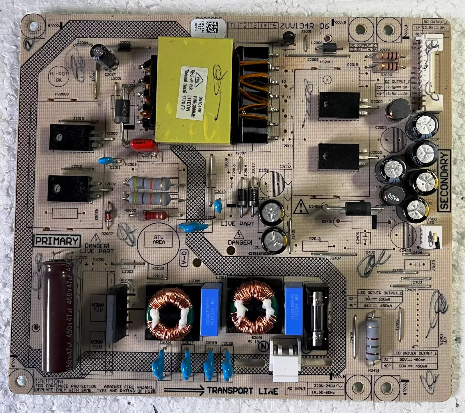

    Hello, I'm looking for a schematic of the power board ZUV 194R-06. It is from the Grundig VLE 5730 LED TV.
    Thanks

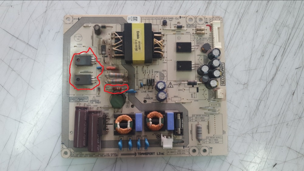

    Hello, the fuse was blown. Both MOSFETs were shorted, fusible resistor blown too, capacitor (101K 1KV) damaged. Replaced all and now the board is not shorted. Fuse is OK, but there is no 5V standby voltage.
    Marked parts that I've replaced.
    If you have any idea please let me know. I can post better photos of both sides..maybe it would be helpful....

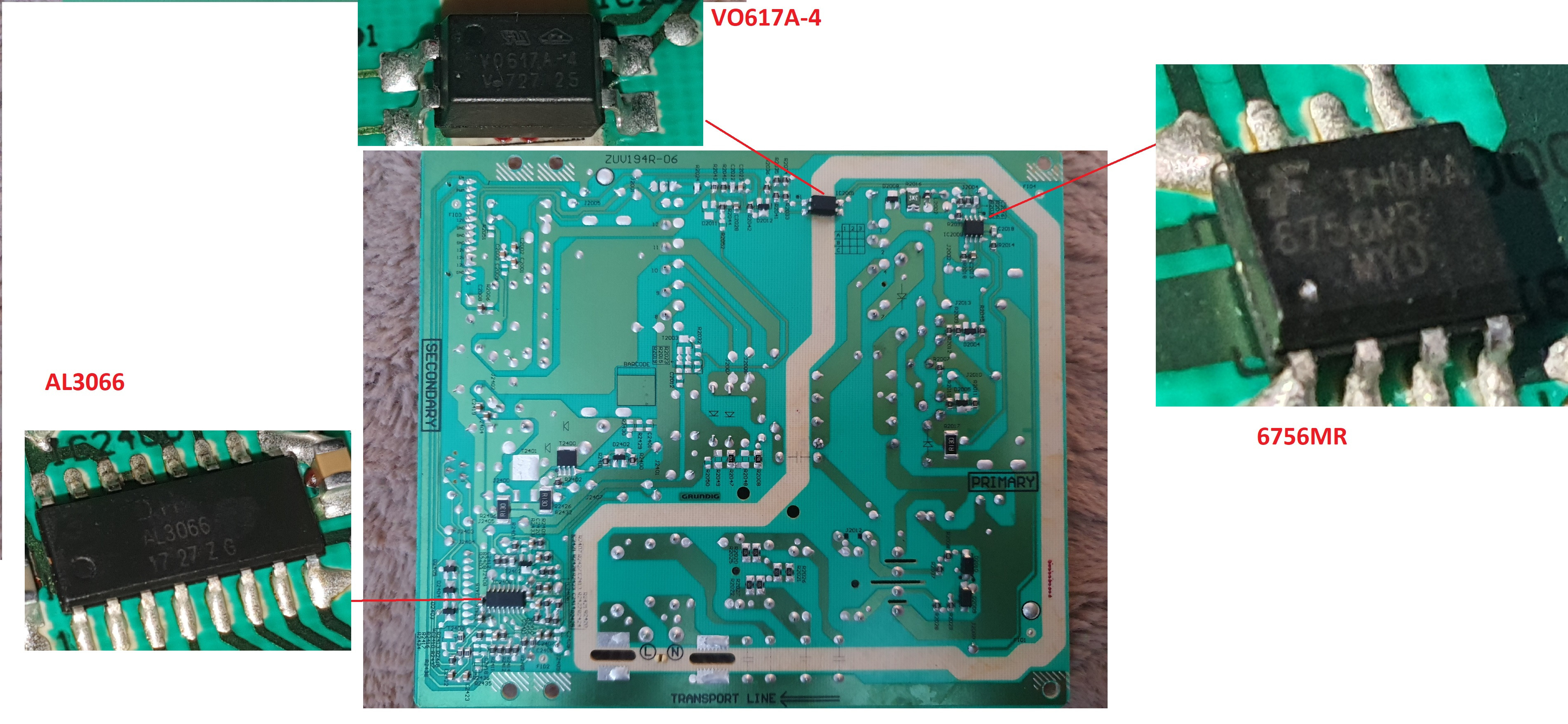

    I have only a basic knowledge about electronics and hope this attached photo with marked parts is helpful.
    If you have an idea what I need to test/replace please let me know.

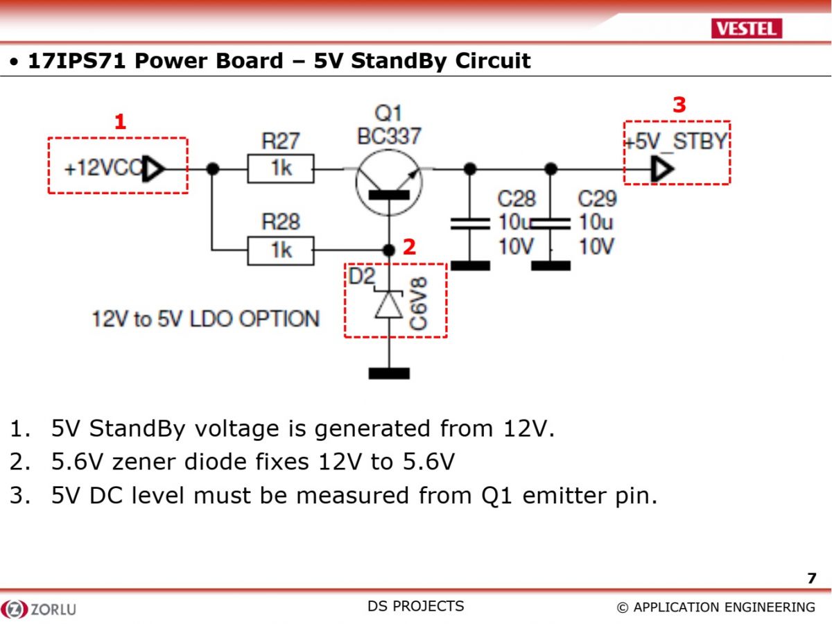

    no 5V standby / no 5V stby
    On pcb PSU not 5V stby , only +12V and GND and EN (enable)
    Grundig 40 VLE 5730 BN Power Board ZUV 194R-06 Schematic Needed
    Maybe you have such a solution stby +5V
    - it's from a different power supply model
    5V StandBy Circuit diagram on 17IPS71 board
