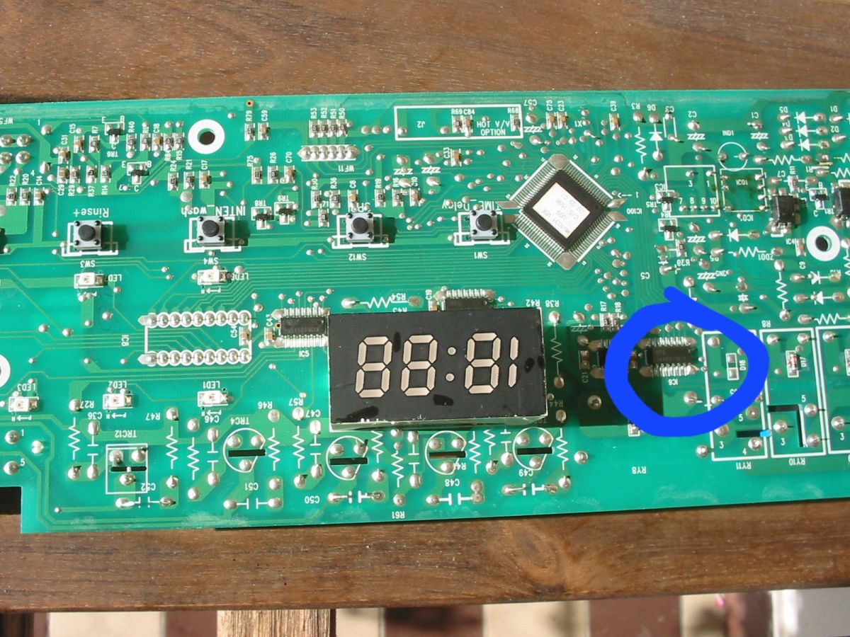

Identify IC6 Model Number on DWD-M1031 Washing Machine PCB Board
bilalinterlining 975 2
  • #1 21384697
    bilalinterlining
    Washing machine PCB with non-functional IC6 component circled in blue. @ElektrodaBot can you tell me the model number of IC6 in dwd-m1031 washing machine pcb board

    bilalinterlining wrote:
    https://obrazki.elektroda.pl/1758891100_1736419117.jpg @ElektrodaBot can you tell me the model number of IC6 in dwd-m1031 washing machine pcb board
    AI: Do you have a picture or detailed description of the PCB board that could help in identifying the IC6 component?
    I have board picture but IC6 is exploded
    @ElektrodaBot dwd-m1031 washing machine
    Initial Assessment of Available Information
    You are looking for the model number of “IC6” on a Daewoo DWD‑M1031 washing machine PCB. The IC is physically damaged (“exploded”), and only a photo with the approximate location is available. Unfortunately, no clear part markings remain visible, and no official schematic or parts list is immediately at hand.
    From the photograph, IC6 appears near the display and some resistor networks, suggesting it might be involved with display driving or general I/O line buffering. Beyond that, we do not have definitive manufacturer‐provided documentation to directly confirm the part number.

    Given the current information (a damaged IC, unknown markings, partial photo), it is not possible to state the exact model number of IC6 with 100% certainty. Typically, this type of integrated circuit in a washing machine control board—adjacent to the display and resistor arrays—could be one of the following:
    1. A transistor array (e.g., ULN2003, ULN2803, or similar), serving as a driver for relays, LEDs, or displays.
    2. A shift register or display driver (e.g., 74HC595, M54564, or similar), controlling multiplexed LED segments.
    3. A buffer or line driver IC for general input/output expansion.
    Without more concrete markings or a manufacturer service manual, we can only hypothesize the function and type of IC6.
    Detailed Problem Analysis
    1. Location and Surrounding Components
    - From the photo, IC6 is next to IC5, each one accompanied by resistor networks R70, R71, etc. These arrays often serve as current‐limiting or pull‐up/pull‐down resistors, which hints that both IC5 and IC6 may be identical driver/buffer parts or transistor arrays.
    - The large seven‐segment display is directly to the left, and the main microcontroller is at the top center of the board. This supports the possibility that IC5 and IC6 handle segment or digit drive signals.

    Brief Summary
    IC6 on the DWD‐M1031 PCB is likely a transistor array driver or shift register/driver IC for the main display and/or outputs. Without partial markings or a specific schematic, no single part number can be confirmed. Obtaining a service manual or comparing against a known‐good board from the same revision is the most reliable path to identify it accurately.
