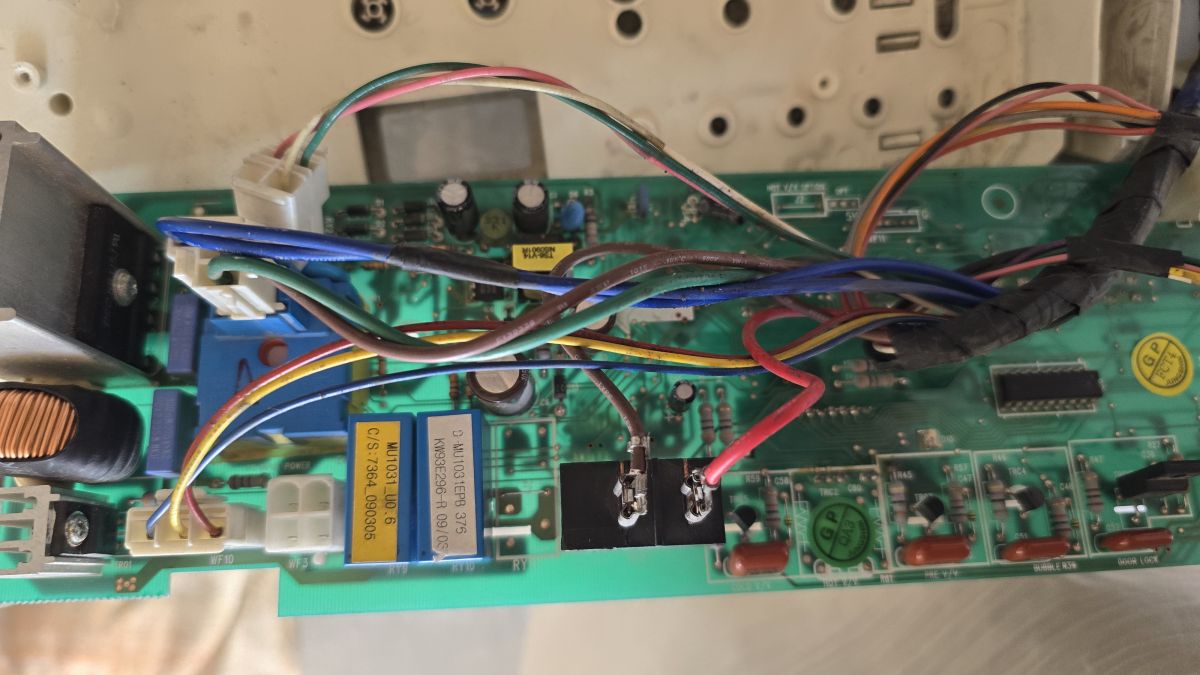

The two relays blue color is for motor or what and if any one knows it specifications

    Electronic board with colorful wires and relays in Daewoo DWD-M1031 washing machine
    AI: Do you know the brand or model of the relays or the device they are part of?
    It's in Daewoo washing machine DWD-M1031

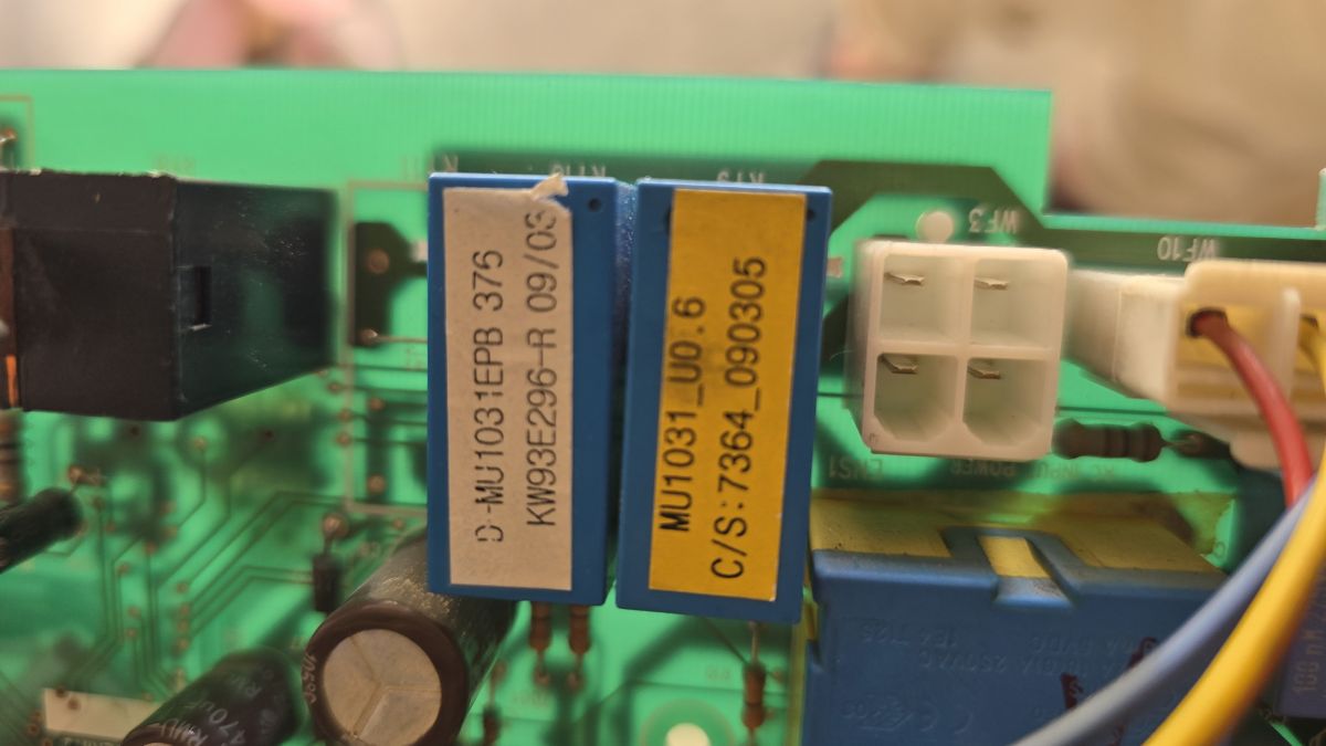

    Close-up of relays on a green PCB in a Daewoo DWD-M1031 washing machine. The relays have white and yellow labels with markings. trodaBot @ElektrodaBot
    Information about these relays

    bilalinterlining wrote:
    https://obrazki.elektroda.pl/7810772800_1737786071.jpg

    You’ve provided images of the control board from a Daewoo DWD‑M1031 washing machine, showing two relays labeled:
    • MU1031_U0_6 (C/S: 7364_090305)
    • D‑MU1031EPB 375 (KW93E296‑R 09/03)
    These part markings, especially the “MU1031” references, appear to be custom or OEM (Original Equipment Manufacturer) labels rather than standard relay brand/model numbers typically seen from major relay manufacturers (e.g., Omron, TE, Panasonic). Daewoo may contract a relay manufacturer to produce relays printed with a specific house part number.
    Below is a direct answer to your question, followed by a detailed breakdown and some suggestions for further research.
    Direct answer to the question
    It is difficult to confirm a universally recognized “brand or model” for these relays beyond the custom-labeled part markings shown. They appear to be Daewoo‑specific (or a specially contracted relay manufacturer) using internal part codes:
    • MU1031_U0_6
    • MU1031EPB 375
    These do not match common off-the-shelf relay part numbers. To identify suitable replacements, you would need the electrical specifications—particularly coil voltage, contact ratings (amperage/voltage), and mechanical footprint/pin configuration. This information may be found in:

    Because Daewoo frequently assigns their own part labeling, the best approach is to consult a service manual or measure coil impedance/voltage on the existing relays to deduce the coil specifications, then read the contact ratings on the relay’s label or in the circuit diagram. If no direct brand reference is given, you can attempt to cross-reference these requirements against general-purpose appliance relays from Omni, Song Chuan, TE Connectivity, etc.

    1. Visual inspection: Look for any rating data on the relay’s top or side. Sometimes, the contact rating is faintly stamped.
    2. Service manuals: Obtain the Daewoo DWD‑M1031 service manual from resources (e.g., Elektrotanya).
    3. Measure coil voltage: If you have a safe way to measure the machine while operating, check the coil supply line from the PCB (often clearer in the schematic).
    4. Replacement: If direct OEM relays are unavailable, select a known brand relay with the same coil specs (DC voltage and coil power), contact arrangement (SPST, SPDT), contact rating (Amp/Volt), and PCB footprint dimensions.

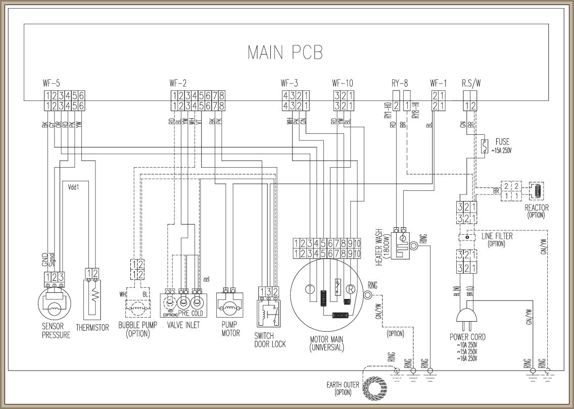

    Link to SM ==> Link , and underneath the stickers or on one side of the relay is probably a description of it (give a photo) :) .
    Wiring diagram of the main printed circuit board (PCB) with electrical component labels. .
