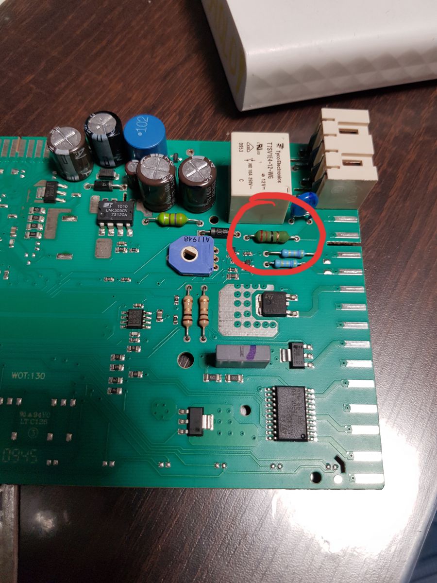

    Good morning :)
    Gentlemen, save me, I am looking for a person who has a diagram or a photo of the UCB-IC-RED-FD or UCB-IC-RED-P7 module / programmer
    Four resistors are burned and the numbers are "burned".
    Pictures in the attachment.
    Regards!!

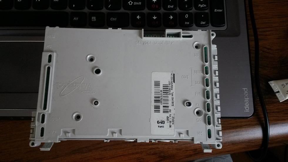

    I searched my resources because I have a lot of similar modules but I did not find an identical one. If you uploaded a photo of the housing with the plugs marked (so that you know what's in there), I can take photos of similar modules from similar dishwashers and I think it should help.
  • #3 14944114
    owik115
    I am sending photos. Regards

  • #6 14963472
    Patryk L
    Posts: 240
    Help: 16
    Rate: 79
    Hello ! So, looking at the photo from the left, the marking resistors 103, 102, 470, 470

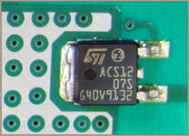

    Hello. I am having trouble identifying one item on this board.
    I attach a picture.
    Please :D :arrow: Link ACS120-7ST
