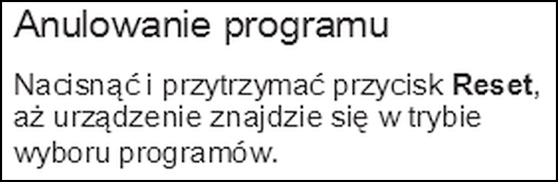

    And it was?
    Program cancellation instructions with Reset button description.
    Programme cancellation
    Press and hold the Reset button,
    until the device is in the
    programme selection mode.
