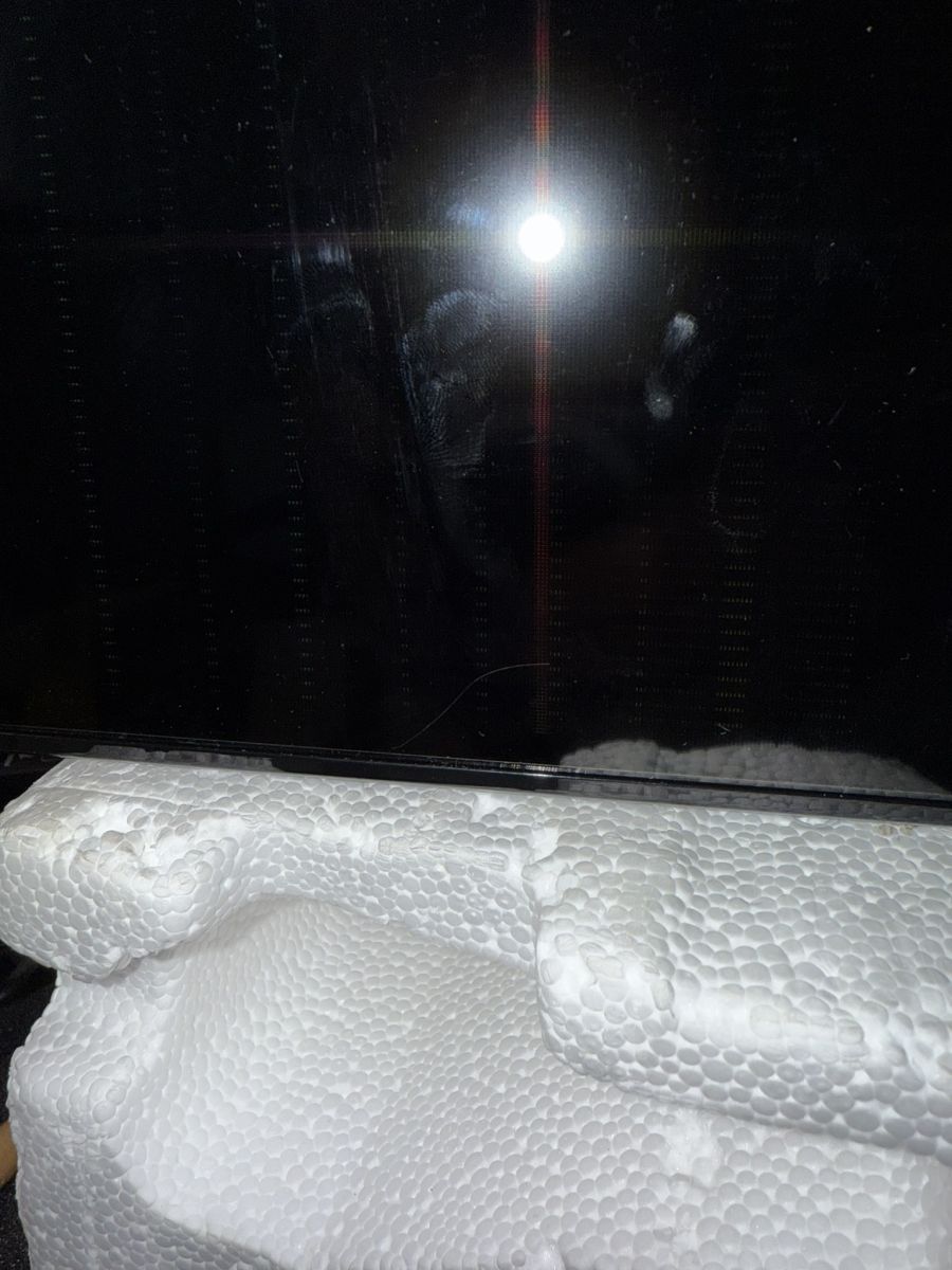

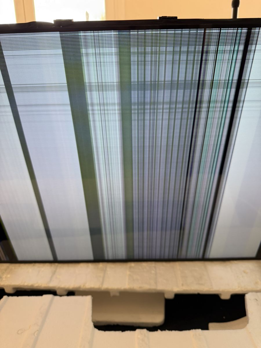

    I have a TV BLAUKPUNKT 43" MODEL: BA43F4142LB and there are horizontal and vertical lines on the panel.
    I take measurements of VGL -VGH -VIN up to T-BOARD and it's ok. Could you help me, please?
    I just checked the panel and I noticed that it has scratches. What do you think ?

    Damage to the matrix. Repair by replacing it, which is not economically justified.

    Purtroppo il pannello è andato, danni ai buffer matrice, forse potrebbe essere entrata acqua per pulizia pannello.
