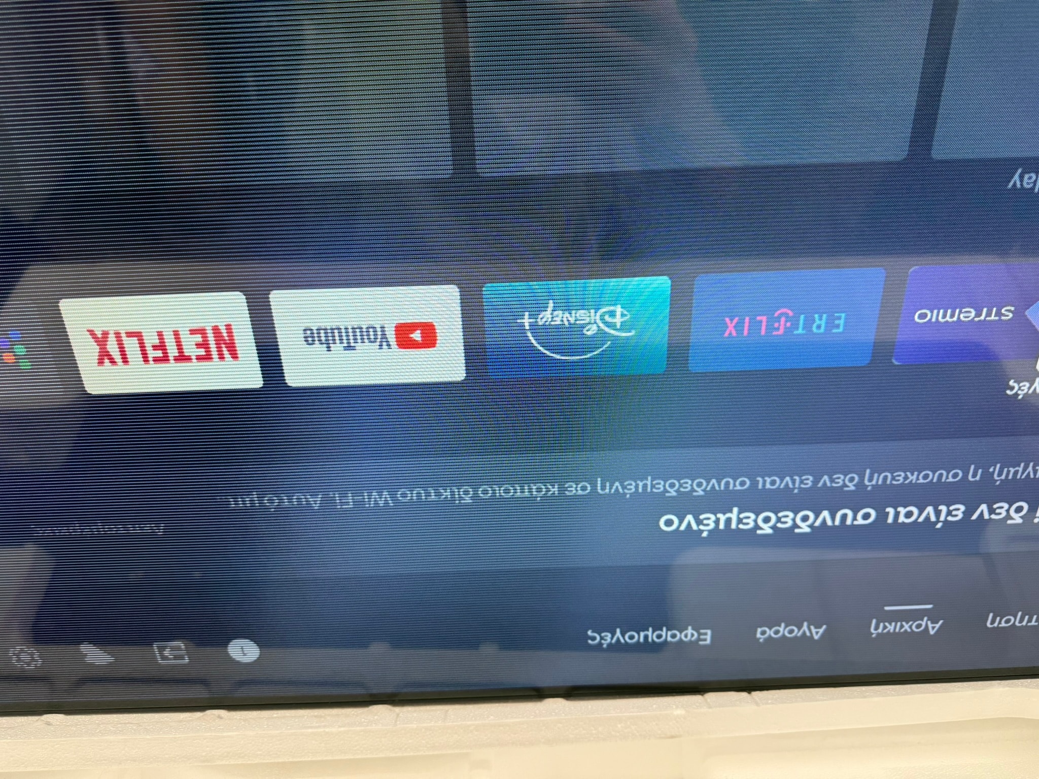

    Good evening my friends,
    I have a TV 43" of BLAUPUNKT MODEL: BA43F4142LEB.
    It has vertical lines on LCD. The left panel is off while only with right panel it plays normal.
    Which lines I have to cut off on COF-BOARD to play normal?

    Rate: 40
    Try it with CK signals, but don't cut, just try to tape on the TCON.

    Rate: 40
    On the left side of the tcon you have pads CK1-CK4 measure with a meter which tracks are responsible for these signals on the right side of the tcon and using the test method tape the connections to the matrix with thin tape , it is difficult to say which pin to disconnect you must try .

    Posts: 45
    >>21648880 I did it. Now it's playing normally but have some lines yet. Look the image below.

    Rate: 2366
    A colleague is aware that this is not working in the long run and additional wonders may come out in the image after time.
    What type of matrix is it?
    For yourself it's ok, but for sale, oh, not nice....
    I understand that the future customer will be informed of the damaged matrix.
