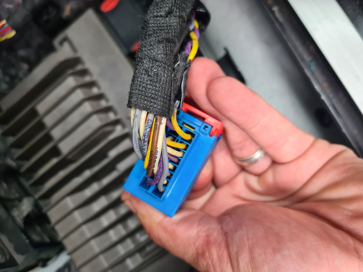

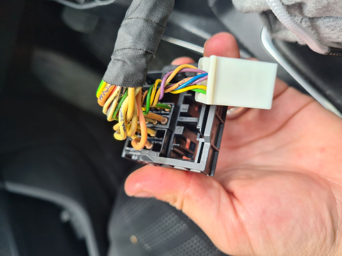

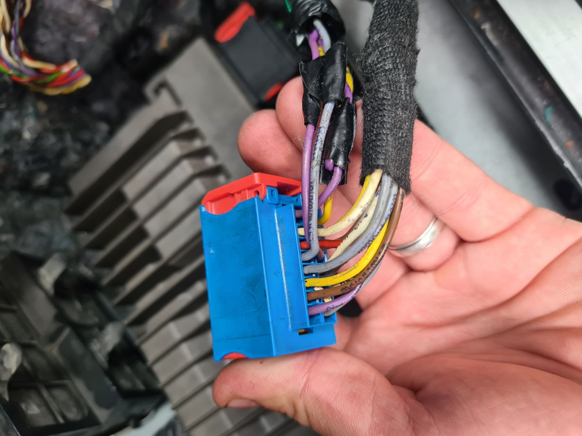

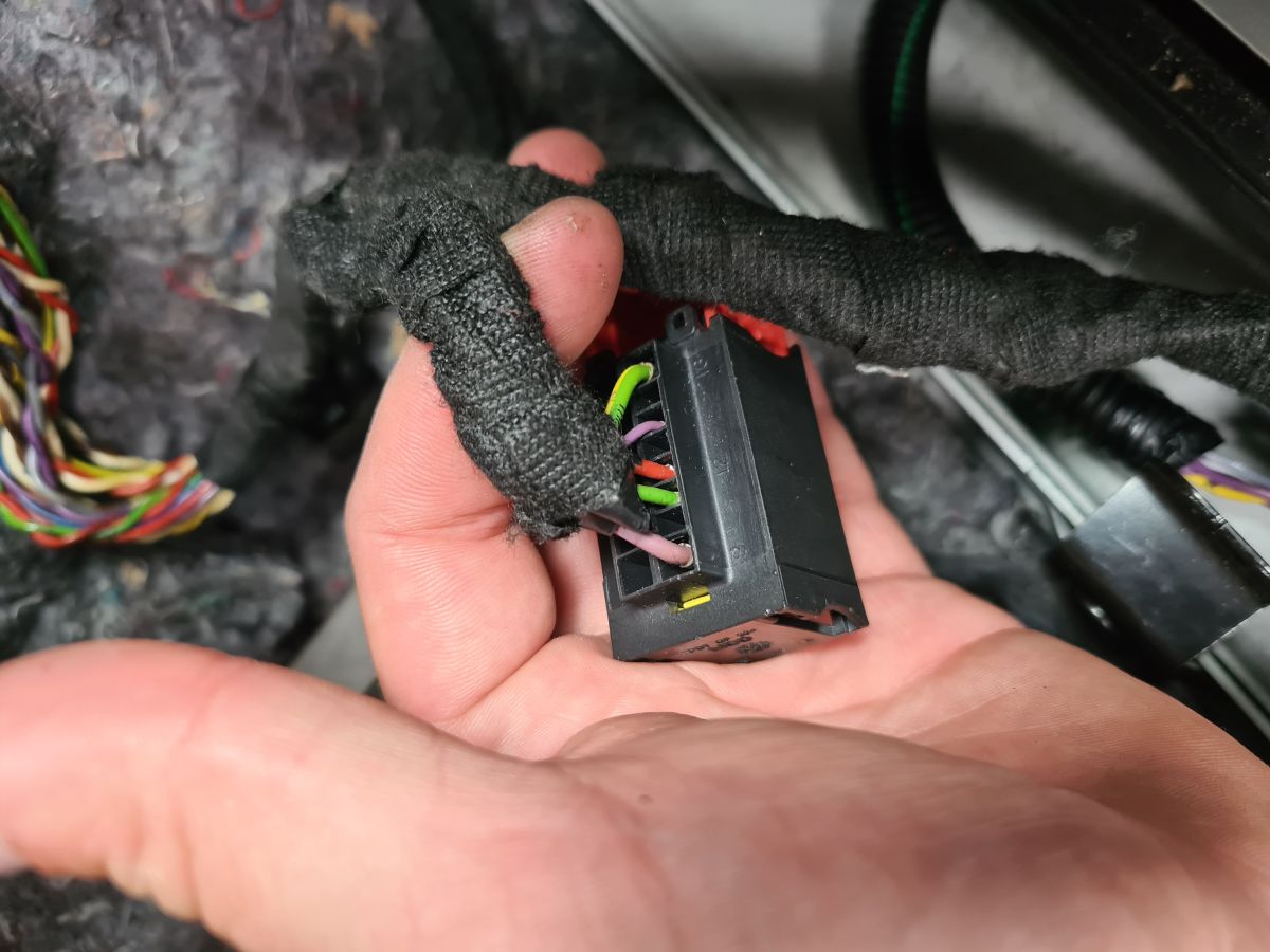

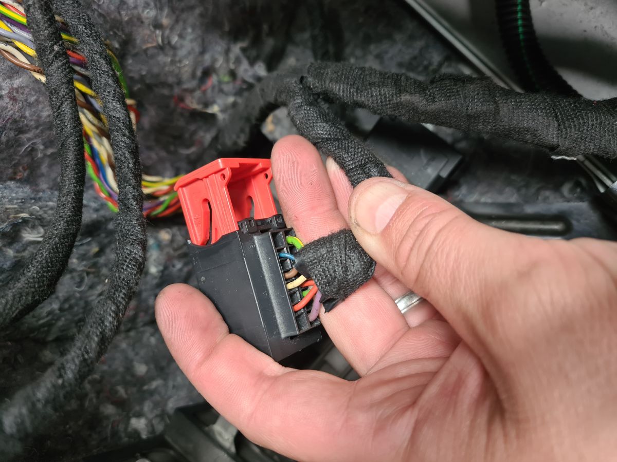

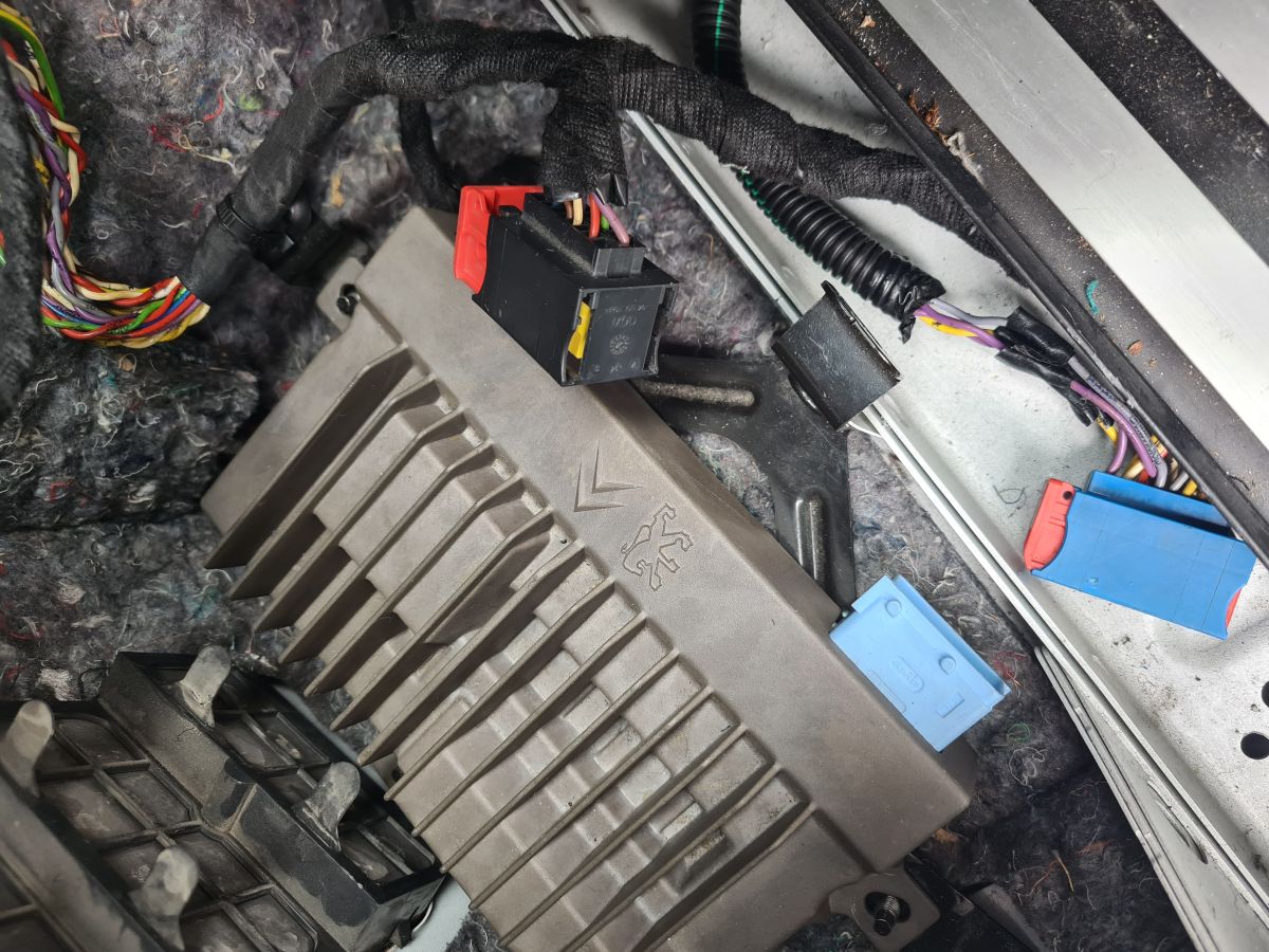

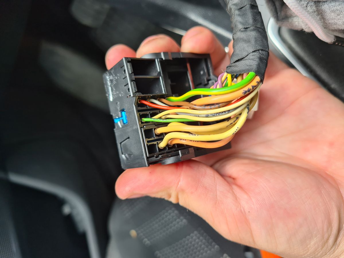

    Hello, i have a problem with my Peugeot 308 T9 year 2015 2.0 automatic. I buyed this car and seller tricked me saying he will repair sound but he didnt. It would be easy fix if the car has standard speakers but on this model i have Denon sound system with 8 channel Amplifier in the boot and subwoofer. I tried rebooting SMEG + unit, factory setting, disconnecting the battery and nothing worked. I noticed on the back of SMEG unit there is no cables in outputs of both rear speakers as you can see in the image. Did anyone had similiar problem or can someone help me resolve this one i would be gratefull.
    P.S diagnostic say there is a problem with radio outputs.

    AI: Do any of the speakers (front, rear, or subwoofer) produce any sound at all, or is there no sound from any speaker in the car?
    No sound at all
    AI: Is the Denon amplifier in the boot receiving power (e.g., any lights or signs of activity), and have you checked its connections for any visible issues?
    I cannot see that it is working it does not have any lights on itself
    Rear speakers are wired through the amplifier

    osmic260 wrote:
    I have noticed that on the back of the SMEG unit there are no cables in the outputs of both rear speakers, as shown in the photo. Has anyone had a similar problem or can anyone help me solve this problem, I would be grateful.
    This is the way it is supposed to be, with the radio+amplifier configuration the speakers are plugged into the amplifier and only the "front" channels go to it from the radio.
  • #3 21554856
    osmic260
    >>21554737 so it means the problem can be in Amplifier and I should change it ??
  • #4 21569329
    przemyslawgilejko
    Go to an ASO and it's standard, they have to upload new software.
