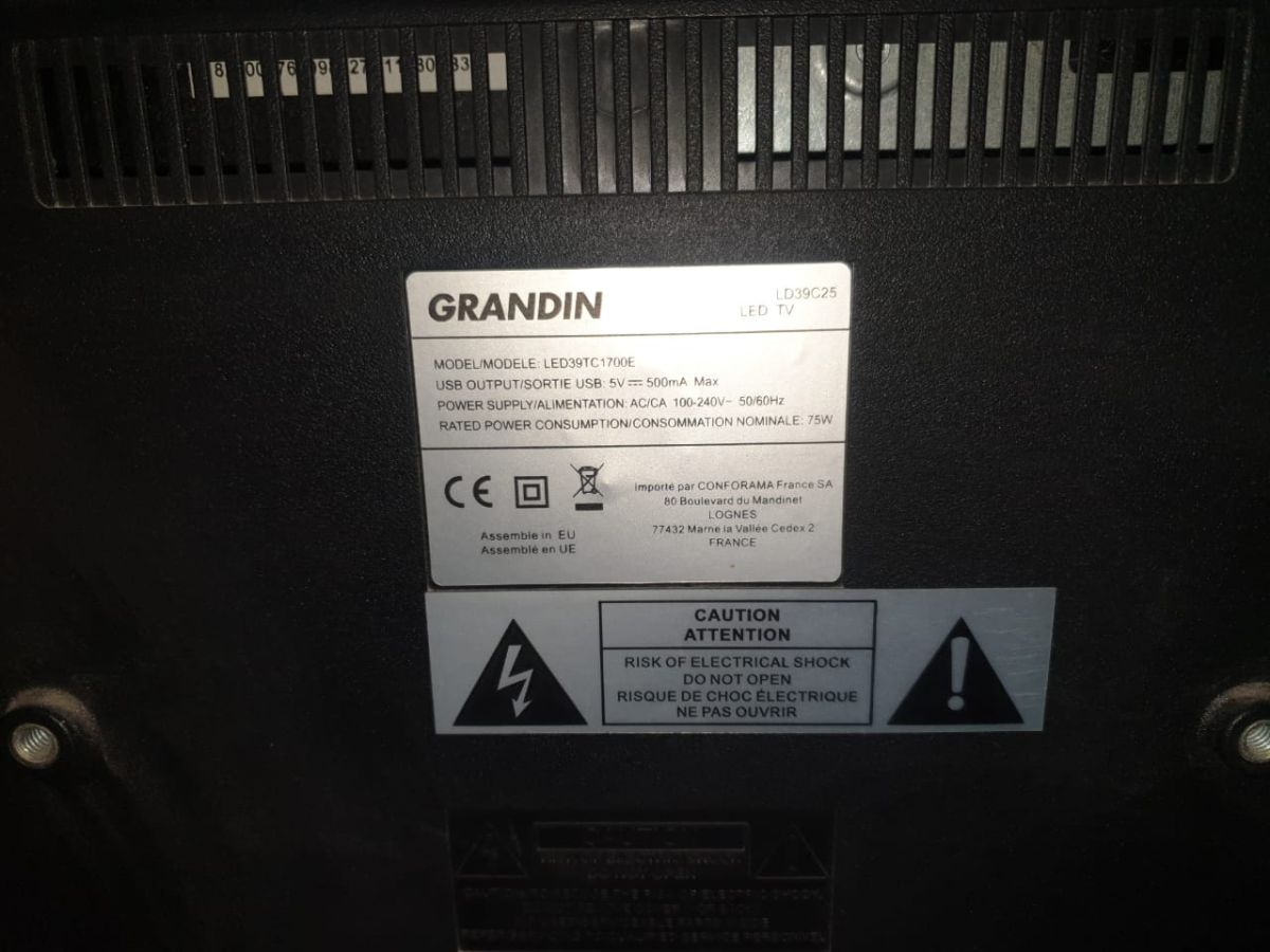

    Nameplate and warning label on the back of a Grandin LD39GC25 TV.
    CAN I HAVE THE FIRMWARE OF IT PLS

    main TP.SIS231.P83 ?
    panel C390F13-E1-C(G3) ?

    try at your own risk!
    this firmware is for GRANDIN model LD39C25 LED39TC1700E
    with main TP.SIS231.P83 and panel C390F13-E1-C(G3)
    how to
    unplug the power cord
    copy the file SISEU23X8M.bin on an empty usb stick fat32 formatted
    insert the usb stick in the tv and reconnect the power cord
    look at the standby led, at the beginning it flashes slowly, after about 1 minute it doubles the speed: update completed
    unplug the power cord and the usb stick and wait until the standby led turns off
    reconnect the power cord and turn on the tv: it will restart in first installation mode
