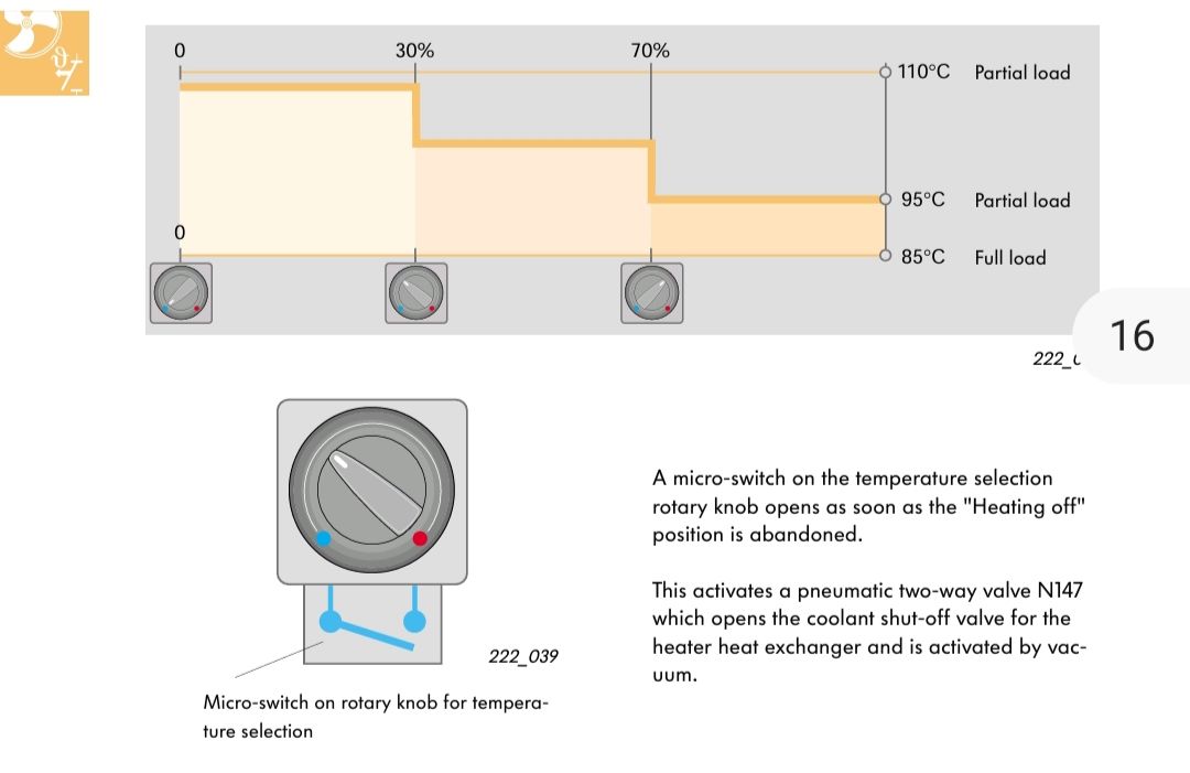

    Replacing the thermostat makes no sense. In this engine the operating temperature reaches 115 degrees. Fellow easterners have mastered the subject:
    https://www.drive2.ru/l/450991633240949386/
    It is enough to swap two pins in the temperature knob block so that the thermostat opens at 95 degrees when set to the "cold" position

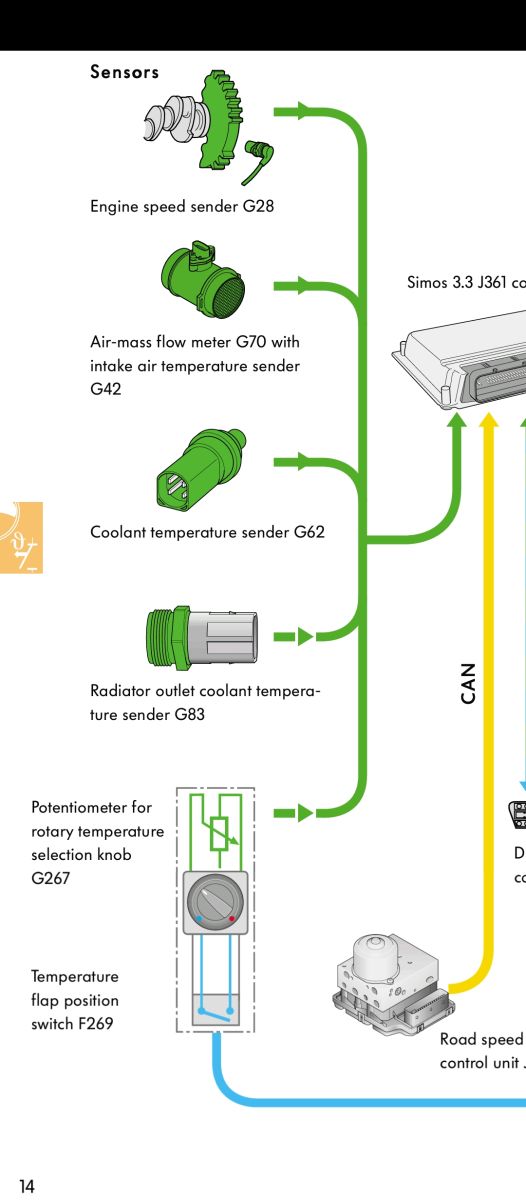

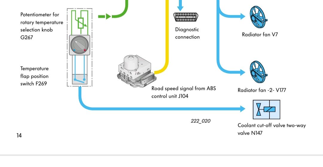

    Thanks for the reply and the link. I found the following in the official documentation:
    Skoda Octavia Mk1 1.6 AVU/BFQ Thermostat Only Opens at Max Heat Setting—Why?
    I will check first the valve N147 and vacuum-operated actuator. Then I'll check the wires which come from the knob. If these two things are ok, I will proceed as per the link you sent.

    Thanks for the instructions, I chose to apply the solution from the link you sent.
    Now the thermostat opens at 90 degrees, the engine block temperature reaches 95 degrees and the radiator at 70 degrees, and then the fans start. That is, everything is as it should be. Now I can use the air conditioning. Regarding heating in the cold season, I either repeat the operation with the contacts when the temperature drops outside, or I buy a powerful indoor fan heater.
