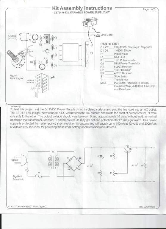

How can I filter a low-power variable DC power supply so it will run a synthesizer without garbled noise?
Add a capacitor from the potentiometer wiper/base of the transistor to the negative rail; a 220 uF capacitor was reported to cut the 120 Hz ripple by about a factor of 40, and it solved the noise problem here [#21660679][#21660680] If the leads from the supply to the synthesizer are long, add more capacitance at the synthesizer input, keep the output wires twisted, and route them away from the model railroad power wiring [#21660672] Keep the potentiometer leads short, and you can also try a 0.1 uF to 1 uF capacitor from the pot output/transistor base to ground for extra high-frequency filtering [#21660672] If the supply still isn’t quiet enough, the thread recommends replacing the transistor regulator with an LM7812/LM7815 or LM317L and using proper regulator capacitors: at least 1000 uF on the rectifier output, 0.1 uF close to the regulator output, and around 470 uF on the output [#21660673][#21660674]

    #1 21660671
    Michael Fleischer
  • Add output capacitance and twist supply leads
    #2 21660672
    Todd Hayden
  • Replace transistor with 78L12 or LM317L regulator
    #3 21660673
    Steve Lawson
  • Use LM7812/7815 with proper decoupling capacitors
    #4 21660674
    Kevin Parmenter
  • #5 21660675
    Michael Fleischer
  • #6 21660676
    Michael Fleischer
  • #7 21660677
    Michael Fleischer
  • #8 21660678
    Samuel Sloan
  • #9 21660679
    DAVID CUTHBERT
  • #10 21660680
    Michael Fleischer
  • LM317K with pass transistor and crowbar protection
    #11 21660681
    Mark Harrington
  • Critique of cheap mains adapters lacking protection
    #12 21660682
    Mark Harrington
  • #13 21660683
    Deejay Thomas
  • Larger output capacitor reduces ripple but ESR matters
    #14 21660684
    Todd Hayden
  • #15 21660685
    Steve Lawson
