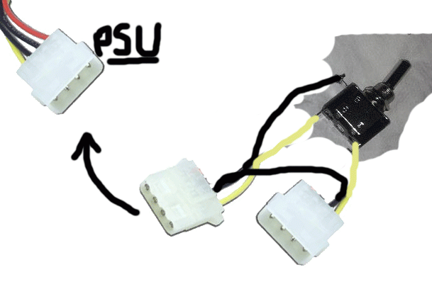

How do I wire a 12V case fan to a PSU Molex connector with an inline on/off switch?
Yes—wire the switch in series with the yellow +12 V lead only, and leave the black wire as the return/ground; the black wire does not need to go through the switch, and doing so could short the PSU in some positions [#21666252] Use a multimeter with the switch disconnected from power to find the two terminals that are open in one position and closed in the other, then connect the yellow wires to those terminals [#21666252] If your part is an SPST on/off switch, that is the right type for this job [#21666259] It is also a good idea to add a fuse in line with the fan if the PSU output is not already protected [#21666244] For a 12V DC fan, some replies also recommend a reverse-EMF/flyback diode and possibly a capacitor across the switch to reduce arcing and noise, although one poster said they would not worry too much about them for a small fan [#21666256][#21666247][#21666258]

The discussion addresses wiring a 12V computer case fan to a PSU Molex connector with an inline SPST on-off switch. The correct wiring involves switching the +12V (yellow wire) line while the black wire serves as ground or common reference (COM). Verification with a multimeter in DC voltage mode is recommended to confirm wire polarity and voltage. Adding a fuse inline with the fan is advised for circuit protection against shorts. Additional components such as a diode for reverse electromotive force (EMF) protection and a capacitor to prevent switch arcing are suggested to enhance reliability, although some users consider them optional depending on the fan and switch specifications. The concept of reverse EMF, generated by the fan's inductive motor coils when switching power, is explained as a potential cause of damage to switches and other components, mitigated by the diode. Continuity testing of the switch terminals is important to ensure correct wiring and avoid short circuits. Resources for beginners to learn electronics fundamentals were also recommended. The switch discussed is a SPST on-off type with an LED, purchased from eBay without a wiring diagram. Overall, the conversation emphasizes careful verification, basic circuit protection, and incremental learning for electronics novices.
