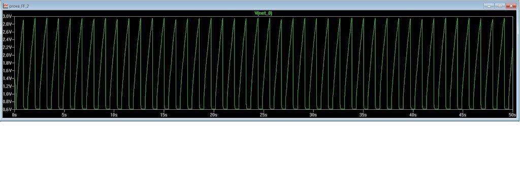

Why do LTspice and ngspice produce different transient results when I run the same netlist with the same apparent simulation settings?
They can differ because the two simulators do not necessarily use the same numerical algorithms, convergence tricks, or interpretation of options, even when the netlist looks identical [#21666437][#21666442] Check and compare the actual simulator settings such as reltol, max step time, and min step time, since these can change results dramatically [#21666437][#21666440] If you want meaningful transient detail, first run long enough to get past the initial transient, then zoom in and use a sufficiently small step size for the behavior you care about [#21666440] A useful way to judge which result is “right” is to compare both against a Berkeley-SPICE-compliant simulator benchmark, because different engines may trade accuracy for convergence differently [#21666442] In this thread, the results became comparable once the circuit was corrected so that R2 and R3 had the same value, suggesting the mismatch was tied to an invalid operating condition plus solver differences [#21666443]
