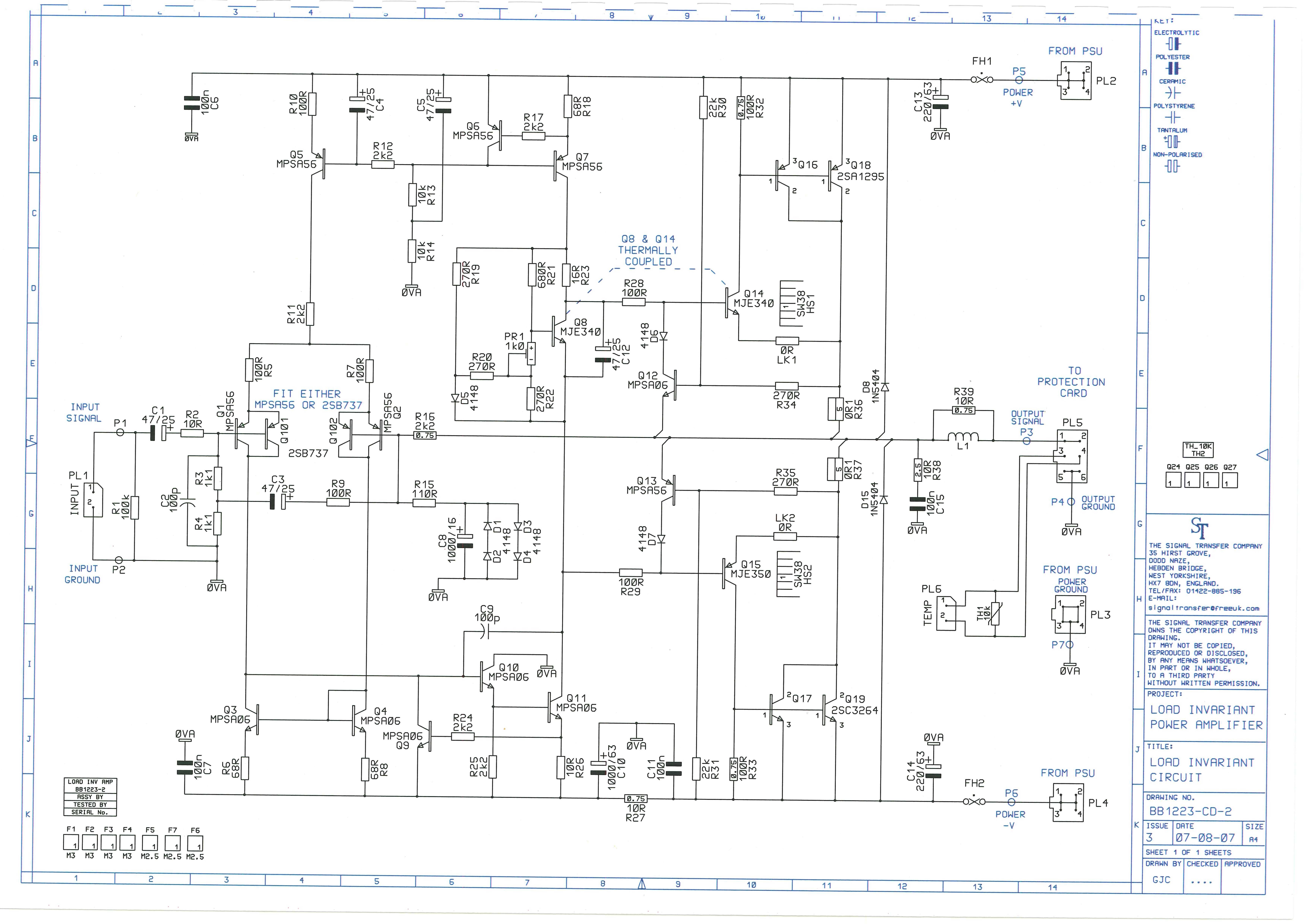

How should I set the bias voltage across R36 and R37 in a Load Invariant CFP output stage when using two parallel output transistors?
No—set the bias across R36 and R37 to about 10 mV; it does not need to be doubled just because there are two parallel output transistors. Douglas Self said that for the Load Invariant design, R36 and R37 are the relevant emitter resistors and the bias voltage across them does not vary significantly with the number of power devices [#21678691] The explanation given was that the extra transistors increase current-carrying capability and spread the load, while Q14/Q15 act as constant-current sources feeding the output devices, so the bias current is shared rather than forcing a higher voltage drop across R36/R37 [#21678694] If you specifically wanted more output current, the suggested change would be to halve R36/R37, but for the normal multi-transistor Load Invariant setup the published 10 mV setting should be followed [#21678694]

  • 10 mV bias across R36 and R37 stays constant

  • Bias current shared by parallel output transistors

The discussion addresses the correct biasing of a Load Invariant amplifier designed by Douglas Self, featuring a complementary feedback pair (CFP) output stage with two output transistors in parallel. The original design recommends a 10 mV voltage drop across output resistors (R36, R37) for a single CFP transistor. The question is whether this voltage drop should be doubled to 20 mV for two parallel output transistors. Responses clarify that R36 and R37 are located in the collectors of driver transistors (Q14, Q15), which act as constant current sources regulating the bias current to the output transistors. This configuration maintains a roughly constant voltage drop (~10 mV) across these resistors regardless of the number of parallel output transistors, as the bias current is shared rather than increased. Separate emitter resistors per output transistor are not used in this design, making transistor gain matching critical to ensure balanced current sharing and minimize distortion. The biasing is self-regulating through negative feedback, preventing voltage drop increase with multiple output transistors. The amplifier is operated at ±50 V DC rails, slightly above the recommended ±45 V, and tested into a 5 Ω load delivering approximately 135 W output. The design emphasizes spreading load current among multiple transistors for reliability rather than increasing bias voltage or current. The discussion also references Douglas Self’s website and amplifier handbook for authoritative guidance.
