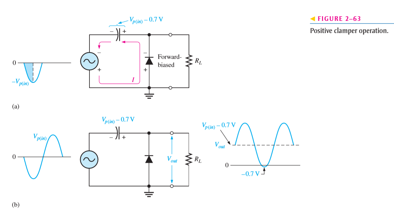

Where did the – 0.7 V on the graph came from? (Clamper Diode Circuit)

  • Questioning the origin of the −0.7 V clamp offset

  • Explains clamp diode behavior at different input amplitudes

  • Clamper diode charges capacitor to Vp minus 0.7 V
