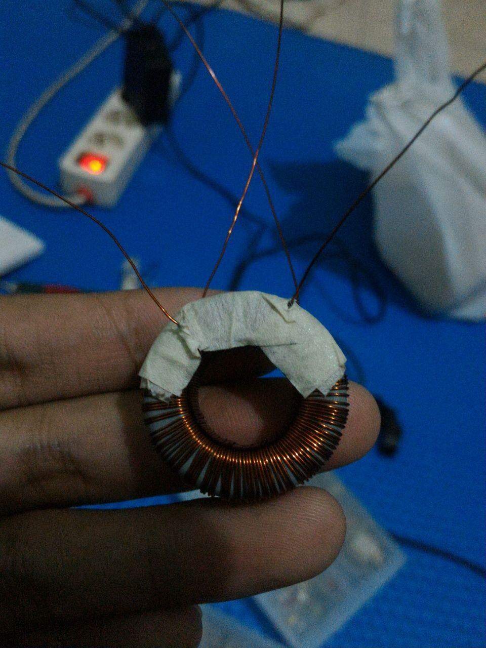

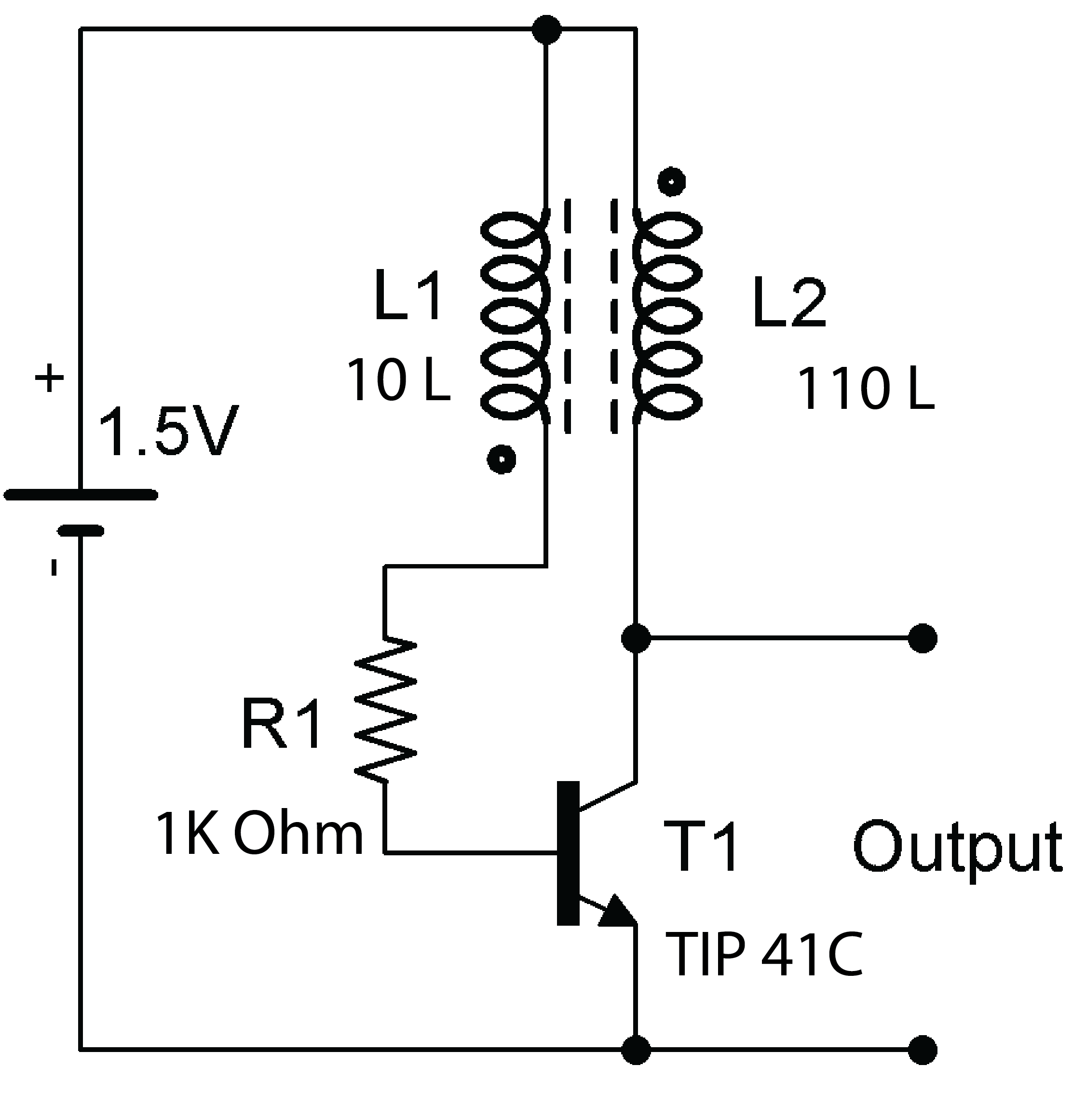

Joule thief circuit: Why is my output -16V and how to make it positive and stable?
291 5

    David Ashton
  • Add diode and capacitor to ground for positive output
    #3 21679712
    Elizabeth Simon
  • Diagnosing waveform polarity and peak voltage with LED test
    #4 21679713
