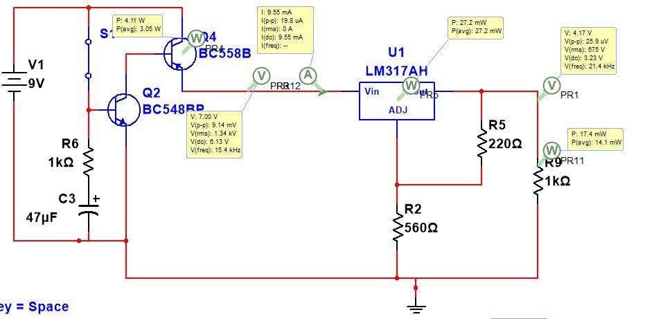

  • LM317 circuit delivers only 17.4 mW to load

  • LM317 set too low and BC558 will burn out

  • Missing current limiting risks transistor damage
