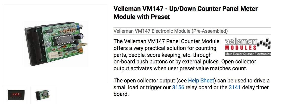

What small NPN transistor and pull-up resistor value should be used to interface a Velleman VM147 open-collector output with a logic input such as a BigEasyDriver enable pin?
Use a small general-purpose NPN transistor such as a BC549, 2N2222, 2N3904, BC447/BC448, or BC332, and a pull-up resistor around 10 kΩ; for the transistor interface, values around 10 kΩ to 47 kΩ were suggested, and 10 kΩ was the practical middle ground for a 5 V logic setup [#21680848][#21680855][#21680857] The VM147 open-collector output pulls LOW when the preset count is reached, so if your logic input needs the opposite polarity, use the NPN stage or a 4049 inverter to flip the signal [#21680849][#21680851][#21680855] For the BigEasyDriver enable input specifically, the thread concluded that the circuit with the NPN interface and pull-up resistors will work, with the enable line pulled HIGH to stop the motor [#21680851][#21680855] If you are using CMOS logic, a 10 kΩ pull-up is fine; if you are using TTL, a pull-up may not be needed [#21680849]

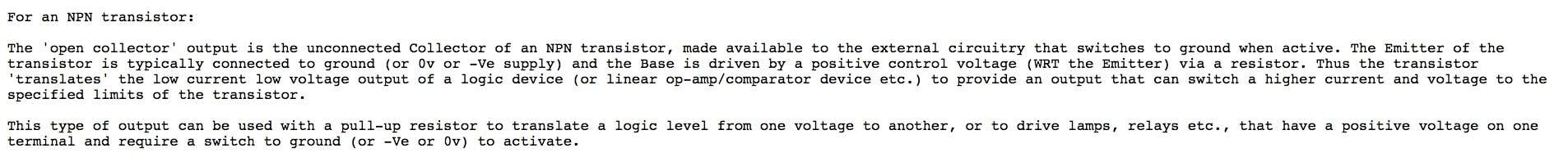

The discussion addresses the appropriate choice of an NPN transistor and pull-up resistor value for interfacing the open collector output of the Velleman VM147 Up/Down Counter Panel Meter Module with logic devices, specifically to control a BigEasyDriver stepper motor driver. The VM147’s open collector output activates when the preset count matches the current count, pulling the line low. To interface with logic inputs, a pull-up resistor is required to ensure a defined high level when the transistor is off. Suitable general-purpose NPN transistors include BC549, 2N2222, 2N3904, BC332-25, or BC447, with the BC332-25 identified as the transistor on the VM147 board handling the open collector output. The pull-up resistor value can range broadly from 1kΩ to 100kΩ, with 10kΩ recommended as a practical middle ground, balancing current draw and switching speed. For driving the BigEasyDriver’s Enable input, which disables the motor when high, signal inversion is necessary since the VM147 output pulls low on activation. This inversion can be achieved using a 4049 hex inverter IC or an additional transistor stage. Both the VM147 and BigEasyDriver logic levels operate at 5V, allowing shared supply lines for pull-up resistors. The transistor interface ensures the open collector output can safely and effectively drive logic inputs without loading or floating states.

What does the VM147 open-collector output actually do?
It exposes the collector of a transistor. With a pull-up, the line reads HIGH when inactive and is pulled LOW when the VM147 matches the preset. Think of it as a ground-side on/off switch that needs a resistor to report a logic HIGH when off. [Elektroda, Anonymous, post #21680849]

What’s the safe current capability of the VM147 open-collector output?
It can drive a relay coil up to about 100 mA with a diode and 1 kΩ per the manual’s example. For logic coupling, stay far below that to protect the onboard transistor. This headroom minimizes heating and failure risk. [Elektroda, Anonymous, post #21680849]

What is an open collector (definition)?
An open collector is a transistor output that only sinks current. It requires an external pull-up to report HIGH when off, and it pulls LOW when on. It’s flexible for level shifting and wired-OR logic. [Elektroda, Anonymous, post #21680849]
