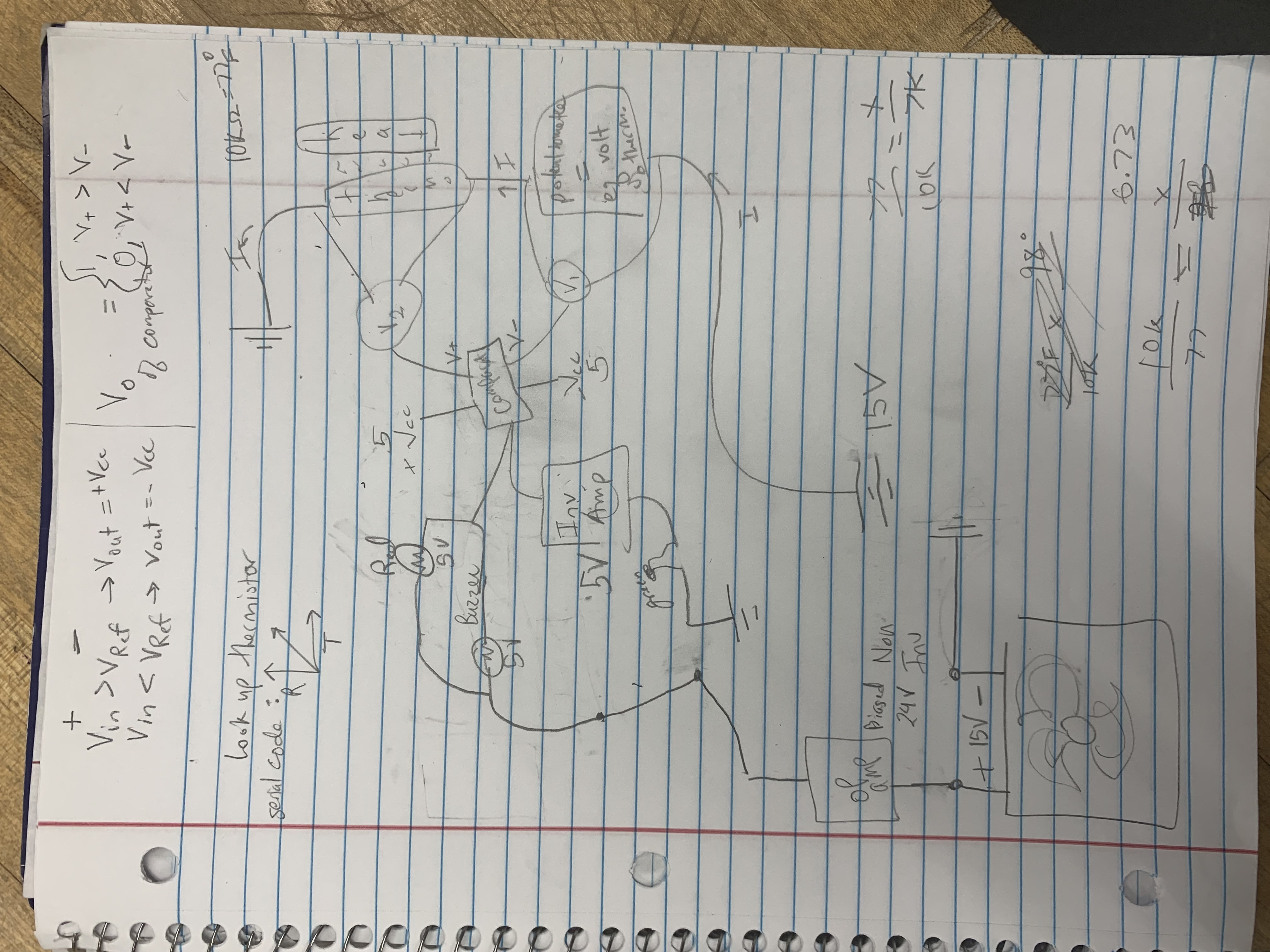

How should I approach and conceptualize an op-amp design project for an introductory circuits class when the circuit includes components we have not covered yet?
Redraw the circuit with standard schematic symbols first, because the current sketch is hard to follow, and then use an op-amp reference text to build your understanding [#21681128] [#21681129] Free schematic-capture tools such as Schematics.com or the free version of DipTrace can help you make a clearer diagram [#21681128] A recommended beginner-friendly book is George Clayton’s _Operational Amplifiers_, which is described as suitable for undergraduate study and as having a good balance of theory and practical coverage for first- and second-year modules [#21681129]

  • Request to redraw the schematic with standard symbols
    #2 21681128
