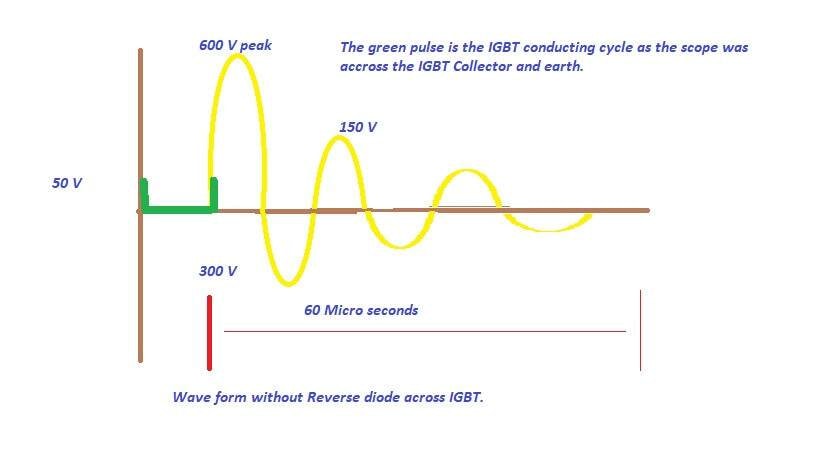

  • Reverse diode overheating in C-dump SRM drive
    #1 21681467
    Cobus Verster
  • Half-bridge per phase recommended for SRM drive
    #2 21681468
    Rick Curl
  • Reverse diode spike measured at 30 V above supply
    #3 21681469
    Cobus Verster
  • #4 21681470
