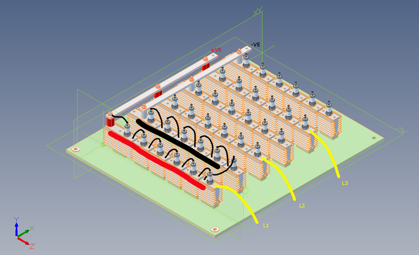

Required Creepage Distances for 12.5kV AC-DC Bridge Rectifier With Series Avalanche Diodes
378 10
What creepage and clearance should I use between series diodes and heatsinks in a 12.5 kV AC bridge rectifier, and can adjacent devices be spaced for only the 0.7 V forward drop?
You should not size the creepage or clearance between series diodes for 0.7 V; on the reverse half-cycle the string sees the full AC voltage, so the spacing between diodes in a row should be based on the maximum PIV of each rectifier because avalanche parts may not divide voltage equally [#21681716][#21681717] The reverse-avalanche voltage of each rectifier should be higher than its PIV rating so it does not break down at PIV [#21681720] For the spacing between rows, one reply recommends designing for 17.6 kV (12.5 kV × 1.414) plus a generous safety margin [#21681716]

A design project involves creating a 12.5kV AC-DC bridge rectifier using series-connected avalanche diodes, each with a 5kV peak inverse voltage (PIV) rating, arranged in six series per limb to achieve a total rating of 30kV. The main concern is determining appropriate creepage distances for insulation and safety. It is clarified that the creepage distance between diodes in a single limb must be sized for the maximum PIV of each diode, not the low voltage drop (~0.7V) during conduction, because during the reverse half-cycle the full AC voltage appears across the diode string. The creepage distance between limbs (rows) should accommodate the peak line-to-line voltage (approximately 17.6kV, calculated as 12.5kV × √2) plus a safety margin. The avalanche diodes’ reverse avalanche voltage exceeds their PIV rating to prevent breakdown at rated voltage. The design current is specified as 50A DC, with protection handled externally by the customer. Considerations include voltage division uncertainty among series diodes and environmental factors such as lightning surges from utility distribution lines.
