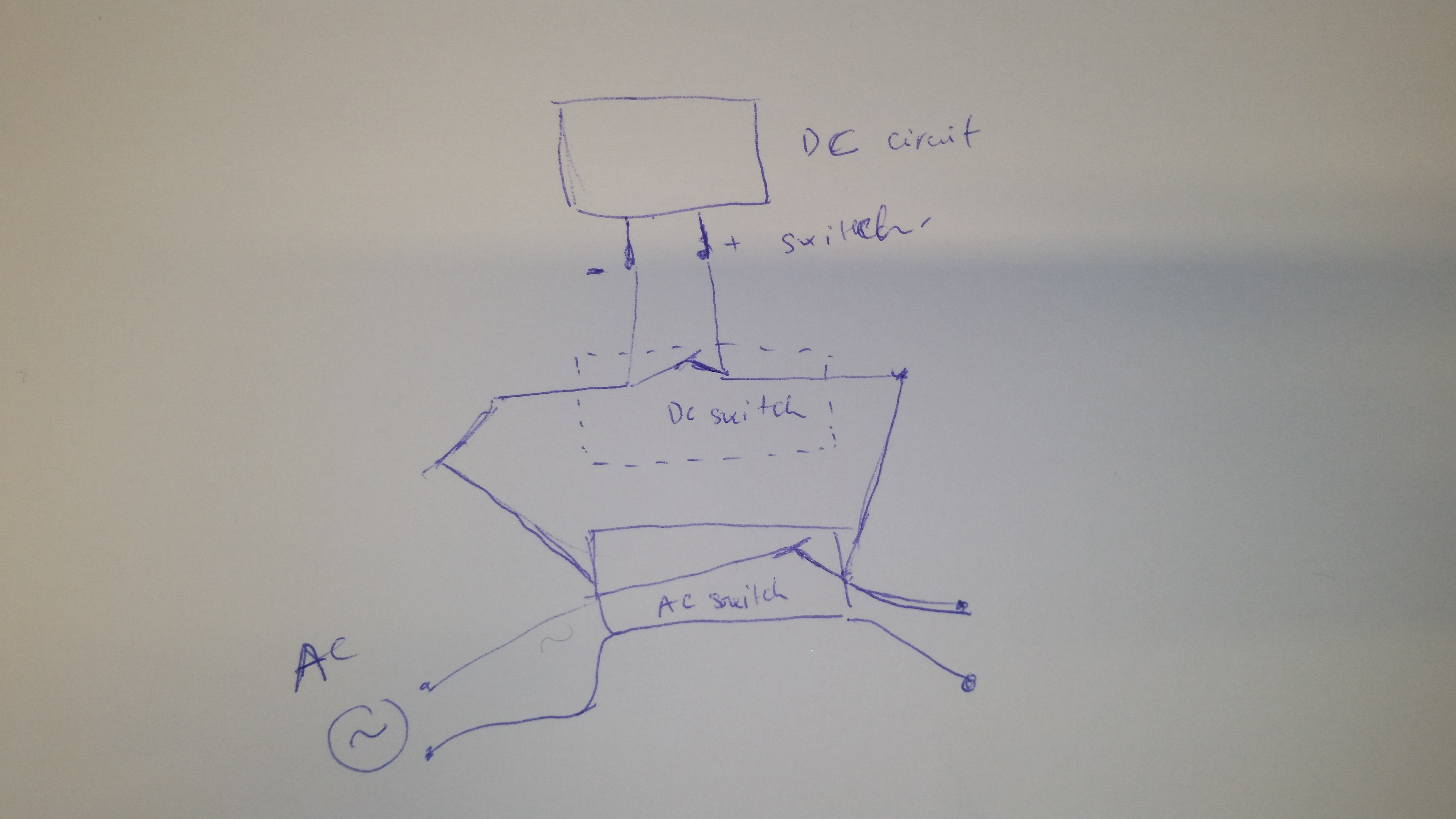

  • Question about using an AC smart switch on DC circuit

  • Need galvanic isolation between AC and DC control signals

  • Relay provides isolation; switch DC positive in series

  • Clarifying parallel wiring of AC smart switch to DC jumper

The discussion addresses the safety and feasibility of using a smart AC switch to control a DC circuit, specifically a 5V DC jumper-like connection powered by an AC-to-DC power supply. Key concerns include the isolation between AC and DC circuits to prevent damage or hazards. It is emphasized that direct electrical connection between AC and DC components should be avoided to prevent short circuits or shocks. Proper isolation methods, such as using relays or solid-state devices designed for switching, are recommended to safely control AC and DC circuits in parallel. The original DC switch operates by connecting two terminals in series to complete the circuit, while the AC smart switch is intended to operate in parallel. The importance of correct wiring—switching the positive line rather than shorting positive and negative terminals—is highlighted. Additionally, the complexity of coupling AC signals into DC circuits requires careful impedance and frequency considerations. Overall, the consensus is that mixing AC and DC switching elements without proper isolation and design can be unsafe and potentially damaging to the DC setup.
