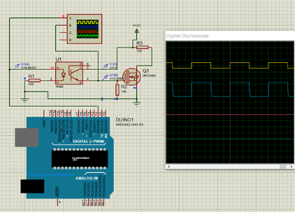

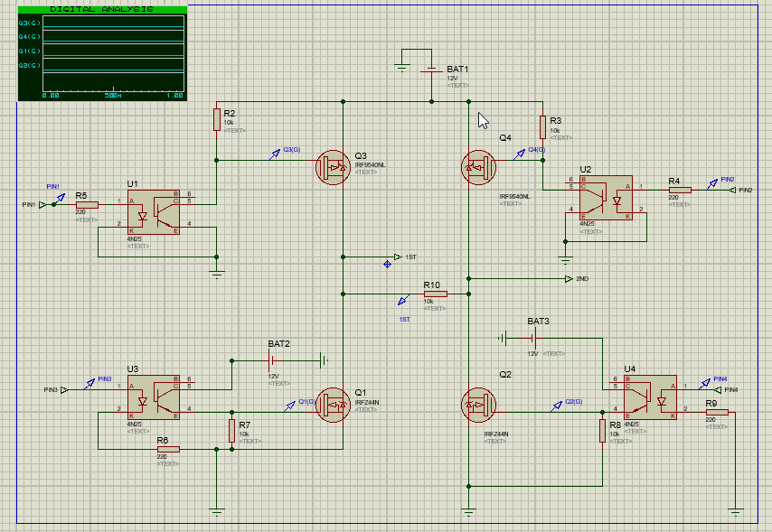

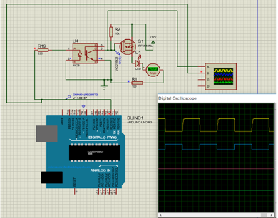

Why is the Arduino signal not passing through the optocoupler in Proteus, and how can I make the 7-level inverter simulation work?
The optocoupler/CCT005 subcircuit appears to be the part that does not simulate properly in Proteus, so the signal never reaches the gate driver; using the Arduino and H-driver together without the CCT005 subcircuit worked instead [#21683643] The responder could not simulate the child sheet of CCT005 either, so they built a separate project rather than keeping that block inside the design [#21683643] The practical fix suggested by the thread is to bypass that child-sheet optocoupler block and wire the Arduino directly with the H-driver stage in the simulation [#21683643]

The discussion addresses a simulation issue in Proteus involving a 7-level bridge inverter controlled by Arduino signals. The main problem is that the Arduino output signals fail to pass through the optocoupler, preventing gate triggering in the H-Bridge sub-circuit. While individual high and low side bridge simulations work correctly, the complete system does not function as expected. Attempts to debug with a digital analyzer confirmed the signal blockage at the optocoupler stage. A suggested solution involves bypassing the problematic optocoupler sub-circuit (CCT005) and directly integrating the Arduino with an H-Bridge driver chip, such as the L293D, which successfully generated the 7-level inverter waveform in simulation. This approach indicates that the optocoupler model or configuration in Proteus may be causing the failure, and using a simpler direct driver model can resolve the issue.
