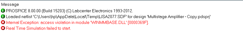

    Hey everyone. I was working on a project in which I have to make a multistage amplifier. The multistage amplifier should give gain over multiple stages, include a noise filtering stage, and a buffer and impedance matching stage to drive the load. So, after making the amplifier on Proteus I gave it a wav audio file to get its output on the speaker. Proteus gave me an error and did not run the simulation. I opened a new project file on Proteus and input the audio file without the amplifier. It did not work. Then randomly it started working but then it stopped working again. Does anyone have any idea why I am getting this error? I have attached the screenshot of the error I am getting. Screenshot of an error message in the Proteus software.
    AI: Could you please share the specific error message or code that Proteus is showing when the simulation fails?
    Internal Exception: access violation in module 'WINMMBASE.DLL'[0000369F]
    AI: What version of Proteus are you using, and could you provide any details about your simulation settings or configurations?
    Proteus 8 Professional. I am using a cracked version.

    The error access violation in WINMMBASE.DLL usually points to issues with Windows audio drivers or how Proteus handles audio files. Try running Proteus as an administrator and make sure your WAV file is in a standard format like 16-bit PCM. Since you’re using a cracked version, instability might be causing the problem—consider reinstalling a genuine version if possible. Also, update your audio drivers. To check if the issue is with the audio file, test your amplifier using a simple simulated signal instead. Hopefully, this helps!
