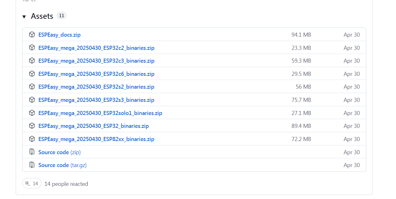

    Hello, I want to upload a library to ESP32 WTH01- module with RJ45 socket. IN ESP EASY.
    Which directory to download? Which library to upload?
    In SUPLi I was able to establish a connection, but not in ESP Easy.
    List of ESP Easy binary files for various ESP32 versions on GitHub

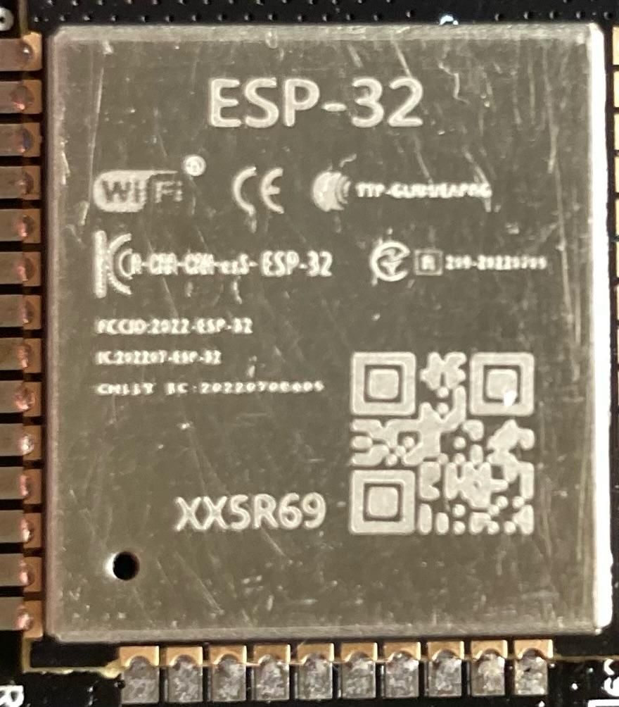

    ESP-32 module with model marking and QR code on metallic cover, shown close-up

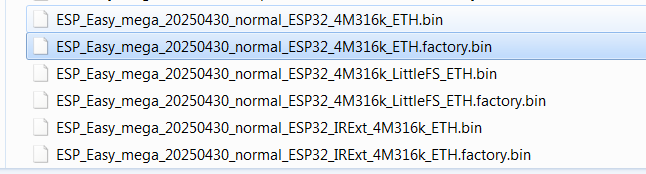

    I uploaded the factory file, I managed to connect to the board over wi-fi, but I don't know how to make it LAN- the LEDs in the RJ45 socket don't light up :
    List of ESP Easy binary files with ETH factory file selected for ESP32

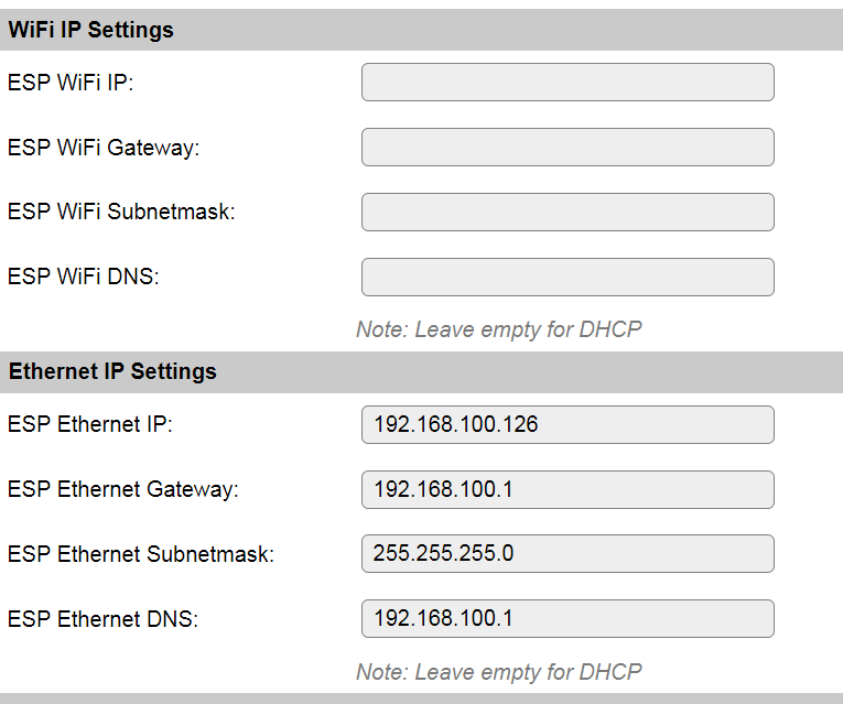

    ESP Easy IP settings showing filled Ethernet fields and empty WiFi fields

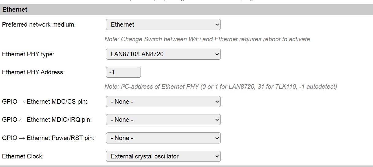

    or maybe something needs to be set here:
    Screenshot of Ethernet settings in ESP Easy with unassigned GPIO pins

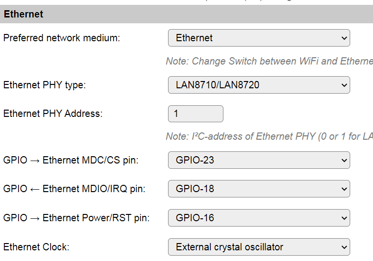

    All in all, I solved the problem myself and that's gratifying, but it came down, maybe someone else will find it useful too.
    ESP32 Ethernet settings with Ethernet medium and LAN8710/LAN8720 PHY type selected
