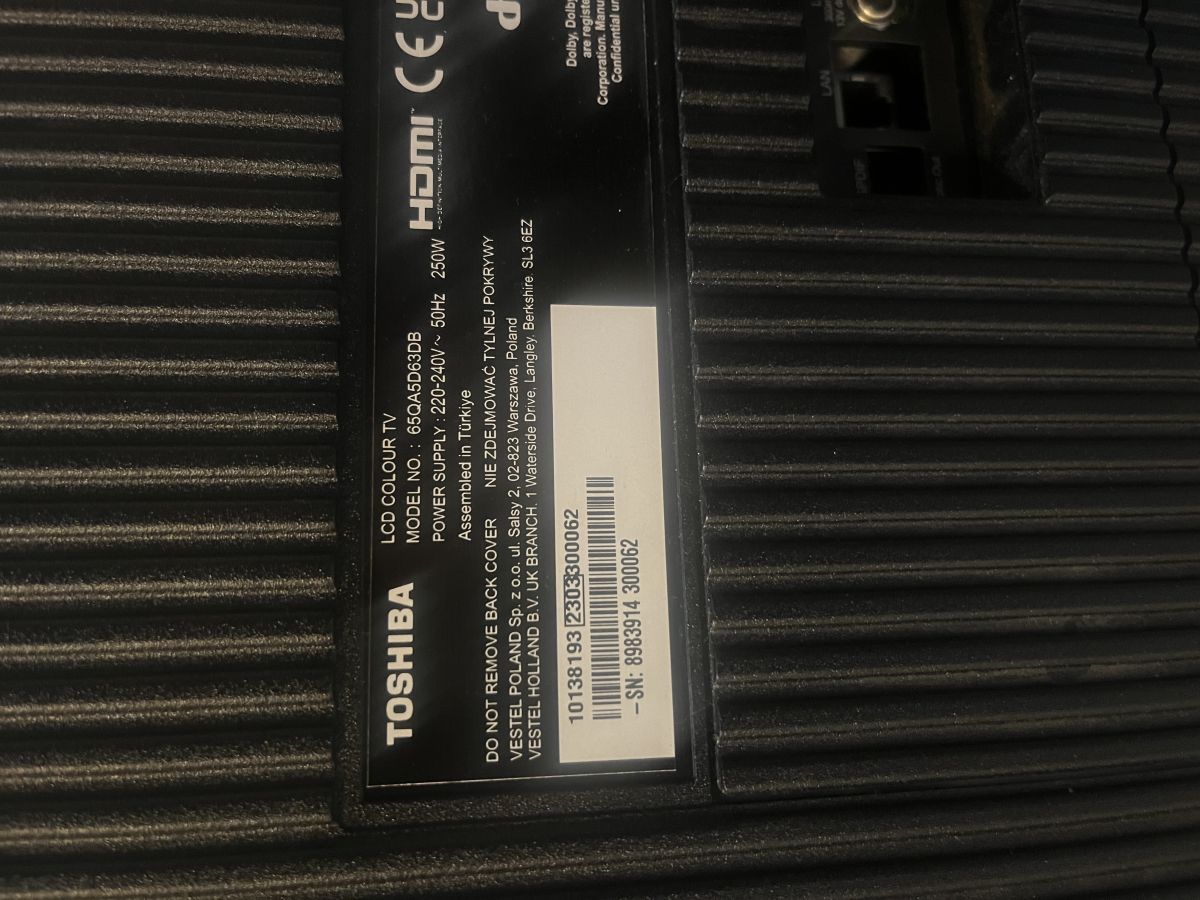

    I have a 65QA5D63DB, Panel Number VES650QNTH-P2-Z01. It had a main board fault on the eMMC causing TV to stay in standby and not respond, but I couldn’t get the exact same main board as mine, so I bought one that was from a slightly different panel and now I have double image. I need to flash the firmware for my panel onto it so that it’ll be back to normal. I need the firmware for this panel & model.

    post a photo of the sticker on the back of the tv: product code and serial number required

    according to serial number, the sw from @yokoono51 is for a different panel
    it's for VES650QNTL-P2-Z01 (LG LC650EQQ-SMA3)
    your panel is a VES650QNTH-P2-Z01 (HKC PT650GT01-1)
