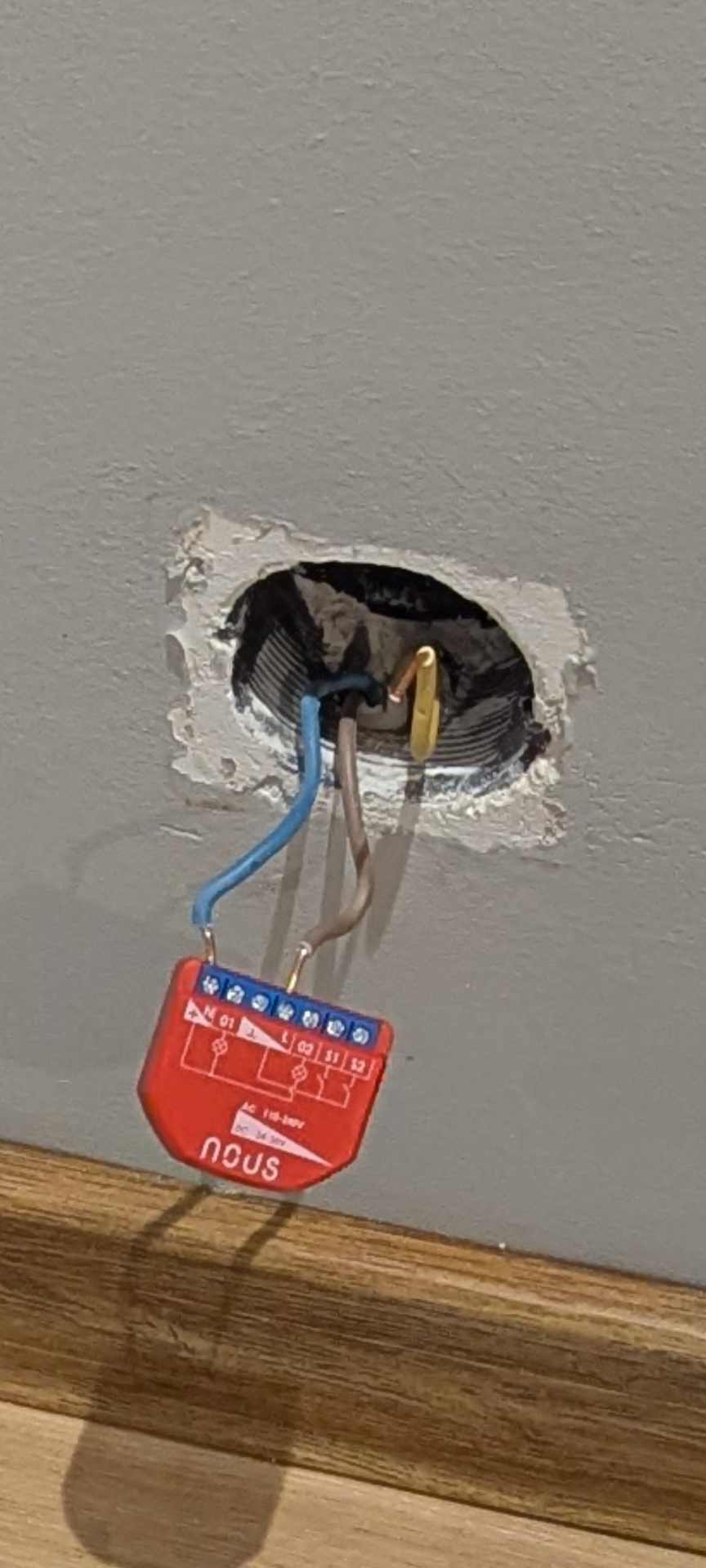

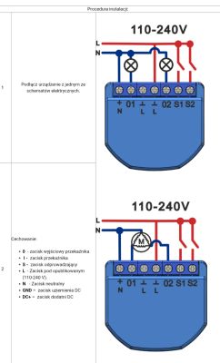

    I have purchased a B3Z NOUS relay module that will be plugged into a socket.
    Asking for help with the correct wiring, including the earth wire.
    NOUS B3Z relay module connected to exposed wires in a wall electrical box
    Wiring diagrams for B3Z NOUS relay module in 110–240V AC configurations
    Thank you for your help.
  • #2 21760394
    78db78
    Posts: 10535
    Help: 1792
    Rate: 3230
    You connect L and N to the relay and PE directly to the socket.

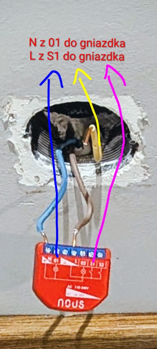

  • #5 21760431
    czajcons
    Posts: 6
    So from the relay N from 01 goes to the socket, L from S1, and PE directly to the socket?
    Nous module connected to colored wires leading into a wall socket
  • #6 21760633
    78db78
    Posts: 10535
    Help: 1792
    Rate: 3230
    Wrong, N is N and you take the phase from 01.
  • #7 21760958
    czajcons
    Posts: 6
    But I have to have an input and an output.
    Input N to N, and output 01
    Input L to L, and output 02 or the third terminal from the left

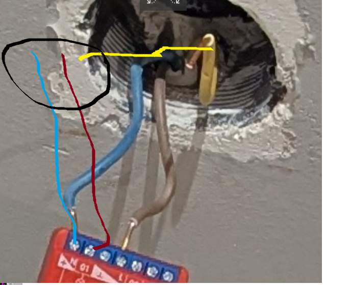

  • #8 21761017
    78db78
    Posts: 10535
    Help: 1792
    Rate: 3230
    Electrical wiring with marked connections inside a wall socket box
