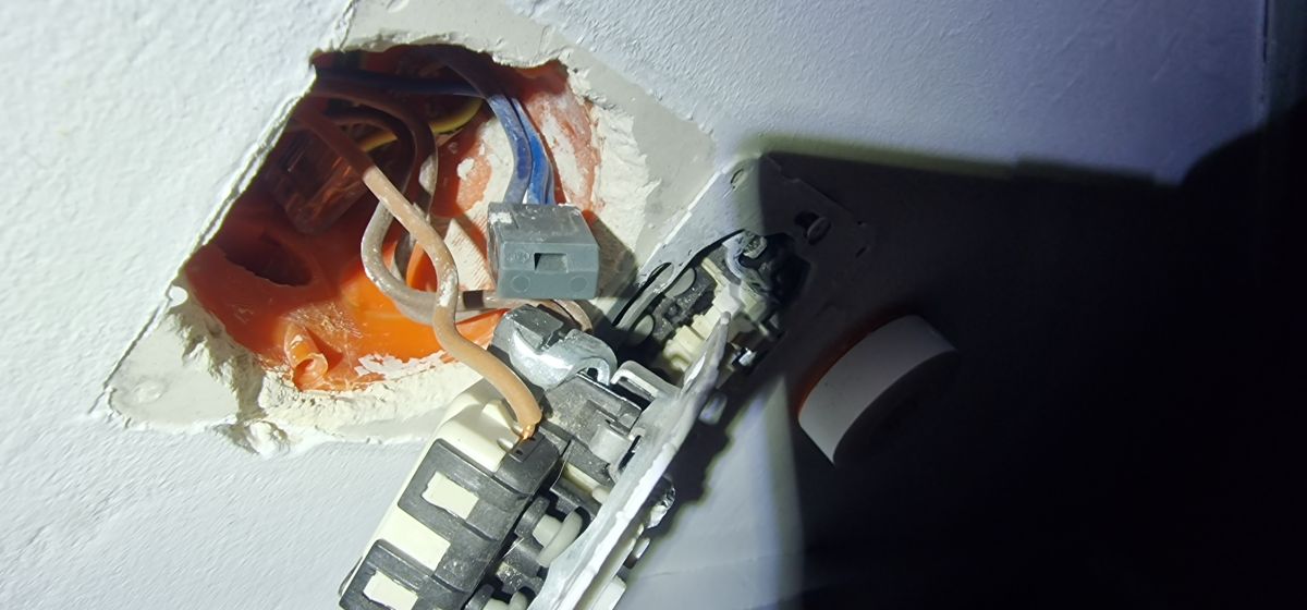

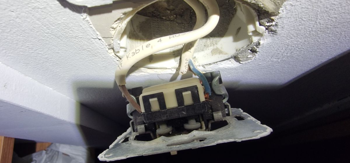

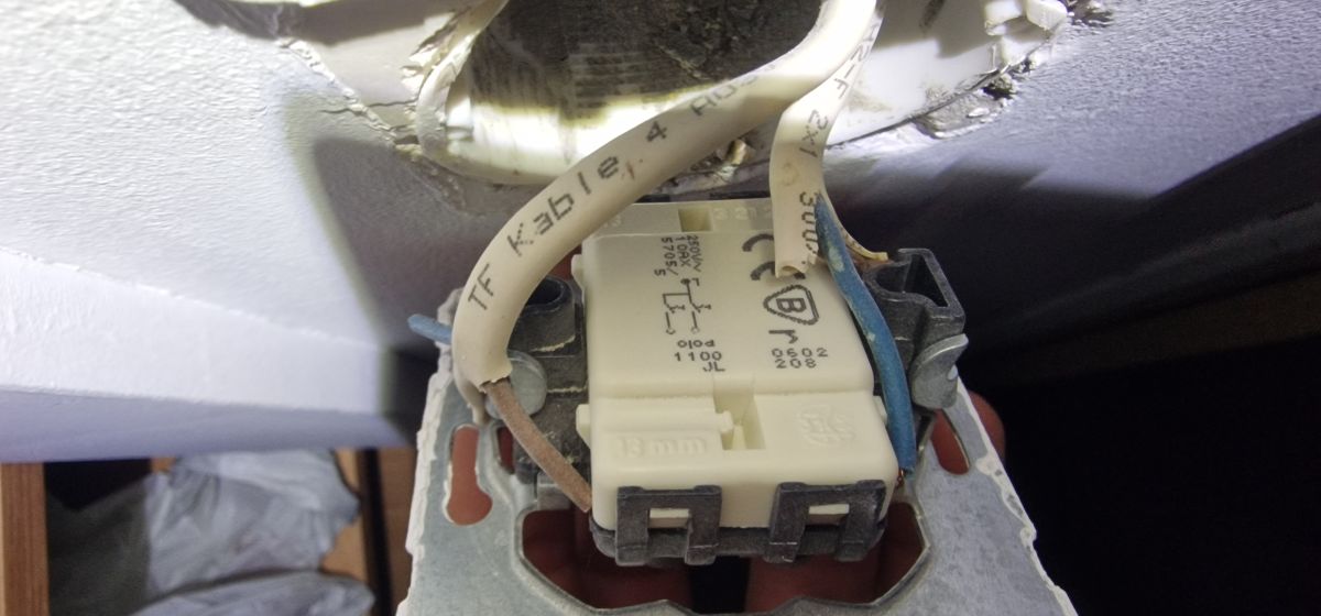

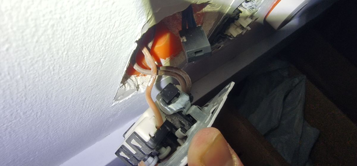

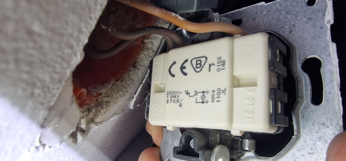

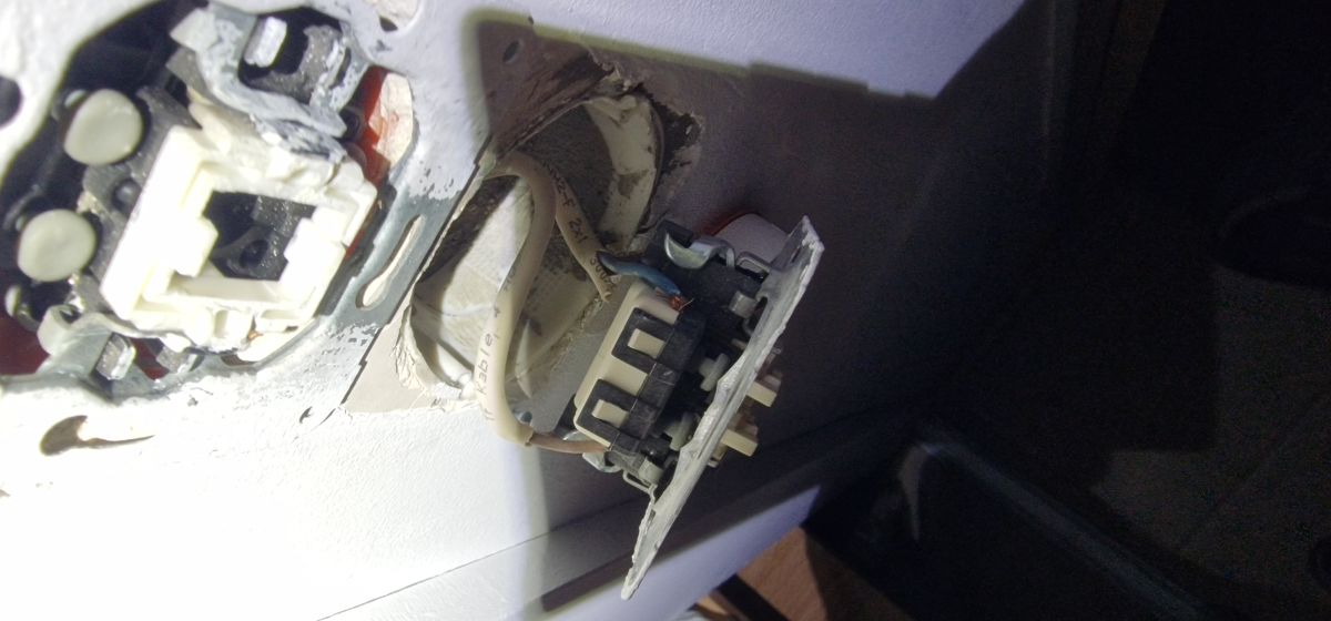

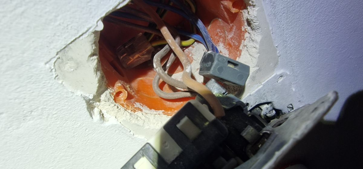

    I would like to install in the sockets from the entrance and living room lighting - 2 controllers https://allegro.pl/oferta/sonoff-2x-zbminil2-...wnik-zigbee-3-0-bez-n-neutralnego-16546742718, how to connect this with my socket layout ?
    Light switch mechanism with visible wiring, including phase and neutral wires
    Open wall box with exposed light switch mechanism and visible wiring
    Recessed light switch with exposed live and neutral wires in wall box
    Close-up of light switch back with connected wires and electrical markings
    Light switch removed from wall box, visible live wires and mounting in the wall
    Electrical wall box with phase, neutral and earth wires and a light switch
    Close-up of electrical wall box with wires and a double light switch
    AI: Can you describe or throw in a diagram of what the current wiring arrangement looks like in the boxes at the entrance and in the living room? Do you have a neutral (N) wire there, or just a phase (L) wire?
    I have 3 neutral wires on the connector.
    AI: What kind of light switches do you have in these locations - single, staircase, cross? How many are there and are they in flush or surface mounted boxes?
    Single, one double but only operates 1 light
