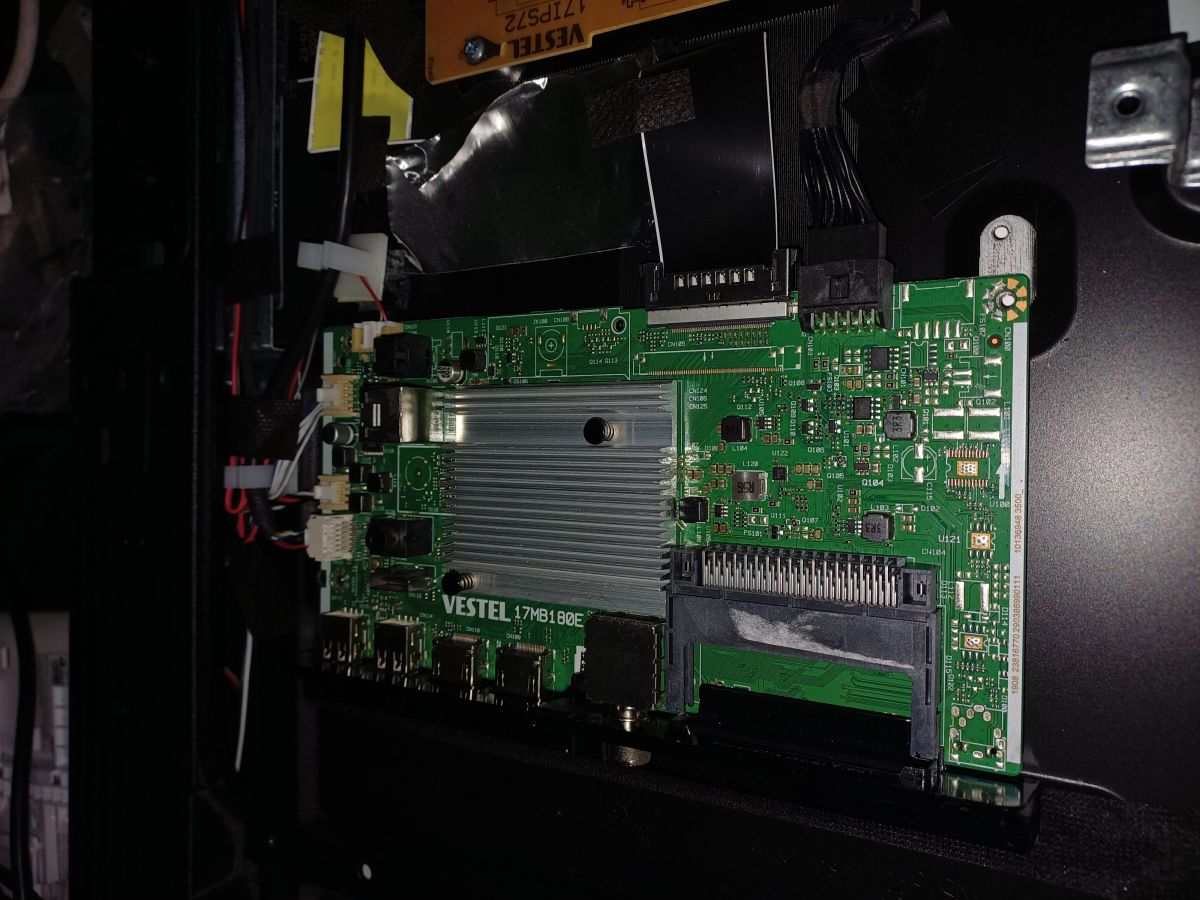

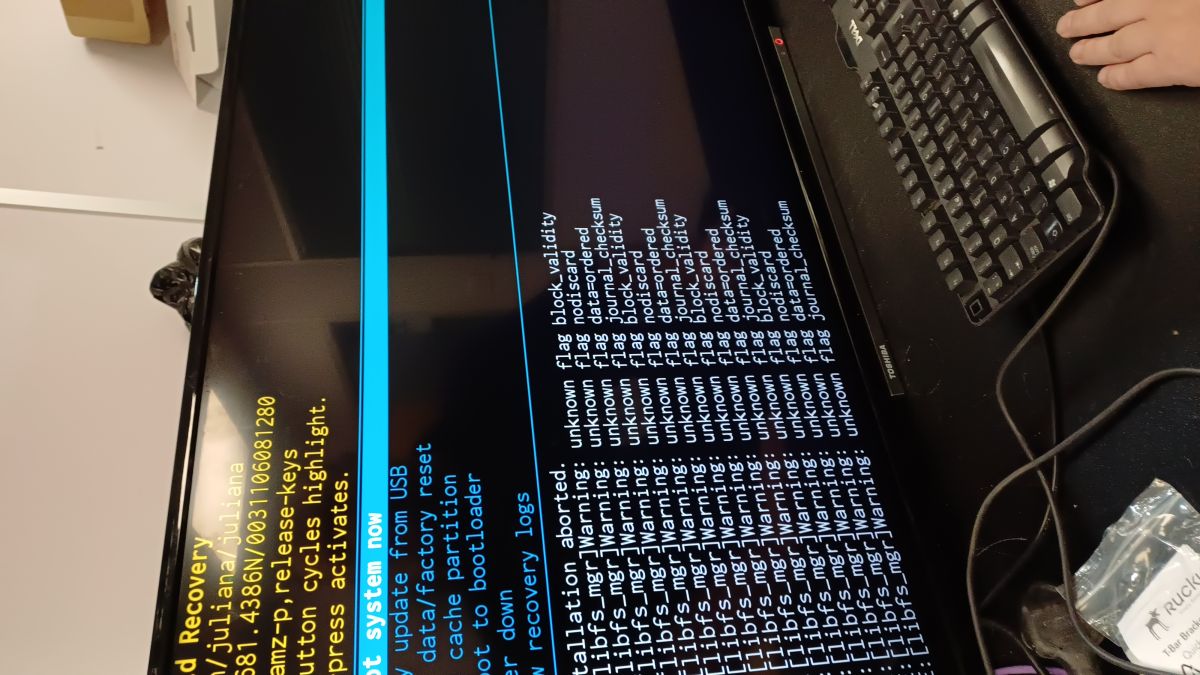

    I have an issue with the following and looking for some help.
    Firmware for Vestel 17MB180e from Toshiba 43uf3d53db
    The TV is stuck in a boot loop with FireTV logo. I can enter bootloader OK but many errors in the logs relating to e:libfs_mgr Warning: unknown flag ...
    If anyone had a firmware I could try and boot from? I called Toshiba and they can't help because of the Amazon software Fire OS 7.6.8.1. Failing that, I noticed that I notice that it may be possible to unlock the bootloader by shorting a pin on the KLM8G1GETF eMMC and maybe load firmware from here if anyone has experience of this?
    AI: Have you already tried any factory reset or USB recovery methods, or attempted to load any official update files via the bootloader? If so, what was the result?
    I don't have access to official update files to attempt recovery.
    AI: What tools or equipment do you have available for flashing firmware or accessing the eMMC (e.g., USB programmer, UART, JTAG, or just a USB stick)?
    USB and possible access to eMMC

    I am trying to update the firmware using the update from USB from the recovery, but it's not installing. I have extracted the bin file MstarUpgrade.bin and placed on root of USB and left the zip file on also to try.
    I did see an E:footer is wrong error.
    I wonder if eMMC SD is failing? Any ideas. Thank you
    Added after 1 [hours] 7 [minutes]:
    >>21782088
    I am also getting :
    update package verification took 0.0 s (result 1)
    E:signature verification failed
    E:error:21

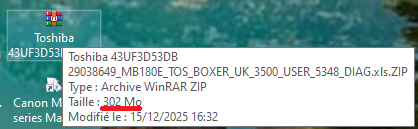

    The file has a problem
    File MstarUpgrade.bin has size 0 bytes and date 14/02/2024 14:06
    ZIP file named Toshiba... with size 302 Mo and modification date of December 15, 2025.

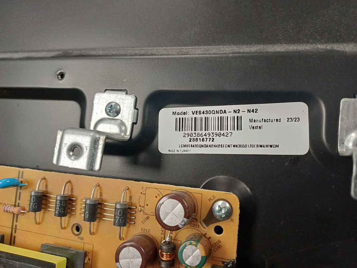

    Tell us what code the panel has and maybe we can find equivalent software.
    #7 21782416
    yokoono51
    Posts: 829
    Help: 172
    Rate: 317
    The panel code looks like this

    VES430QNDA model label on metal panel with part of a circuit board
    Good morning.
