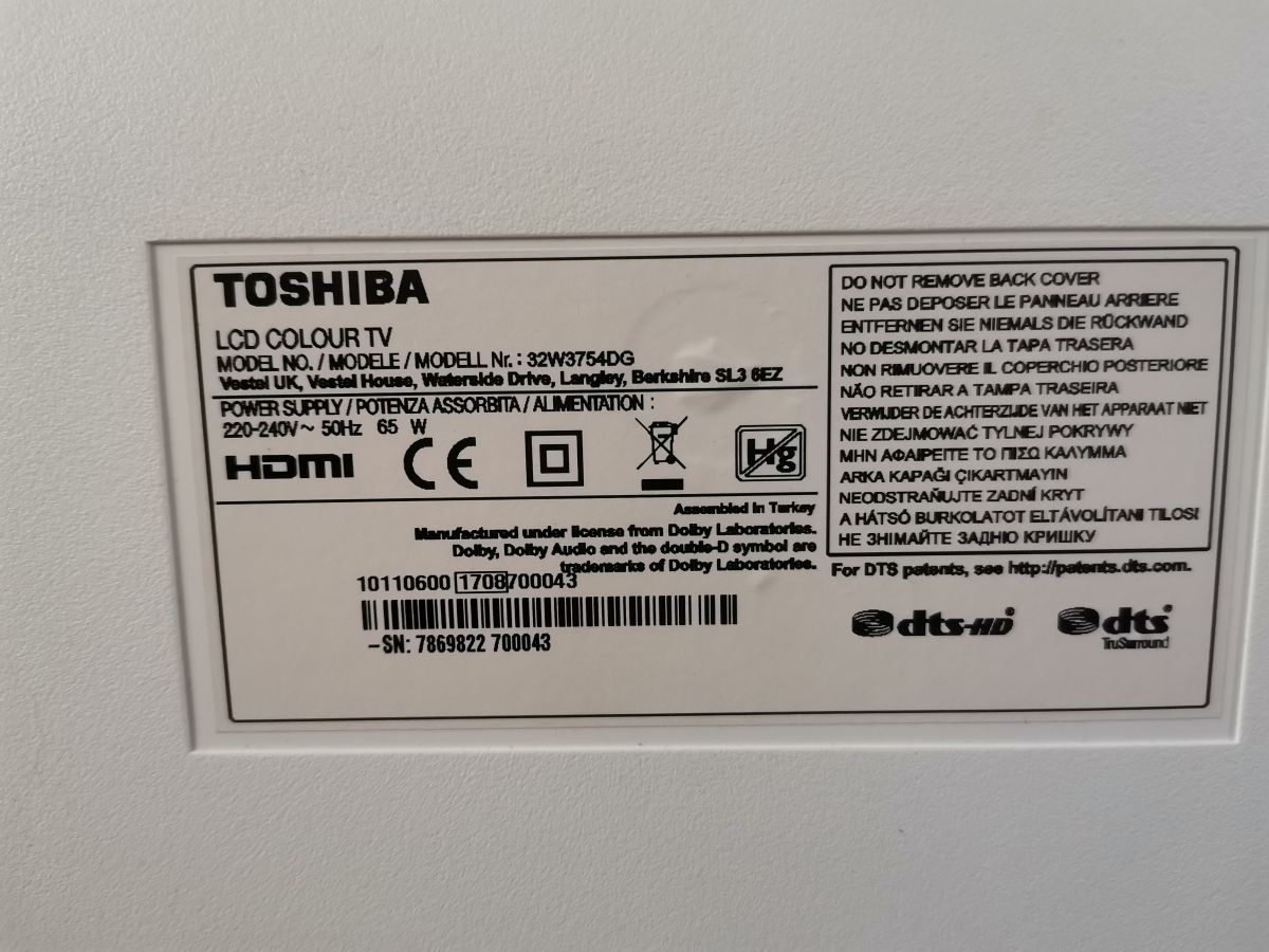

    Please include a photo of the serial number label

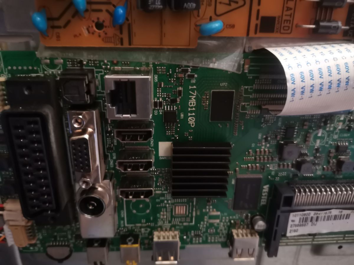

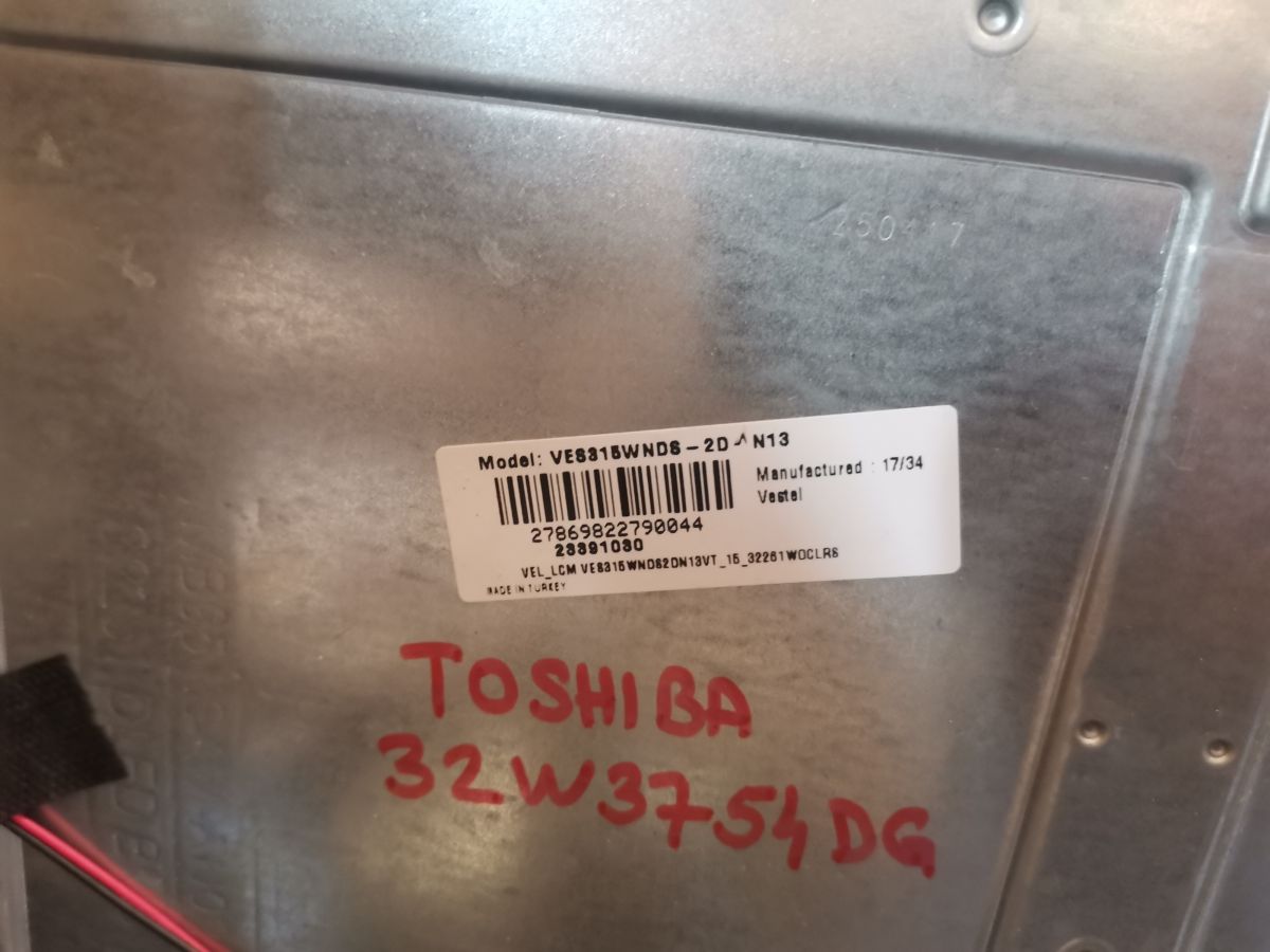

  • #3 20824461
    babariba1
    Posts: 6
    A circuit board with various ports and connectors. Nameplate with model and manufacturer information. Information label of a Toshiba LCD TV.
