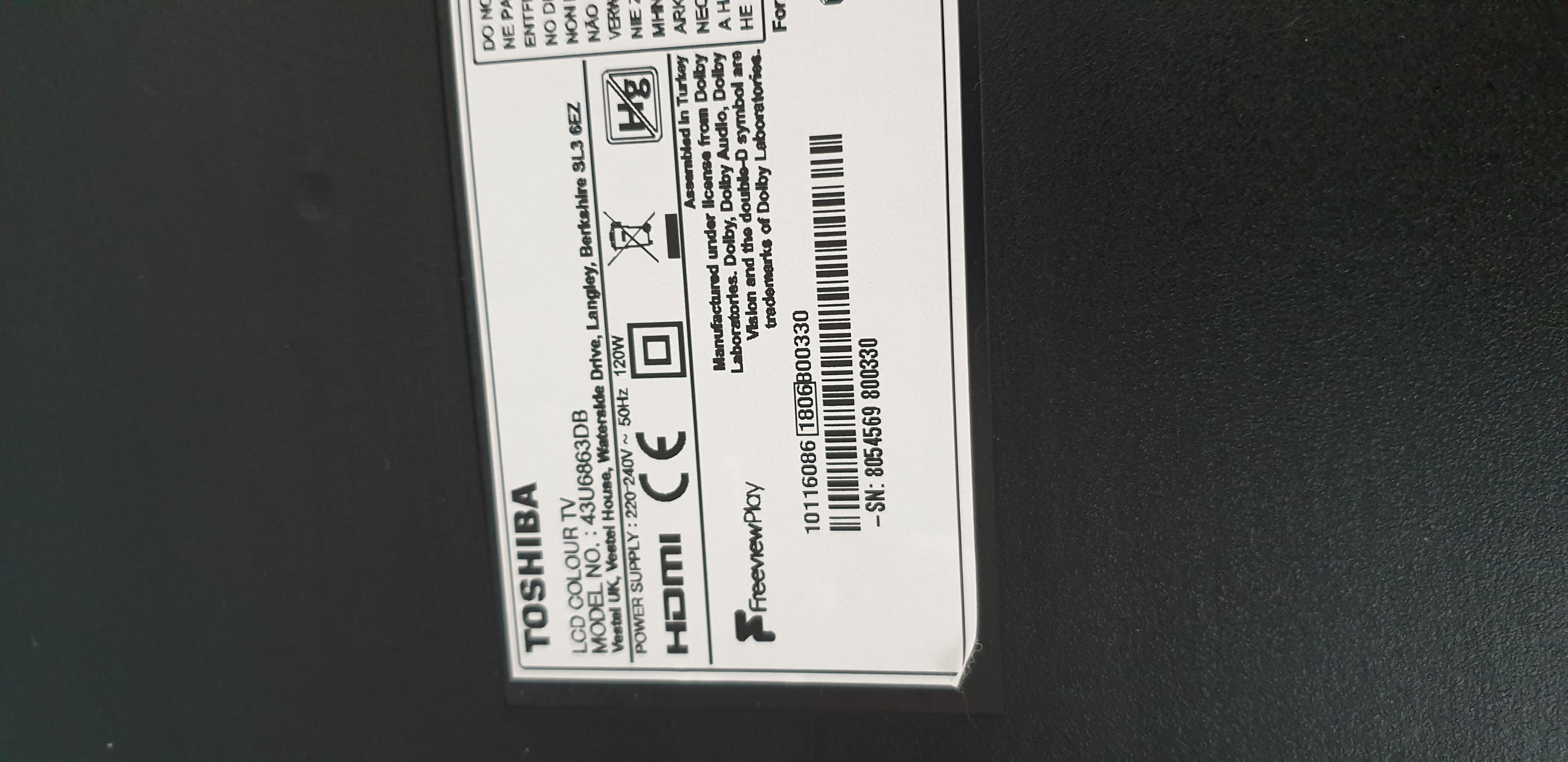

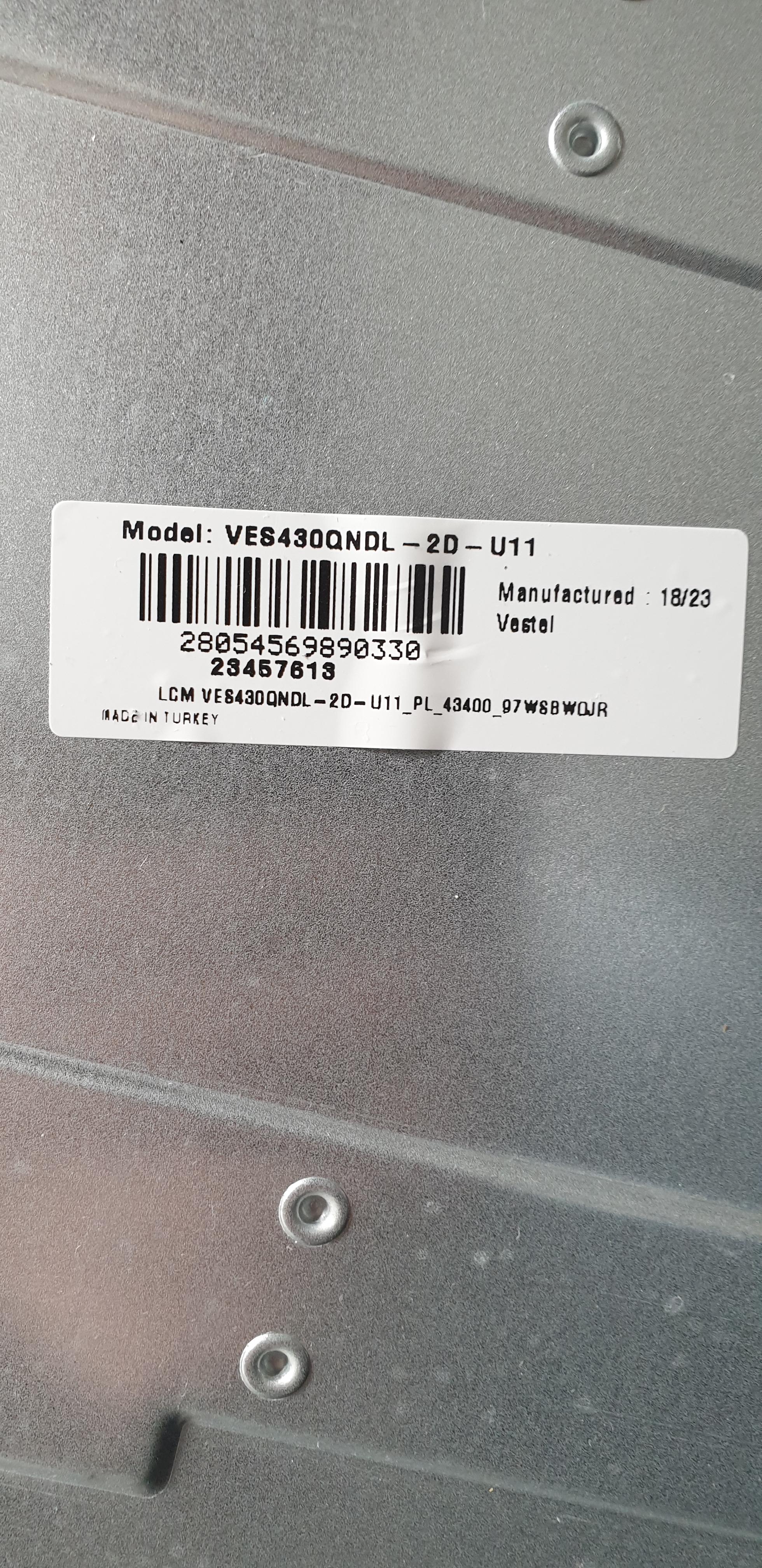

    Hi.
    I'm new to installing firmware.
    I have a Toshiba 43u6863DB with Vestel 17MB130S main board.
    The TV is stuck in a boot loop.
    How do I find out which firmware I need and how do I install it please?
    Many thanks.
    Kris

    if firmware is corrupted you have to use a chip programmer for nand, 96 pin tsop 48, unsolder it read and dump firmware that's corrupted then erase chip program with firmware I've uploaded you can't use a usb stick to fix the issue bootloader has failed, it happens a lot with vestel. only way or buy same board off ebay that works,
