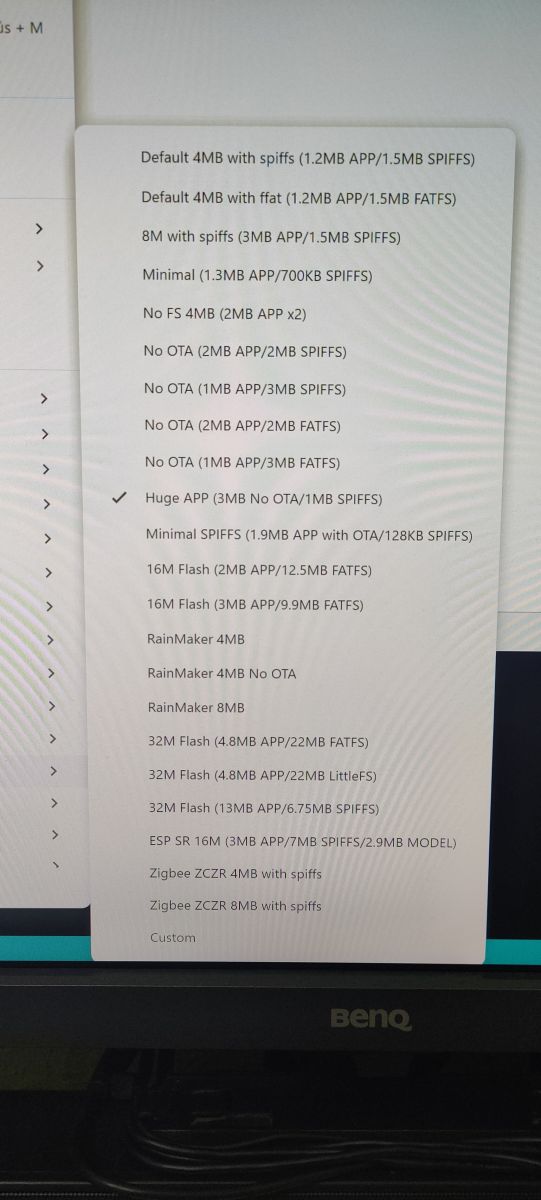

    I've been building an internet radio, the ever so popular YoRadio, for a few days now. I managed to get one working on an ESP32S3N16R8 module but it doesn't quite work properly.
    I have a second ESP32U module and here is the problem. During programming, an error pops up ( I can't remember what it is at the moment but I think it's related to the memory capacity )
    In the Arduino program, the ESP32 Dev Module should be selected and this is what I have selected. But there is a problem with the partition.
    It should be selected:
    Minimal SPIFFS ( 1.9Mb APP WITH OTA/190Kb SPIFFS ) and I don't have this option . It is 1.9Mb but with 128Kb . And here I do not know what to do ?

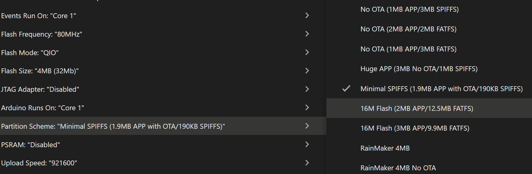

    Which version of Board Manager are you working with? You can check and possibly update. Newer versions have this option (e.g. 3.3).
    • ESP32U - no Minimal SPIFFS option (1.9Mb APP/190Kb SPIFFS) in Arduino IDE, what to choose? Screenshot 2026-01-06 001648.png (68.69 KB) You must be logged in to download this attachment.

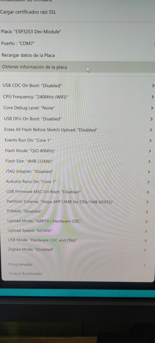

    The Arduino is version 2.3.7 and the ESP 32 I have installed is 3.3.5
    And these are the configuration settings
    ESP32S3 board settings in Arduino IDE with Huge APP option selected ESP32 flash configuration list with Huge APP (3MB No OTA/1MB SPIFFS) selected
    I have on the Huge APP because I was advised to do so

    I have version 3.3.3 installed, as shown in the attachment, and have this desired option.
    wosiekpl wrote:
    you need to select the ESP32 Dev Module and that is what I have selected.
    I see that you have not set to ESP32 Dev Module, but ESP32S3.

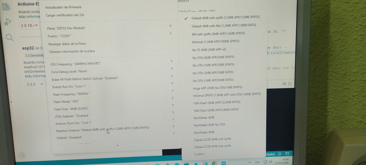

    ESP32 settings menu in Arduino IDE showing expanded Partition Scheme list
    Further the same .

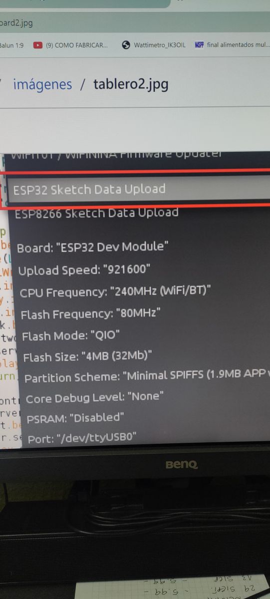

    In the Yoradio loading description it says to load an additional file to make it show up like this picture but I don't know how to do that
    Selected “ESP32 Sketch Data Upload” option in Arduino IDE menu

    As I wrote in version 3.3.3 occurs.
    • ESP32U - no Minimal SPIFFS option (1.9Mb APP/190Kb SPIFFS) in Arduino IDE, what to choose? Screenshot 2026-01-07 214336.png (87.88 KB) You must be logged in to download this attachment.

    Yes, you're right, I was confused by the 3.3.5 in the screenshot
    I have now installed it and it is ok
