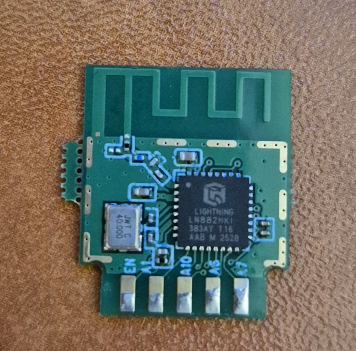

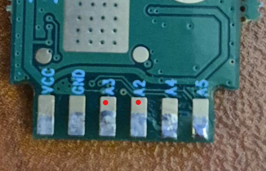

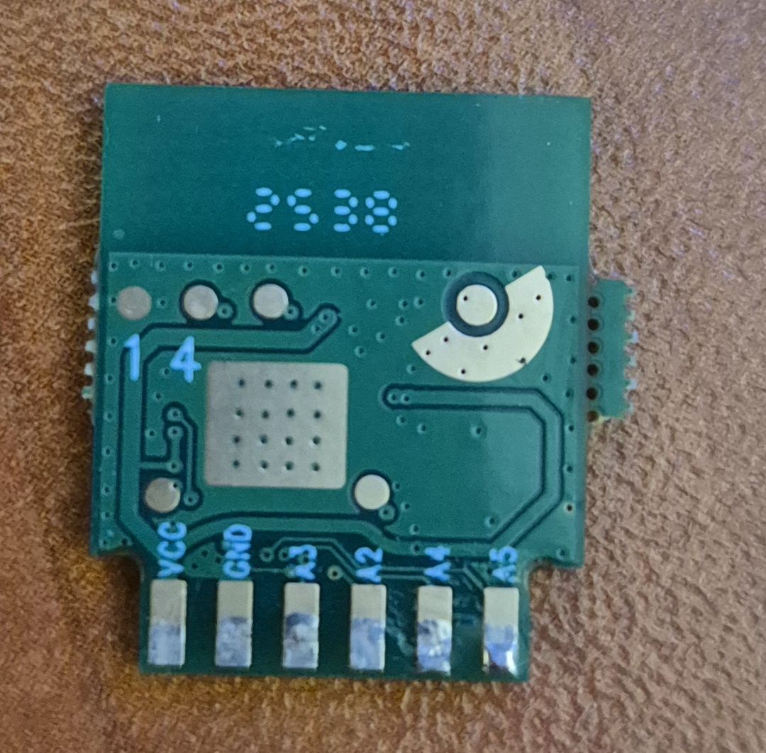

    Has anyone happened to flash the board as shown in the pictures?
    Close-up of PCB with labels A1–A5, GND, and VCC, photographed on a textured surface.
    PCB module with LN882HK1 chip, signal pins labeled A0–A3, EN, and G.
    Girier socket with voltage measurement, freshly taken out of the parcel box straight from the far east.
    https://pl.aliexpress.com/item/1005008248987558.html

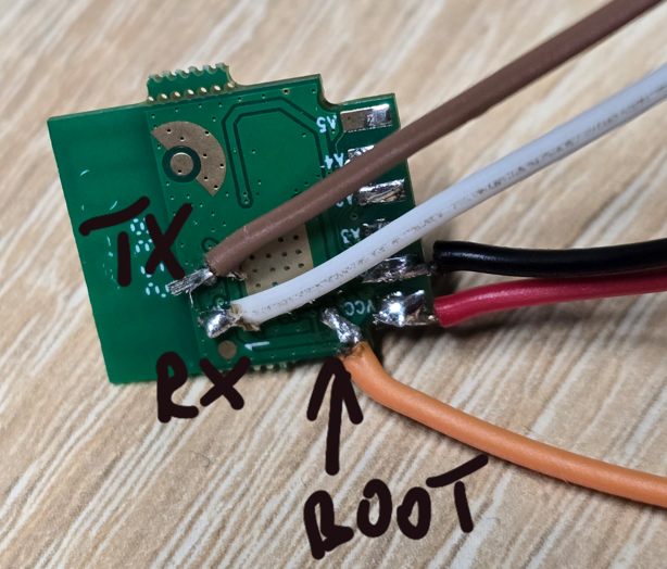

    According to my measurements it came out that the connection of the programmer is as follows:
    PCB module with TX, RX, and BOOT signal wires soldered to pads

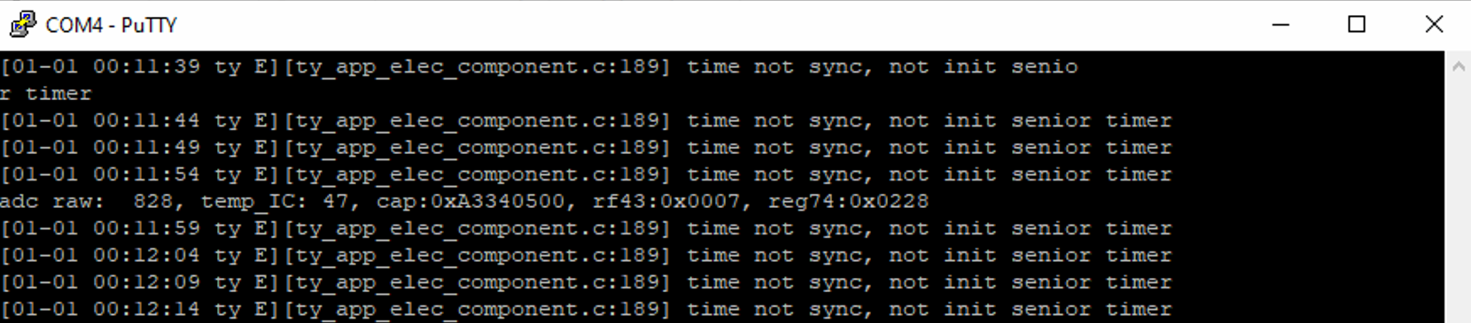

    I connected via putty under COM4 at speed 921000 and I get some messages from the device, that is, it can be assumed that RX/TX are connected correctly.
    When the potential Boot (GPIOA9 according to the chip's schematic) is connected under GND, the default Wi-Fi does not show up and the putty is silent.
    Terminal logs in PuTTY showing repeated time not sync errors

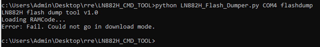

    Yet when I close putty and want to download myself the firmware, I get an error:
    Command prompt showing LN882H_Flash_Dumper.py error: could not enter download mode

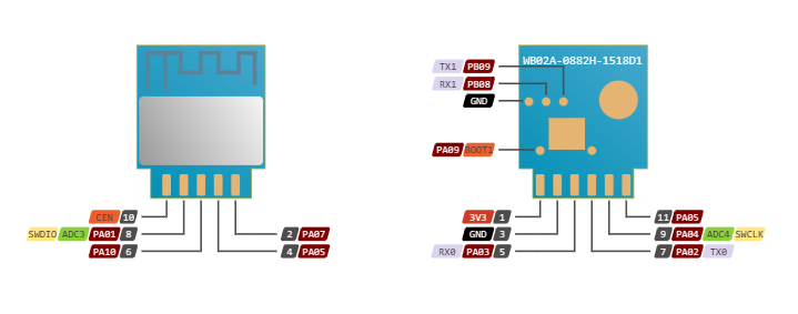

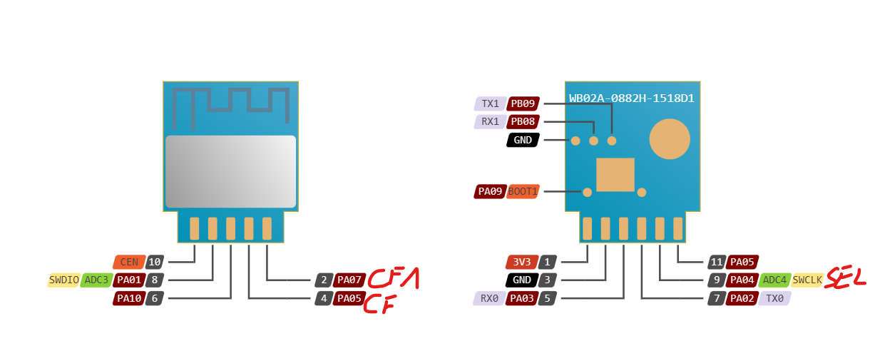

    My board looks twinned with the WB02A:
    Pinout diagrams of WB2S and WB02A modules with GPIO and interface labels
    Except that it doesn't work. :( I have run out of ideas. :)
    I am counting on you. ;)

    [WLIB_I]Disconnected.
    [__tkl_wifi_all_ap_scan-476]wait scan (scan_cnt:2)
    scan complete
    [__tkl_wifi_all_ap_scan-476]wait scan (scan_cnt:3)
    scan complete
    [__tkl_wifi_all_ap_scan-476]wait scan (scan_cnt:4)
    scan complete
    AP cnt:19
    set work mode 1, is open 1, current ln mode: 0
    current work mode 0
    No need to switch mode, mode:0
    [01-01 00:00:06 ty N][lr:0x100a98bb] cur stat:1 0x1006bed5 -->>
    [01-01 00:00:06 ty N][lr:0x100a98f5] wifi netstat changed to:1 -->>
    [01-01 00:00:06 ty N][lr:0x100a990b] report wifi netstat[1] to callback -->>
    [01-01 00:00:06 ty N][ty_app_elec_trigger_network.c:82] --->net state change to:1
    [01-01 00:00:06 ty N][lr:0x100a9449] timer stated, short timer:0x0, long timer:0x100a9289
    [01-01 00:00:06 ty N][lr:0x100bcd03] bt startup attr:ff
    [01-01 00:00:06 ty N][lr:0x10083b23] upd product_id type:0 vd7omhudnl8oyc5j
    xTaskCreate, name: host_main_thread_hdl, priority: 8, stack size: 5120
    [01-01 00:00:06 ty N][lr:0x10083ae5] ty bt sdk init success finish
    [01-01 00:00:06 ty N][lr:0x1007ebe3] Start Adv
    [01-01 00:00:06 you N][lr:0x100a3da3] __devos_init_evt success
    [01-01 00:00:06 you N][lr:0x1007ebe3] Start Adv
    [01-01 00:00:06 you N][lr:0x10083695] ble adv updated
    [tkl_wifi_get_mac:1234] if: 0, mac: 20:f1:b2:36:ab:76
    ble_mac: 77:ab:36:b2:f1:20
    [WLIB_I]In Sniffer mode, do not reinitiate scan!
    [WLIB_I]xtal_temp_cal.curr_sect=3,last_sect=2
    [WLIB_I]==>temp_sect:3,phy_tab_1f:0x60,phy_tab_20:0x50
    [WLIB_I]<==temp_sect:3,phy_tab_1f:0x60,phy_tab_20:0x50
  • A2/A3 with A9 grounded enables LN882H flashing
    #3 21804566
    Mad_Maxs
    Posts: 81
    divadiow wrote:
    A2 (TX0) and A3 (RX0) should be used to upload / download flash memory with A9 grounded
    The worst thing is that I had this idea for a while yesterday, but the train of thought went the other way and I forgot to try it :facepalm
    After soldering according to your indications, the dump started immediately :) in download mode, putty is still silent (by the way I checked ;) )
    divadiow wrote:
    Easy Flasher now supports LN882H backup/flash - this will be much faster than the scripted method https://github.com/openshwprojects/BK7231GUIFlashTool/releases
    Not only does it support LN882H but it is also not detected as a virus by ESET ;)
    Everything came in nicely, it remains to solder it into the socket and identify the GPIO
  • Swapping BL0937 CF and CF1 fixes power reading
    #4 21806315
    Mad_Maxs
    Posts: 81
    However, something has changed, relative to the same socket but on the WL2S because at my place the relay was on 5, so it currently looks like this:
    "pins": {
    "0": "LED;0",
    "3": "Btn;0",
    "5": "Rel;0",
    "7": "BL0937CF1;0",
    "10": "LED_n;0",
    "12": "BL0937CF;0",
    "19": "BL0937SEL;0"
    Unfortunately the voltage reading was going crazy. By default it showed 1.5-2V, after using calibration it jumps between 150 and 1308, so probably something would have to be messed with the pins from BL0937 :) Question is there a patent for this, or again a multimeter?
    Added after 2 [hours] 8 [minutes]:
    The multimeter gave this result:
    Connection diagram of WB02A module with assigned CF, CF1, and SEL pins
    How to translate this to the pins now ? :)
    This is how the multimeter on the LN882N chip sees it:
    "12": "BL0937SEL"
    "14": "BL0937CF"
    "15": "BL0937CF1"
    When I put this in the pin settings the socket reboots, so that's not the way to go ;)
    Added after 1 [hour] 23 [minutes]:
    I swapped the CF and CF1 places and now I have a correct POWER reading, but no voltage reading at all. This confirms the theory and the misassigned pins ;)
    The current setup is:
    "pins": {
    "0": "LED;0",
    "3": "Btn;0",
    "5": "Rel;0",
    "7": "BL0937CF;0",
    "10": "LED_n;0",
    "12": "BL0937CF1;0",
    "19": "BL0937SEL;0"

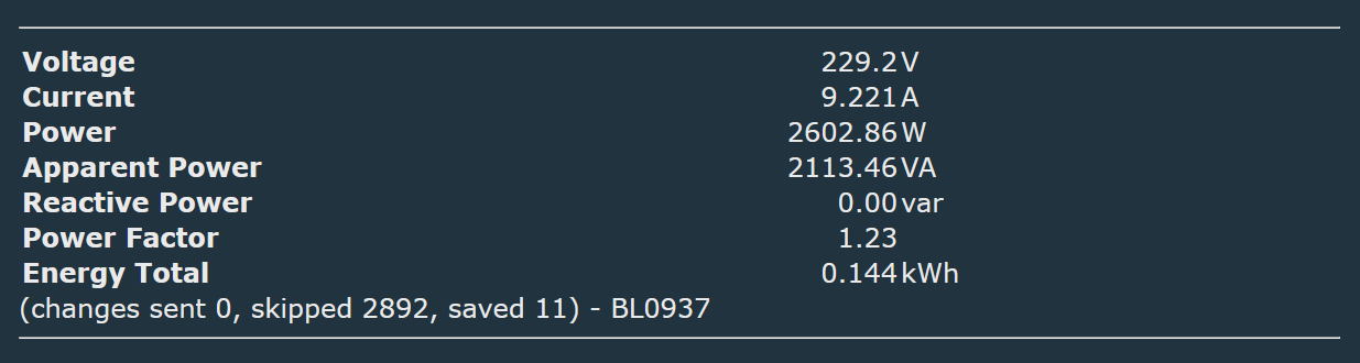

  • Power readings disagree with voltage-current calculation
    #5 21807235
    Mad_Maxs
    Posts: 81
    There is a breakthrough, because I have the readings, but somehow I don't like them.
    Voltage*current versus power measurement, has quite a big discrepancy:
    Screenshot of voltage, current, and power readings from a BL0937 chip
    The connected radiator is rated at 2000W, so something is wrong with the power measurement. A matter of calibration alone from Toolsa, after careful verification?
    Sorry, it's not clear to me: did you calibrate the plug?
    If the radiator is a simle resistive load, there should be no (big) difference between power and apparent power...
