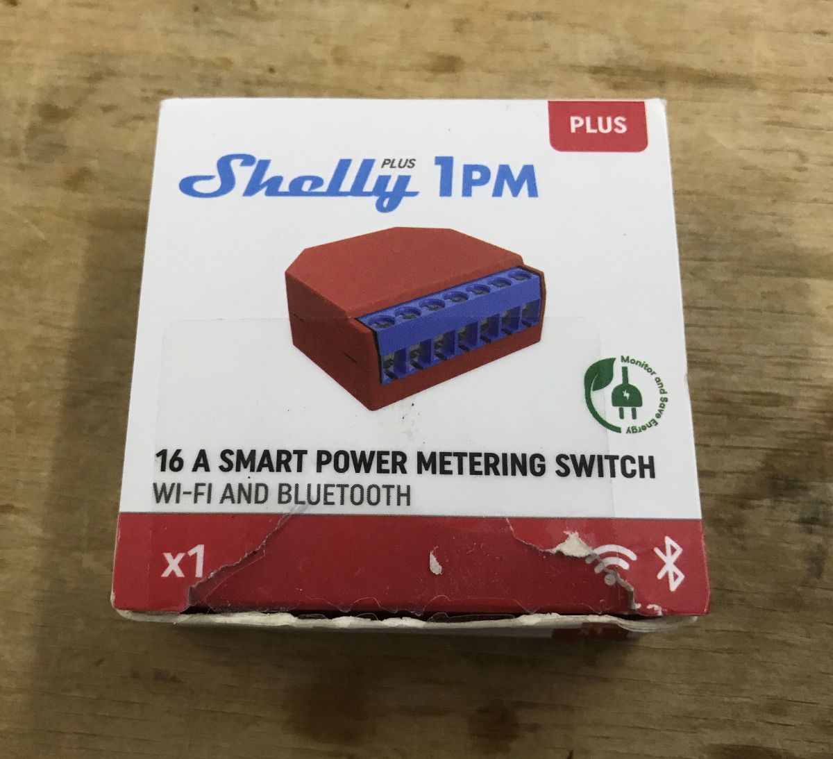

    This relay with Wi-Fi control does not need to be programmed - everything can be connected to Home Assistant from the factory, and even additional sensors are supported. I invite you to a short test of the Shelly Plus 1PM, which offers single-receiver control, one-button operation, energy measurement and convenient configuration even without a mobile app.
    The gadget itself is quite cheap, you can buy it for around PLN50, admittedly Tuya is cheaper, but maybe it's worth it? Let's check.
    Let's start with the packaging and contents of the kit.
    Shelly Plus 1PM product box on a wooden surface, showing the module image and “Wi‑Fi and Bluetooth” text. Side of a product box listing features like power metering, Bluetooth, and Wi‑Fi 802.11 b/g/n Side of a white Shelly box with www.shelly.com, app store icons, and a QR code

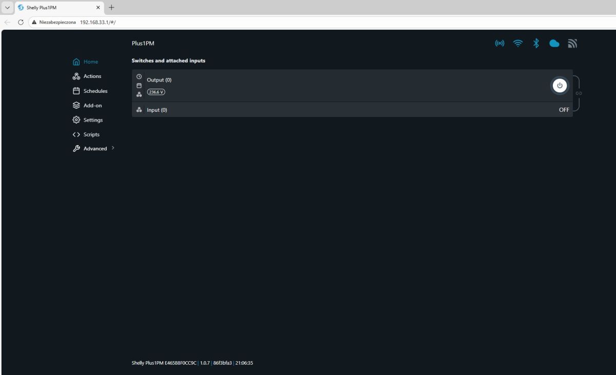

    Shelly Cloud is not mandatory. You don't need a phone either. You can configure from your computer, you first need to connect to the device's AP network:
    Header with Wi‑Fi icon and the name “ShellyPlus1PM‑EA65B8F0CC9C”
    The control and configuration page is at 192.168.33.1.
    Screenshot of Shelly Plus 1PM web UI showing Output toggle and 236.6 V voltage reading
    There we can enter the location of our Wi-Fi and pair the device with our router.
    What immediately strikes us there is the large number of configuration options. Let's start perhaps with the button and the relay - the button can be bistable or monostable, you can also disconnect its logic from the relay. We also control the state of the device after restarting.

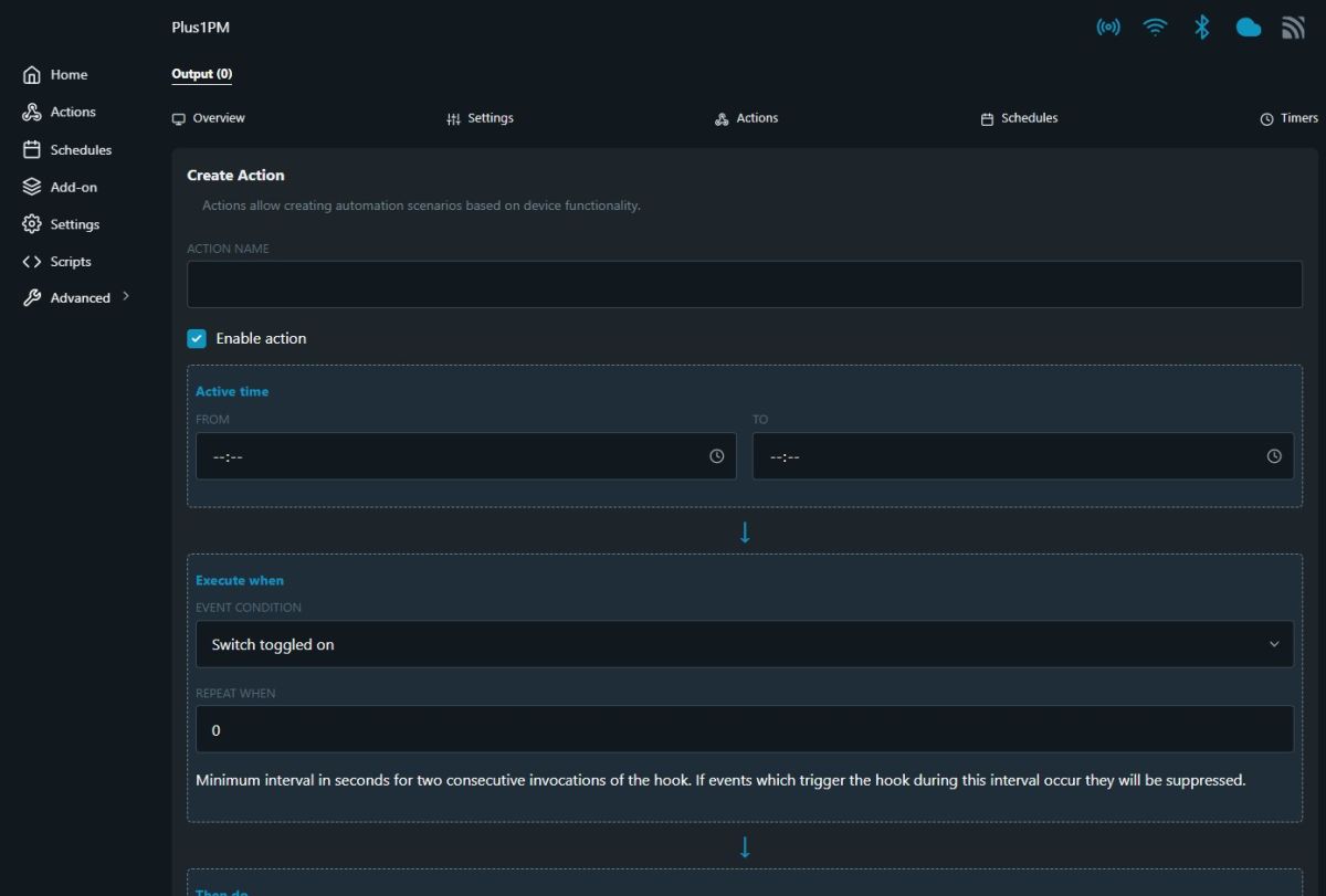

    The device also allows you to create scriptable actions - they are triggered by an event, the action can only run at a given time. One of the effects of the action can even be a URL call.
    Screenshot of Shelly Plus 1PM web UI showing the “Create Action” automation form “Add local action” dialog with “Control Output” selected and output state On/Off options Screenshot of Shelly automation page with “Switch toggled on” trigger and “Hit URL” action

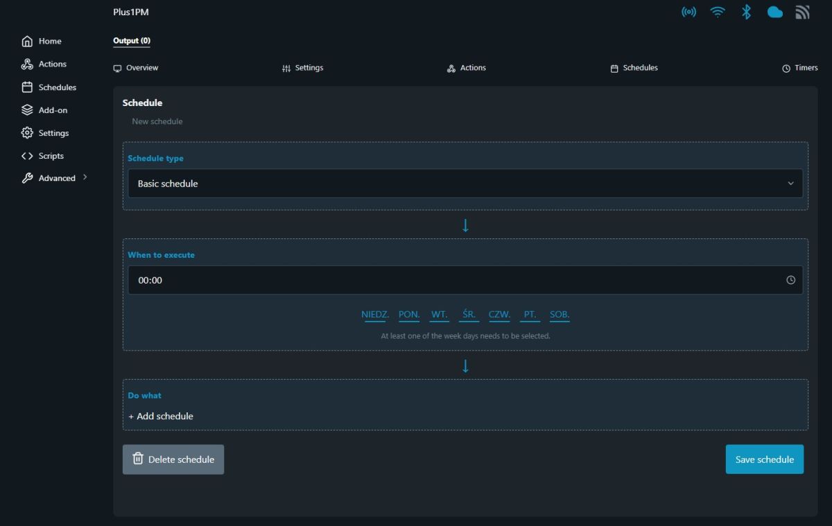

    In a similar way, events can be triggered according to a calendar. We simply set when and what. We can choose between hours, minutes and days of the week. In addition, we have timers - actions after a given time.
    Shelly Plus 1PM web UI showing a schedule setup with 00:00 time and weekday selection Screenshot of the Shelly Plus1PM web panel showing Auto ON and Auto OFF timer settings

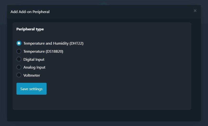

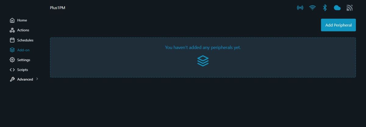

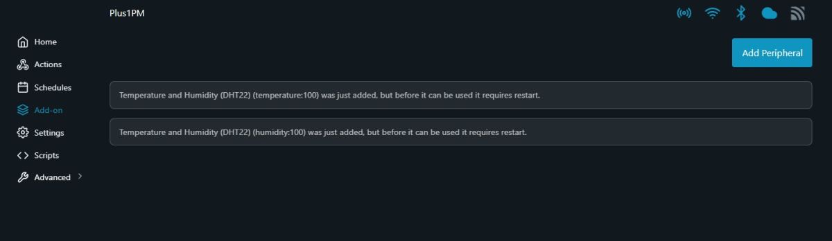

    What caught my eye most, however, was the Peripherals tab. Extras. There you can add.... external sensors, such as DHT22, DS18B20, or there simply an additional digital input, analogue input or voltage measurement.
    Shelly Plus 1PM web UI showing Add-on tab, DHT22 added messages, and an Add Peripheral button Screenshot of the Shelly Plus 1PM web UI, Add-on tab showing no peripherals added “Add Add-on Peripheral” dialog with peripheral type list, DHT22 selected, and a “Save settings” button

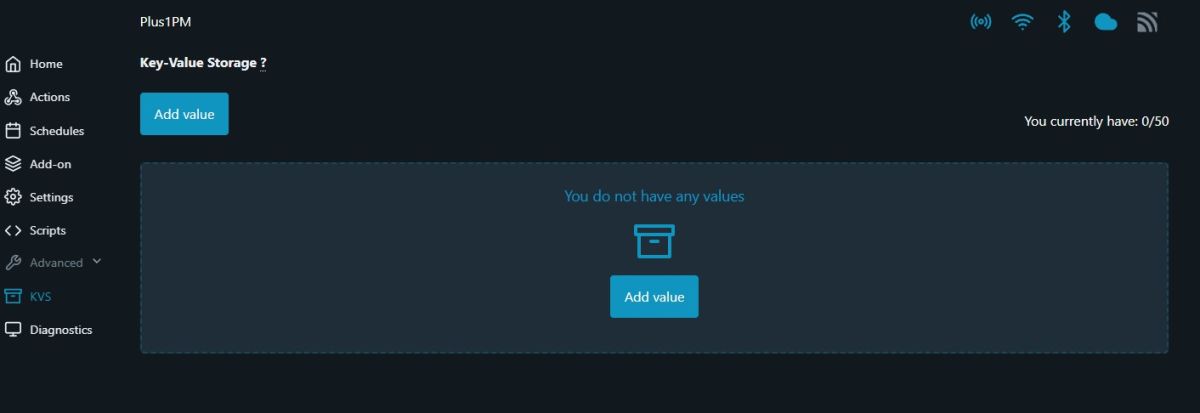

    Key-value record in flash (key-value pairs, probably for settings - limit 50):
    Shelly Plus1PM web UI screenshot: Key-Value Storage page with “Add value” button

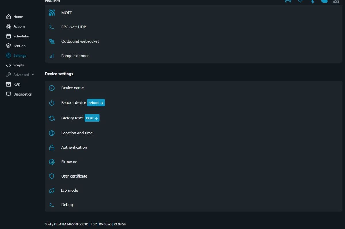

    Finally, we have firmware, device, factory reset and update information, among others:
    Screenshot of Shelly Plus 1PM web UI showing Settings and device reset/firmware options Screenshot of Shelly Plus 1PM web panel showing firmware info and update options

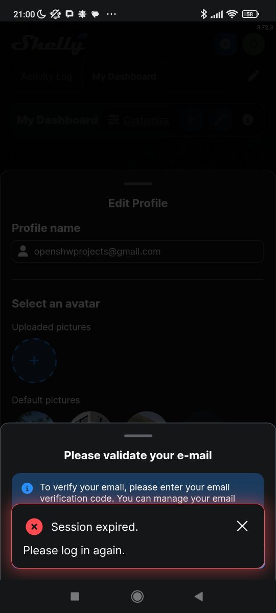

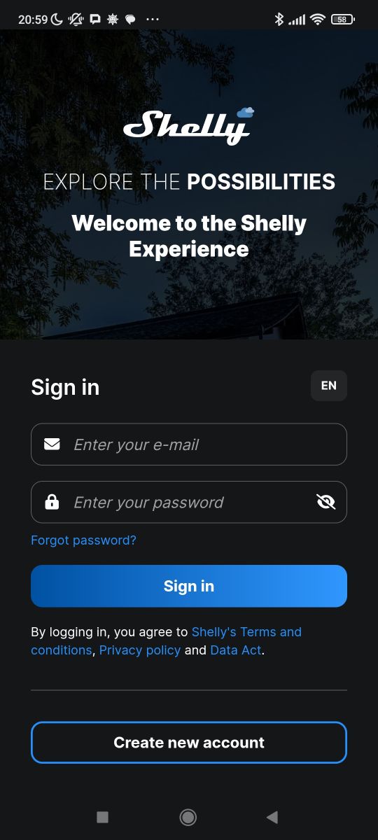

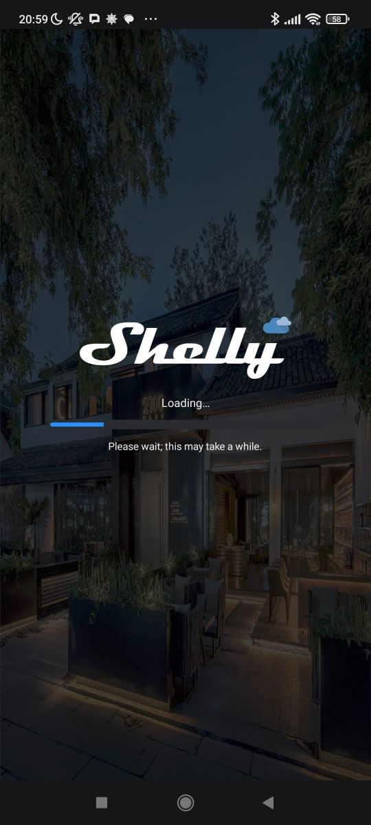

    I downloaded the app from Google Play. The app requires registration and confirmation of an email address, but is not problematic. It is possible to create an account without providing a phone number.
    Phone screen showing Shelly app splash screen with “Loading… Please wait”. Shelly app sign-in screen with email and password fields and a “Sign in” button. Session expired message in Shelly app with email verification prompt
    I was a bit surprised by the session expiry message, after all I had just registered, but I understand that there can be minor bugs in the application.

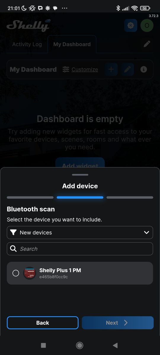

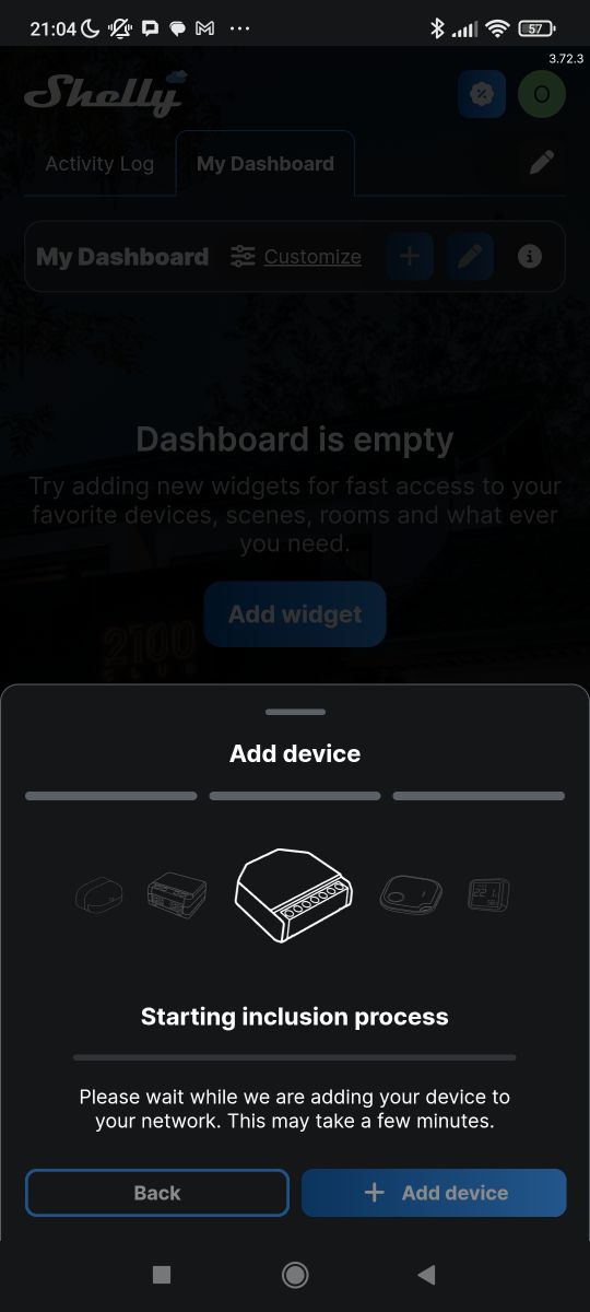

    After a while I got access to the panel where you can add a new device. Turn on Bluetooth on the phone and Shelly is already visible:
    Shelly app home screen showing an empty My Dashboard panel Add Device screen in Shelly app with Bluetooth, Wi-Fi (AP Scan), and network scan options Shelly app screen showing Shelly Plus 1PM detected via Bluetooth

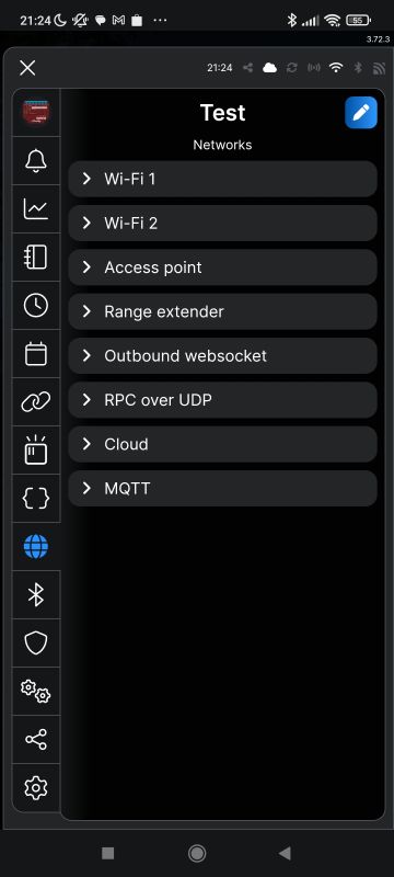

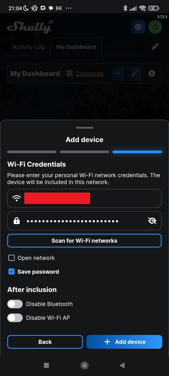

    Next we have pairing with Wi-Fi - this is to get the device on our LAN. And there are surprises here too - for example, we can decide whether the device will leave its access point open after pairing. This is another convenient feature.
    Shelly device setup screen with Wi-Fi credentials input fields Shelly app screen during the process of adding a new device to the network Shelly app screen showing device addition with room selection “Test”

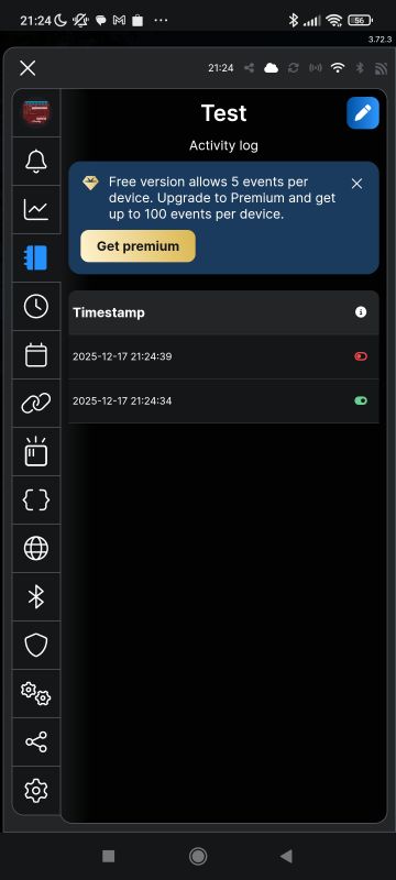

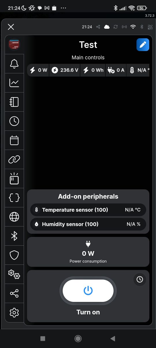

    The first thing that caught my eye in the app was the measurements from the device. It also shows the failed readings from the DHT sensor, which I added via the web panel. The sensor is only added in the application, it is not connected to the device, so the hardware has no way to read the data. Activity history is also available.
    Shelly app screen with connected device showing 236.6 V and 0 W power Shelly app screen showing Test panel with relay control and sensor data Shelly app activity log screen showing event limit warning for free version

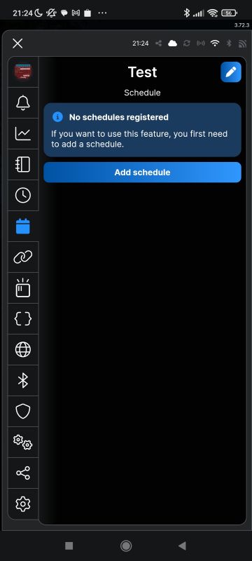

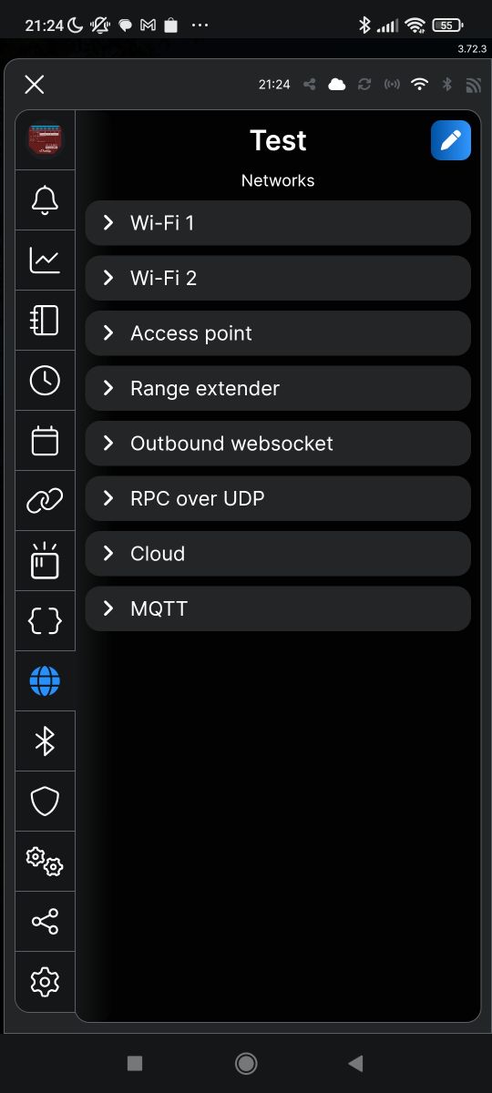

    The app largely reflects what is on the configuration page.
    Screenshot of the Shelly app showing timer settings with auto on/off options Shelly app screen showing empty schedule tab and an option to add schedule Shelly app screen showing network and cloud settings in dark mode

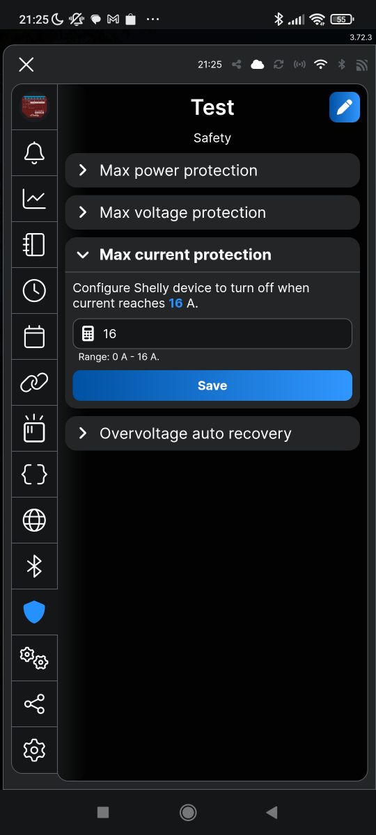

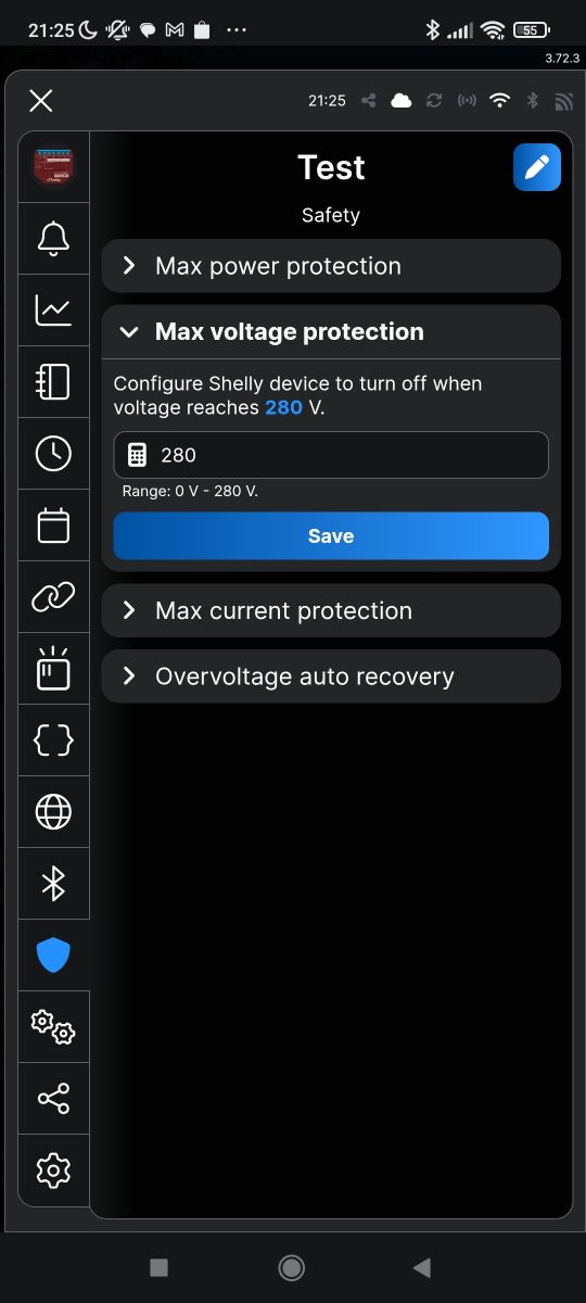

    One of the more useful features I've missed before is over-power/current/voltage protection. I'm just wondering how quickly this responds if it's implemented in firmware.
    Shelly app screen showing power protection limit set to 4480 W Shelly app screen showing a 16 A current limit set in the safety configuration Shelly app screen showing voltage protection settings and save button.

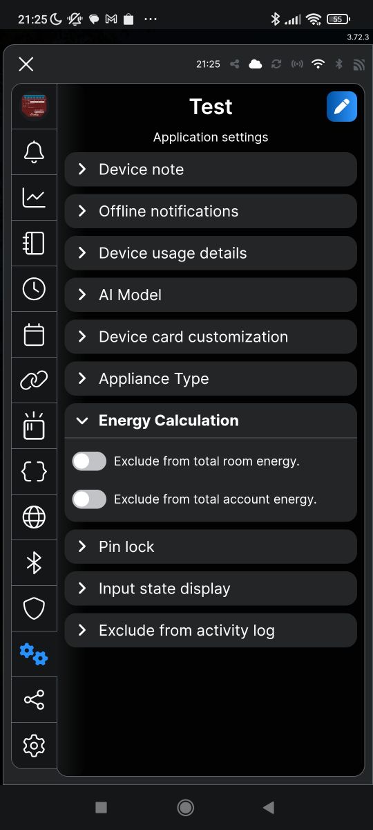

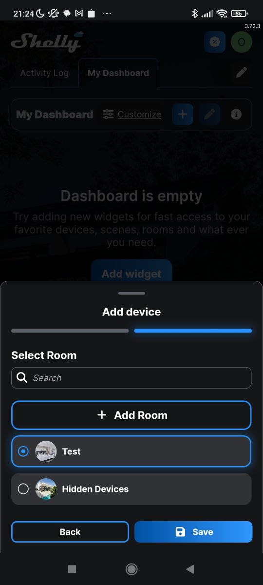

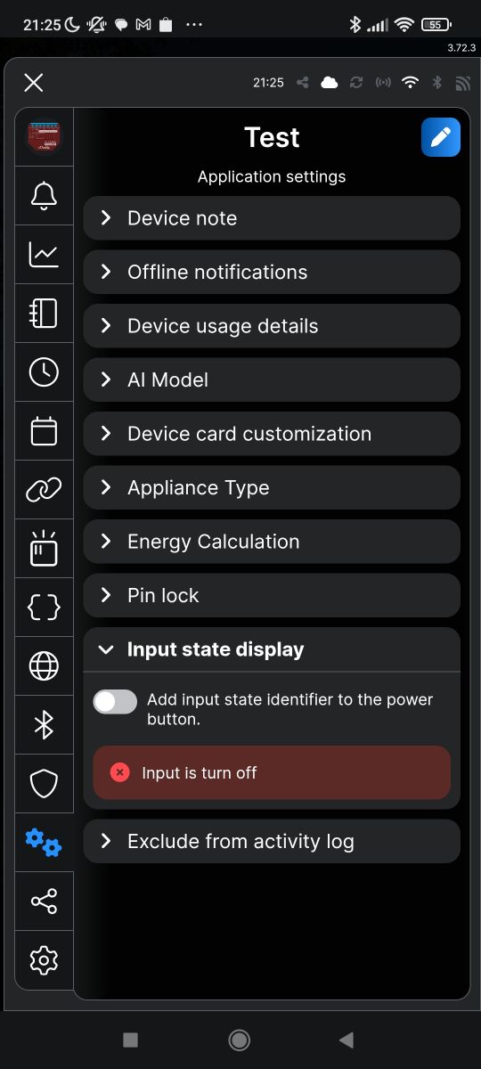

    In addition, there are already more 'cloud-based' options, for example room settings or there way of counting energy:
    Shelly app settings screen showing configuration options for a Wi-Fi device Shelly app settings panel showing device options and energy tracking toggles Device type settings screen in the Shelly app with Other option selected

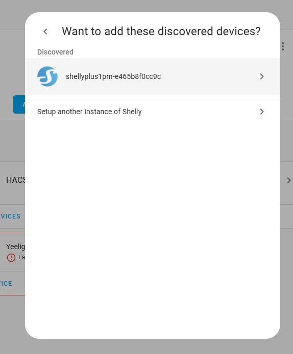

    Pairing with Home Assistant is really quite simple. All you need to do is add the Shelly integration. We search for it in Settings->Integrations:
    Home Assistant integration menu showing Shelly brand selection and detected devices.

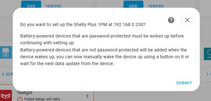

    The integration itself will find Shelly devices on our local network. Only we need to remember to connect Shelly to our Wi-Fi beforehand:
    Screen of adding Shelly Plus 1PM device in Home Assistant interface
    We confirm the configurations:
    Setup prompt for Shelly Plus 1PM with IP address and notes on battery-powered devices

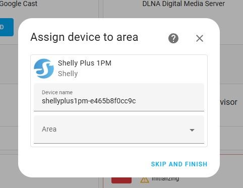

    We assign a zone for the device:
    Home Assistant window assigning Shelly Plus 1PM device to an area

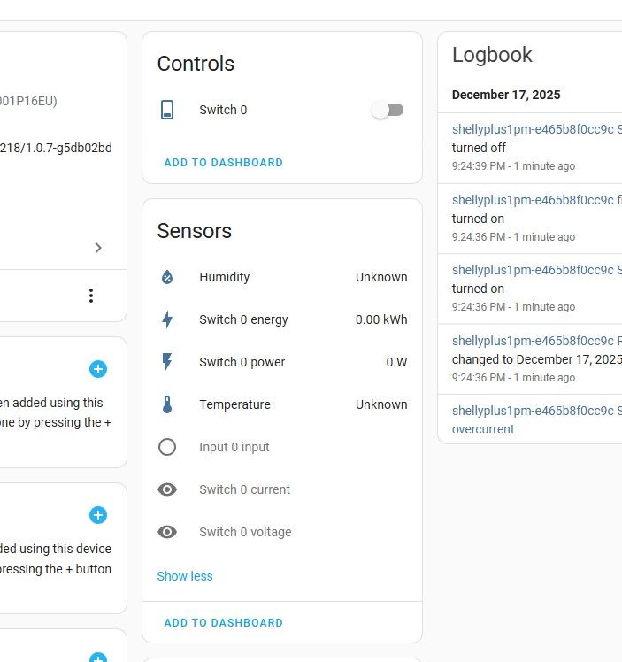

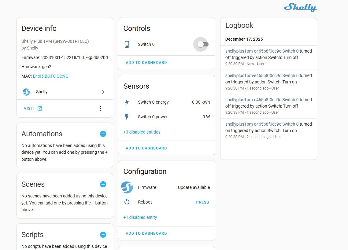

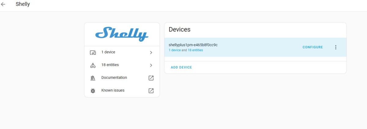

    From now on, in Shelly, our switch will be visible in the devices:
    Shelly integration screen in Home Assistant with one device and 18 entities
    You can take a look at his page. There we have control of his relay, measurements and even a button to restart and the status of exceeded limits (power, voltage, current):
    Shelly Plus 1PM device panel in Home Assistant interface Shelly Plus 1PM control panel with device info and switch activity log
    Shelly Plus 1PM control and diagnostics panel with scenes, scripts, and device status Shelly Plus 1PM control panel in Home Assistant showing sensor data and switch history
