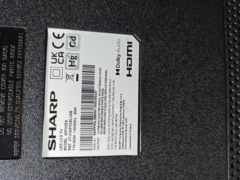

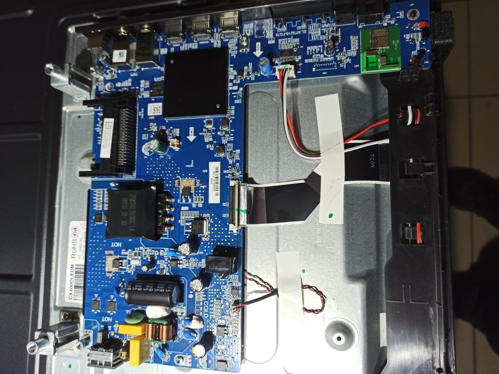

    Hello Colleagues.
    I have this TV,
    and probably needs software.
    The problem he has is
    that I open it
    and pulls out the logo Sharp, and immediately goes
    on standby, and then if
    I unplug it
    and I put it again it does the same.
    If anyone can help me,
    Thanks in advance.
    • Sharp LED LCD TV Model: 40FH2EA Stuck on Logo Then Standby—Possible Software Issue and Restart Loop 1770109818433.jpg (356.71 KB) You must be logged in to download this attachment.
    • Sharp LED LCD TV Model: 40FH2EA Stuck on Logo Then Standby—Possible Software Issue and Restart Loop 17701098184.jpg (379.26 KB) You must be logged in to download this attachment.
    • Sharp LED LCD TV Model: 40FH2EA Stuck on Logo Then Standby—Possible Software Issue and Restart Loop 1770109818.jpg (320.21 KB) You must be logged in to download this attachment.
    • Sharp LED LCD TV Model: 40FH2EA Stuck on Logo Then Standby—Possible Software Issue and Restart Loop 18457.jpg (336.28 KB) You must be logged in to download this attachment.
    • Sharp LED LCD TV Model: 40FH2EA Stuck on Logo Then Standby—Possible Software Issue and Restart Loop 1770117575859.jpg (486.76 KB) You must be logged in to download this attachment.

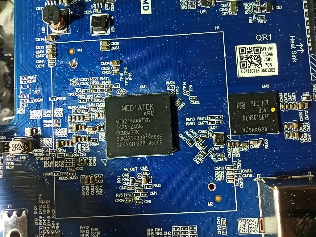

  • #3 21828072
    drechu11
    Posts: 131
    Help: 5

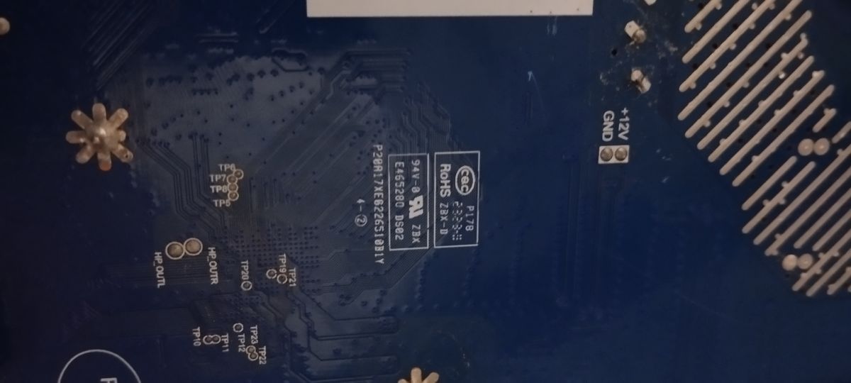

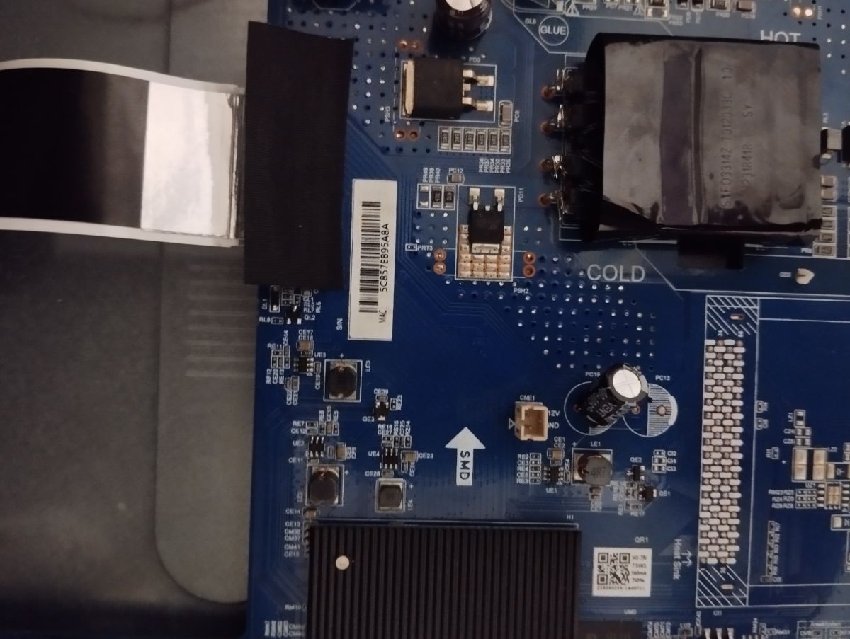

    Remove the heatsink and show what memory is sitting
  • #4 21828200
    emman
    Posts: 28
    Good evening to you.
    I am sending you the photo first
    of the memory you asked of me.
    Now I am downloading the software
    that you sent me.
    I will install it and I will tell you
    if it works.
    I want to tell you a big one:
    Thank you for your interest.
    • Sharp LED LCD TV Model: 40FH2EA Stuck on Logo Then Standby—Possible Software Issue and Restart Loop 1770142094769.jpg (503.63 KB) You must be logged in to download this attachment.

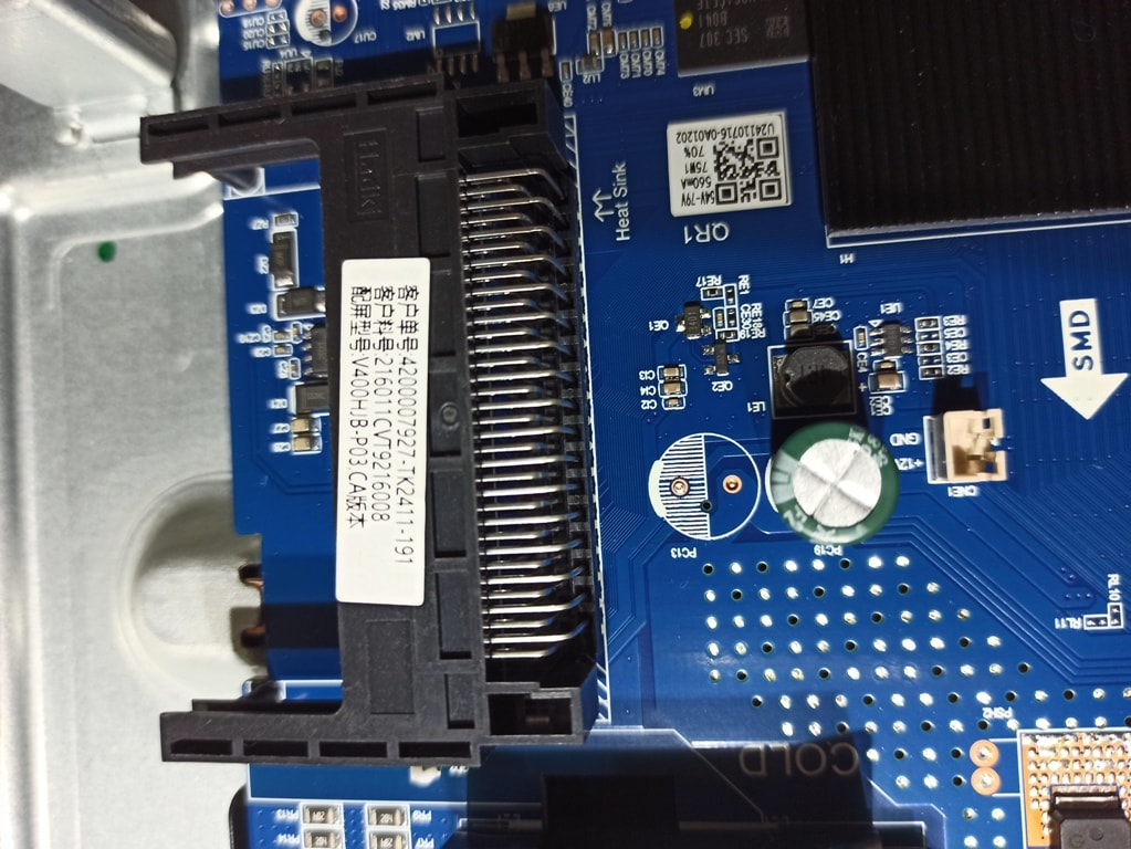

  • #6 21828508
    jeloi
    Posts: 1739
    Help: 284
    Rate: 578
    EL.MT9216-FG75
    V400HJB-P03

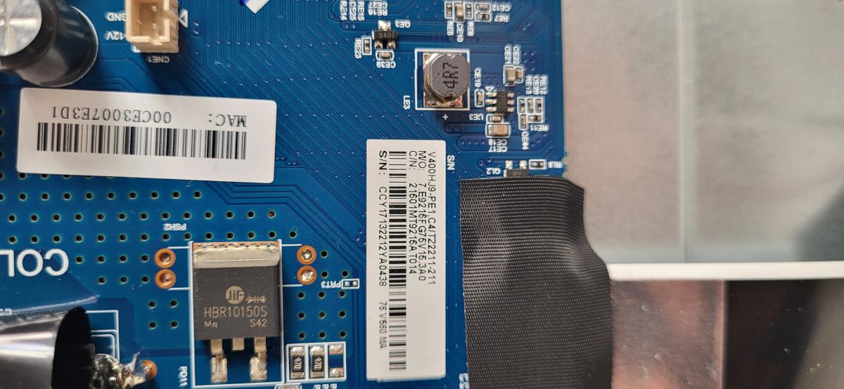

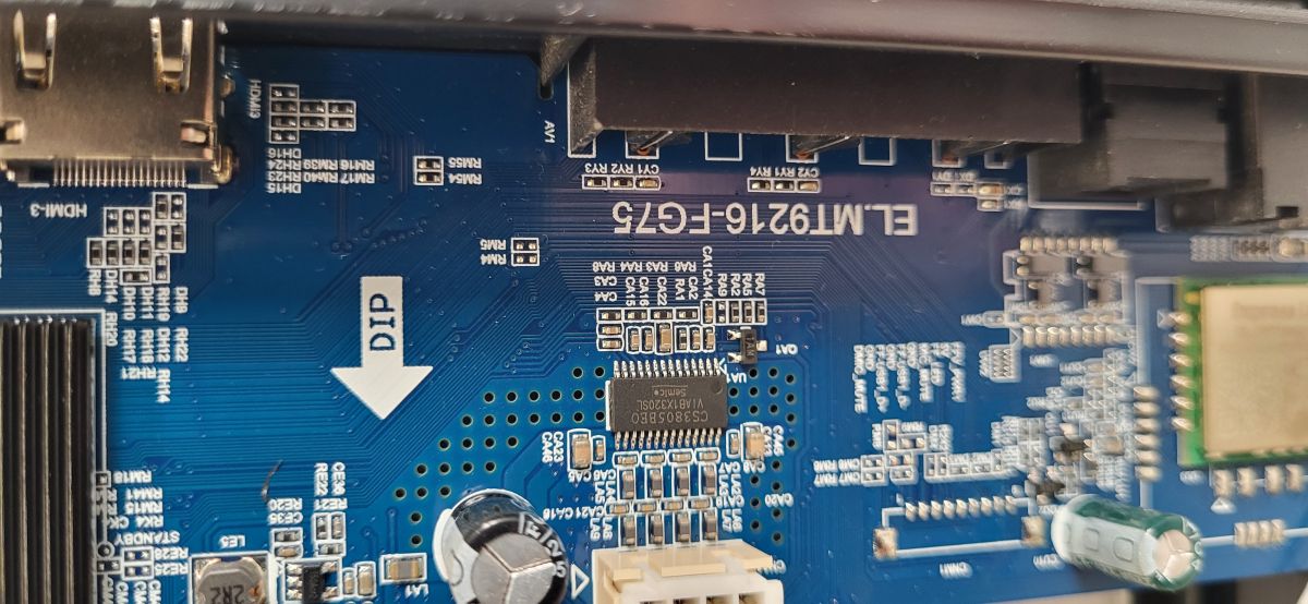

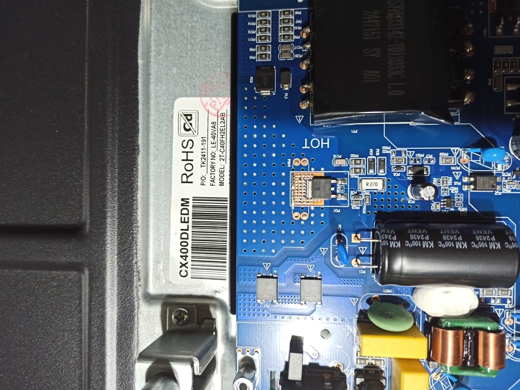

  • #9 21830634
    nekefi
    Posts: 17

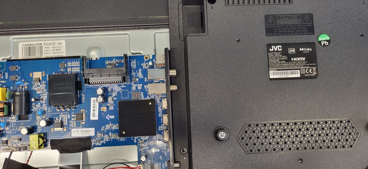

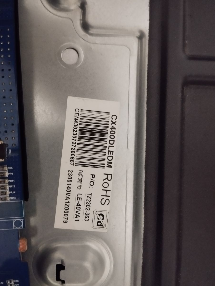

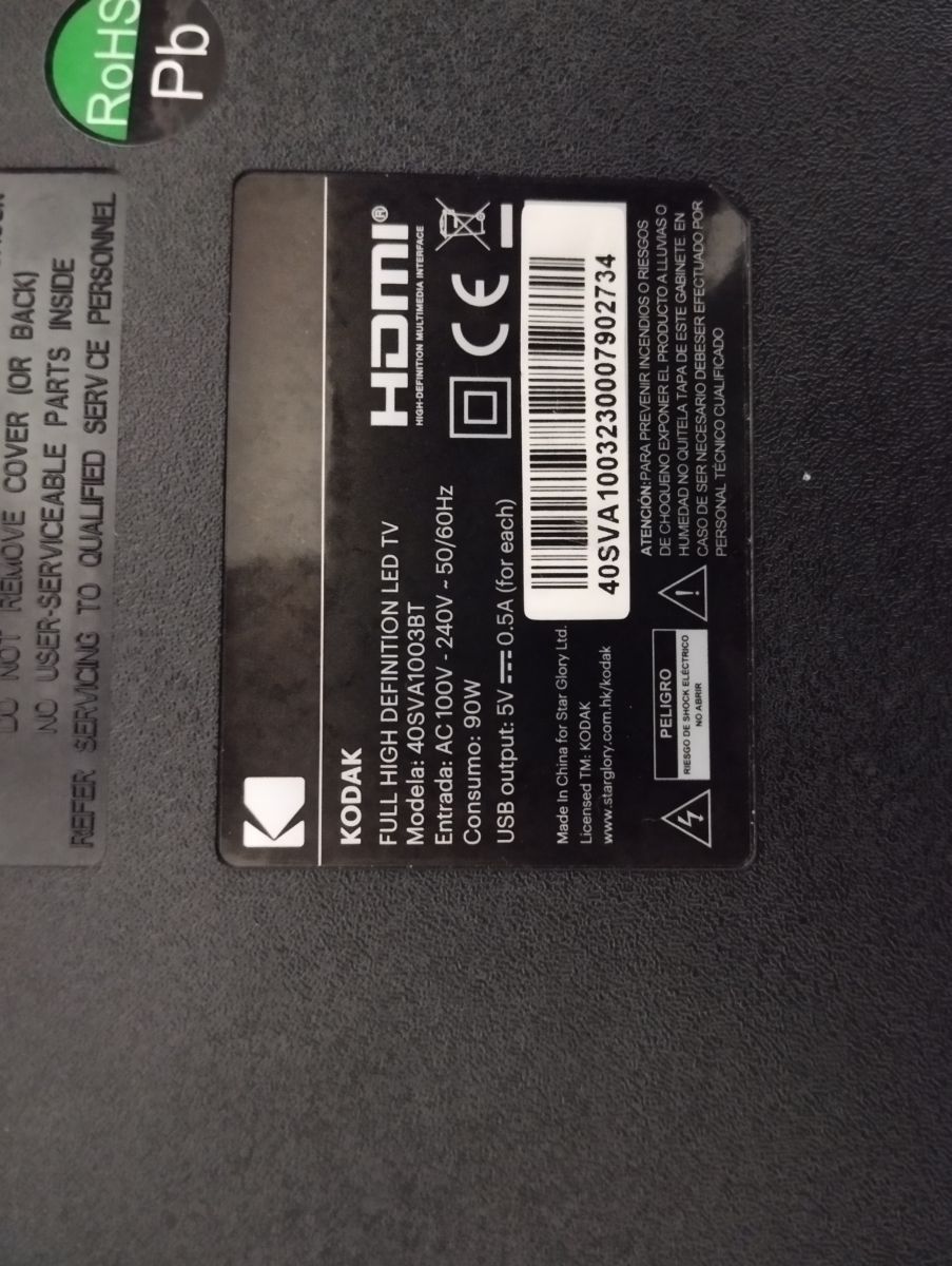

    May I use it for JVC with the same problem?
    Inside a TV: main circuit board and power components on the left, JVC back cover with label on the right

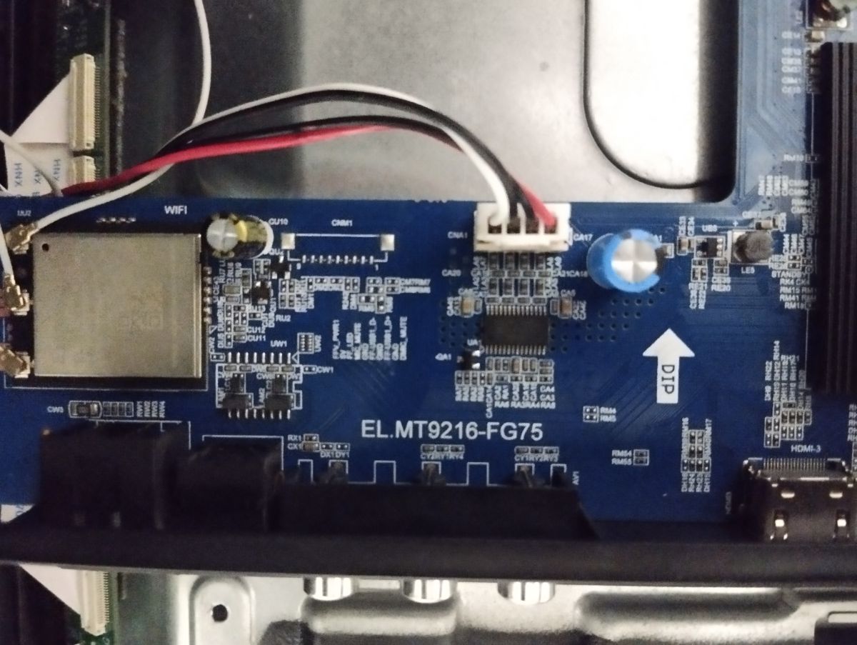

  • #10 21830738
    billobirillo
    Posts: 1082
    Help: 328
    Rate: 738
    >>21830634
    mainboard is EL.MT9216-FG75?
    panel code (I can't read the label well) is V400HJ9-PE1 C4?
    the software I linked is for another panel: you need another one that I can provide
    the software might work
    but you might be have problems with the remote control: in this case, you should replace it with a Sharp one.

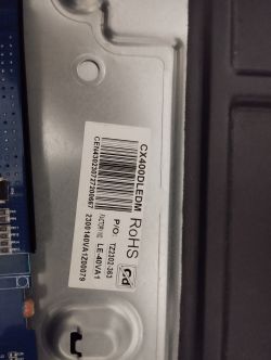

  • #11 21830786
    nekefi
    Posts: 17
    >>21830738
    Thank you very much for your response, billobirillo, and sorry for the bad pictures.
    I hope the new ones help more!!
    About the remote control I don't mind, I gave it a try despite that but it seems not to accept it and does not start the update procedure, just stays at logo.
    Thanks in advance!!!
