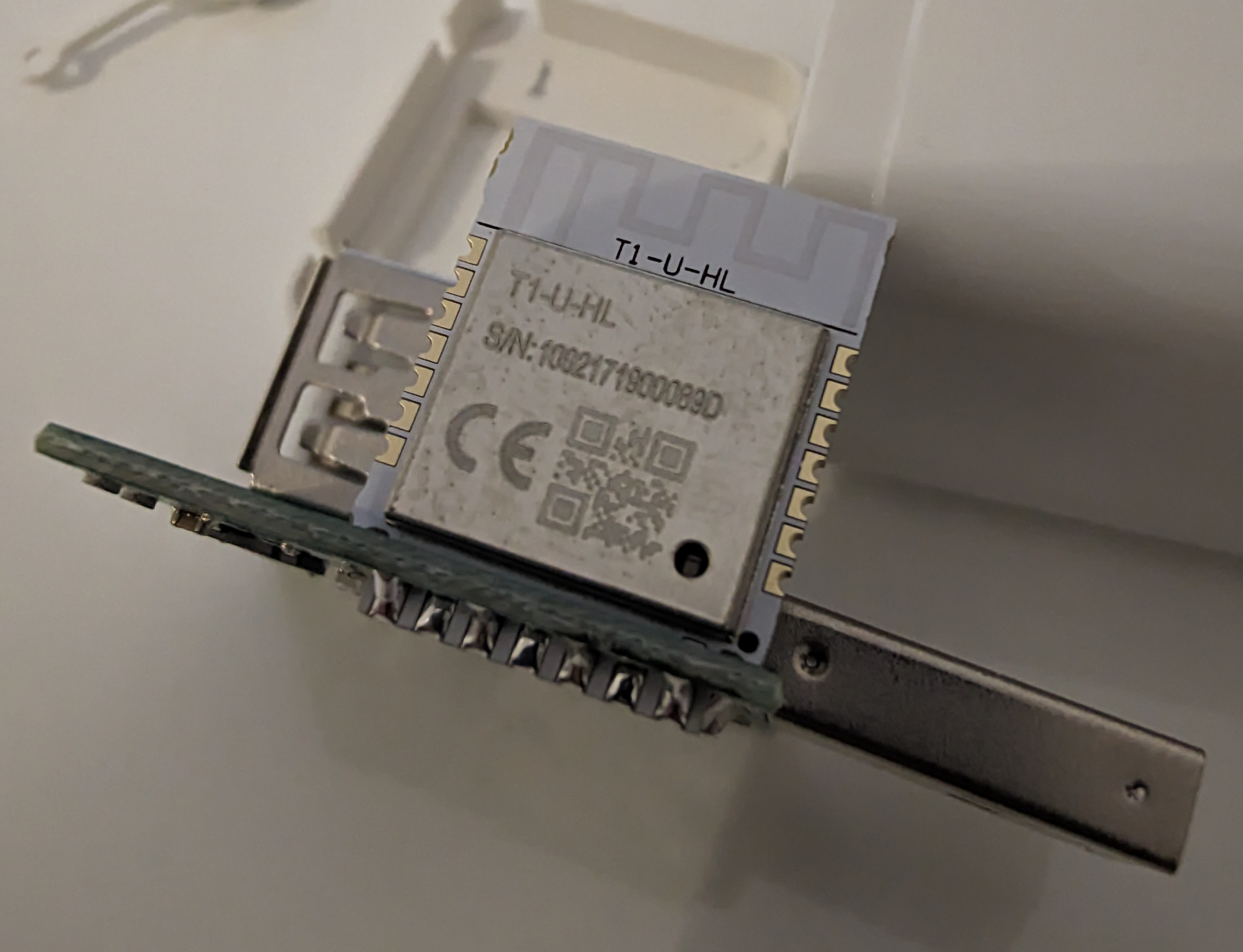

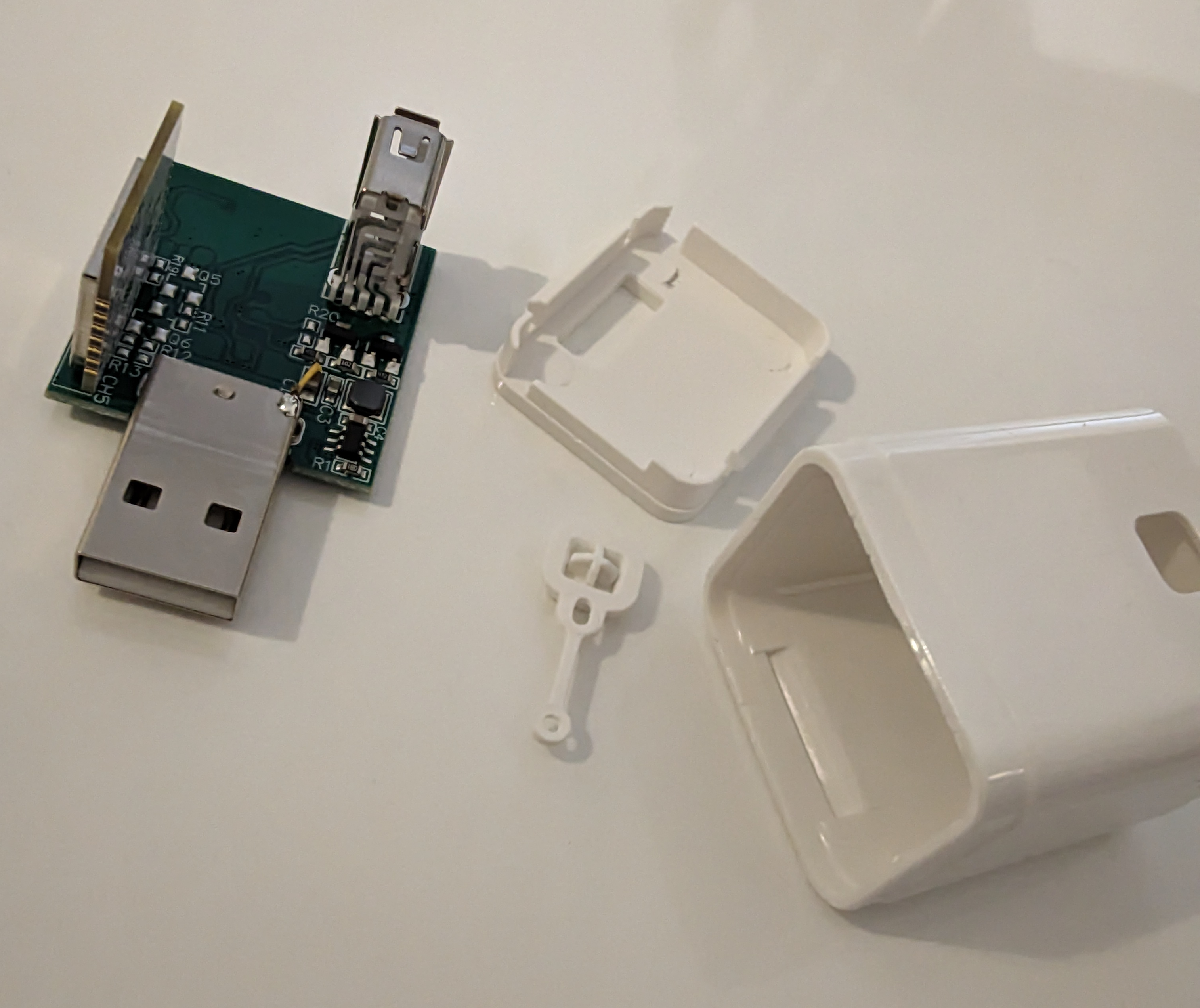

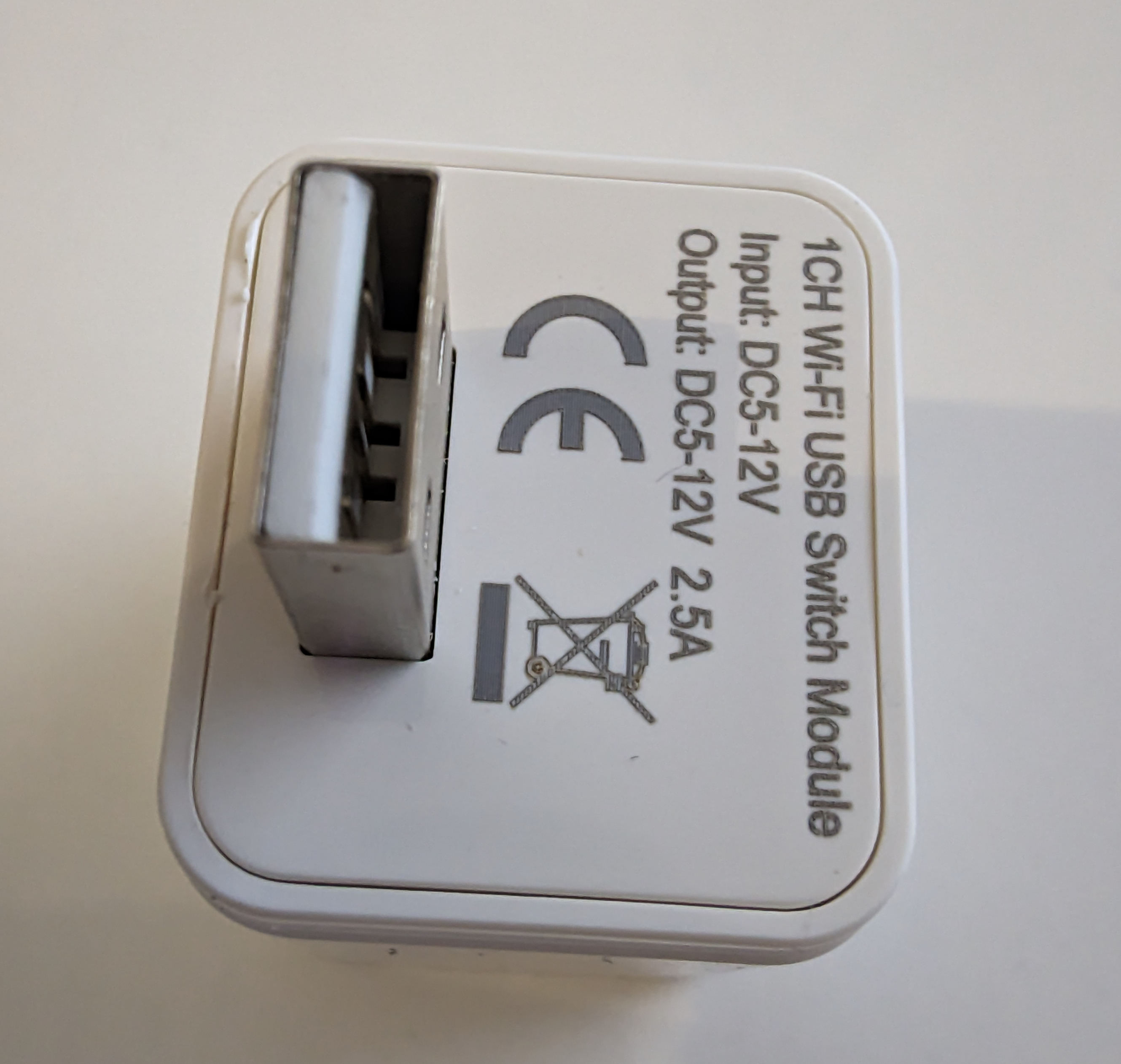

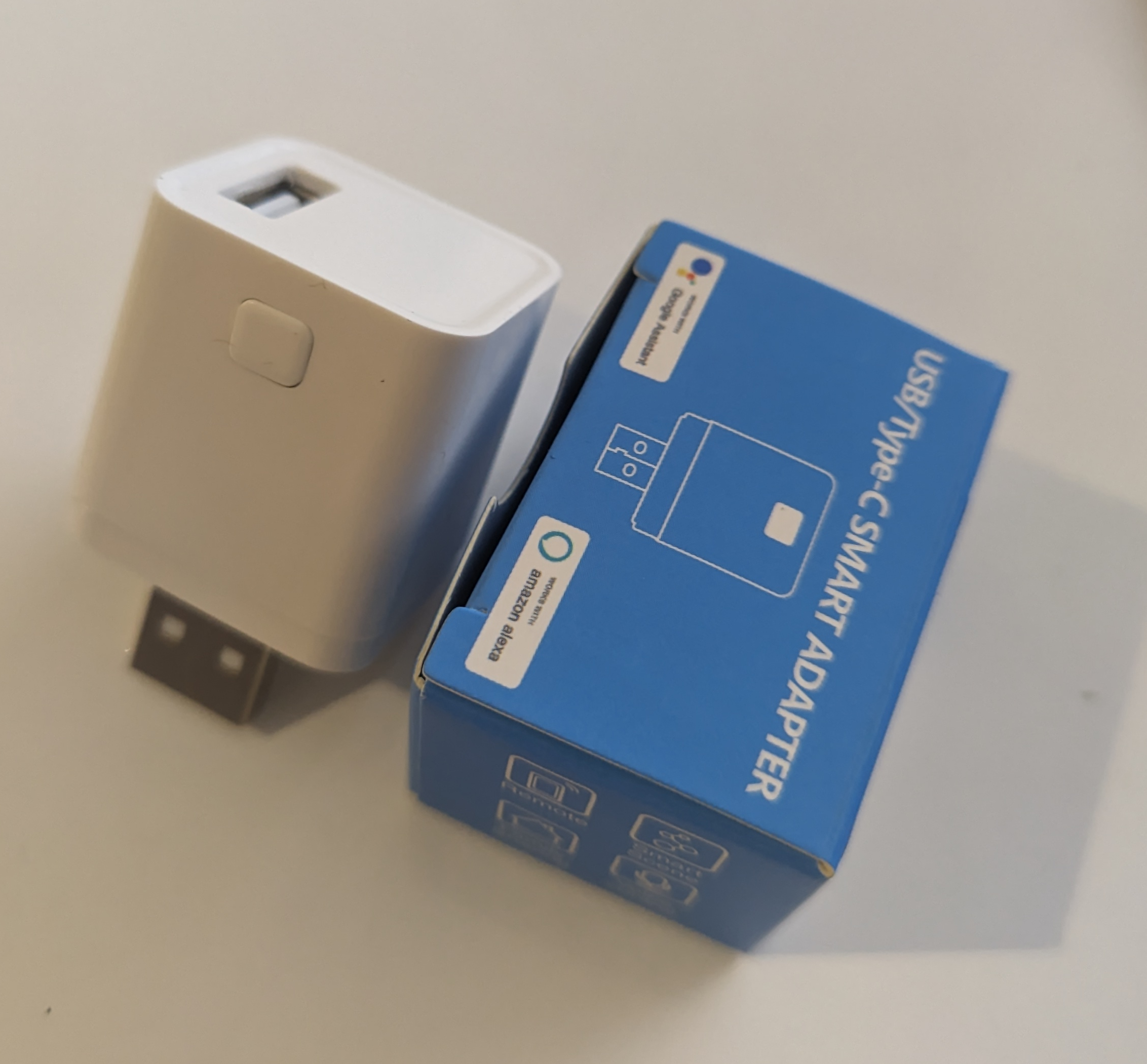

  • Two cheap USB smart adapters for remotely switching a USB-connected device, sold as Type C but actually Type A.

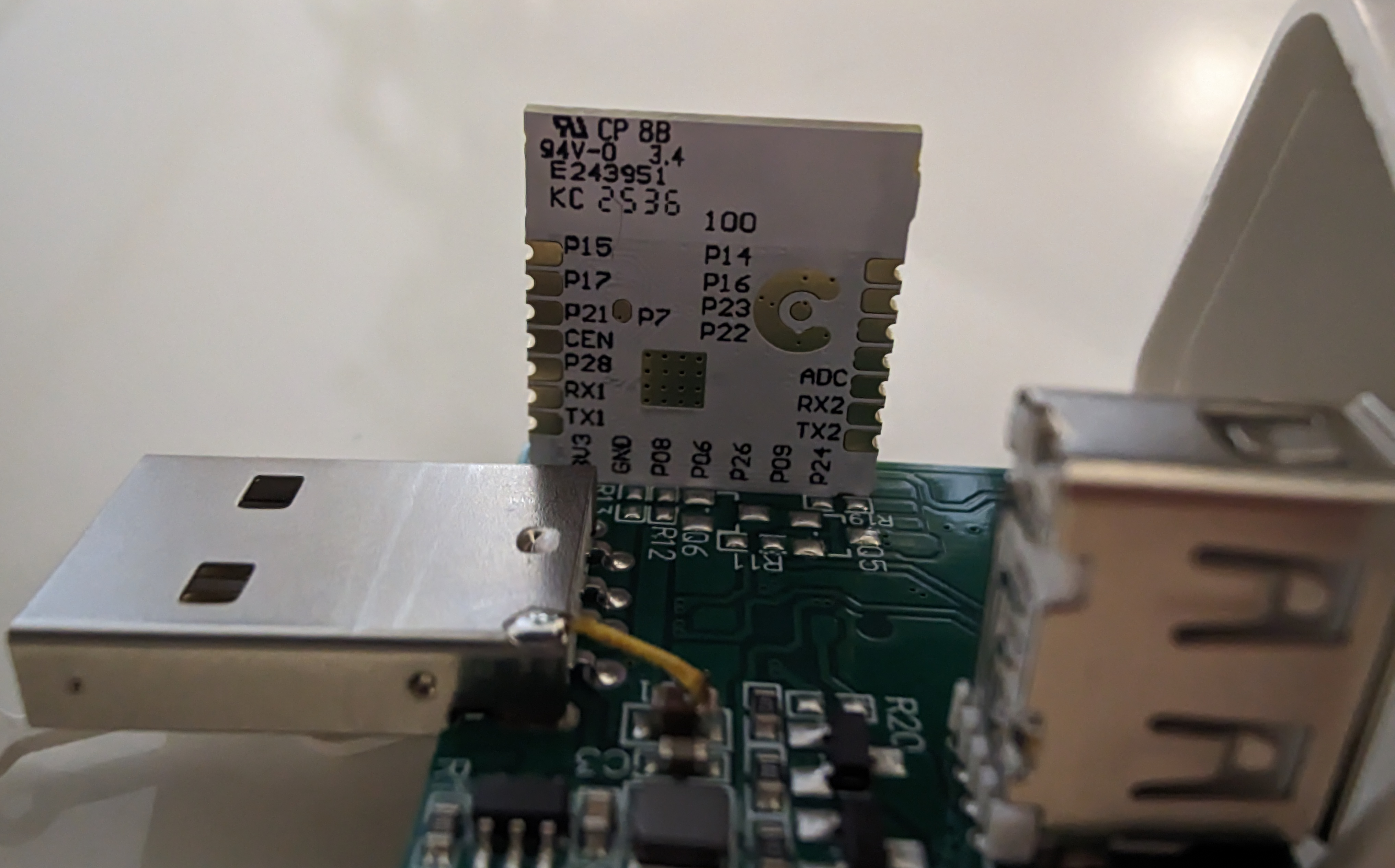

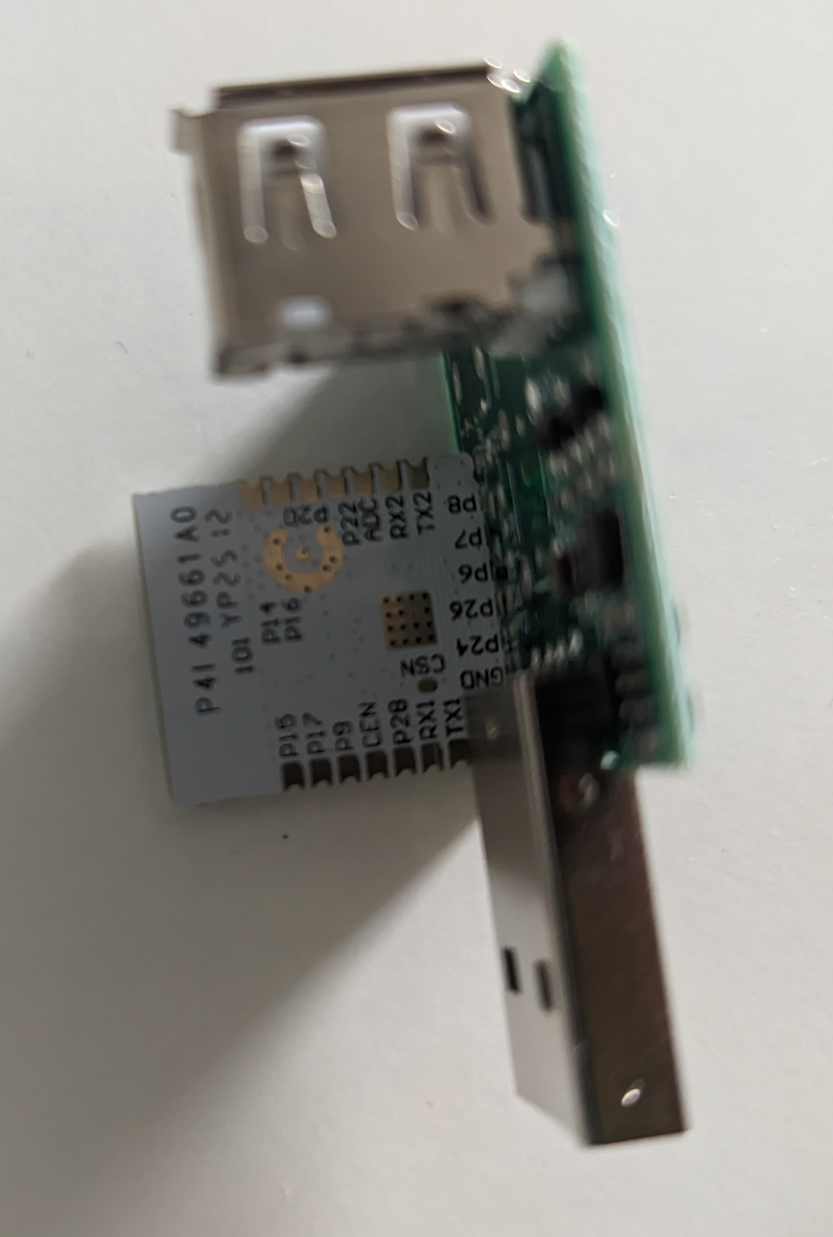

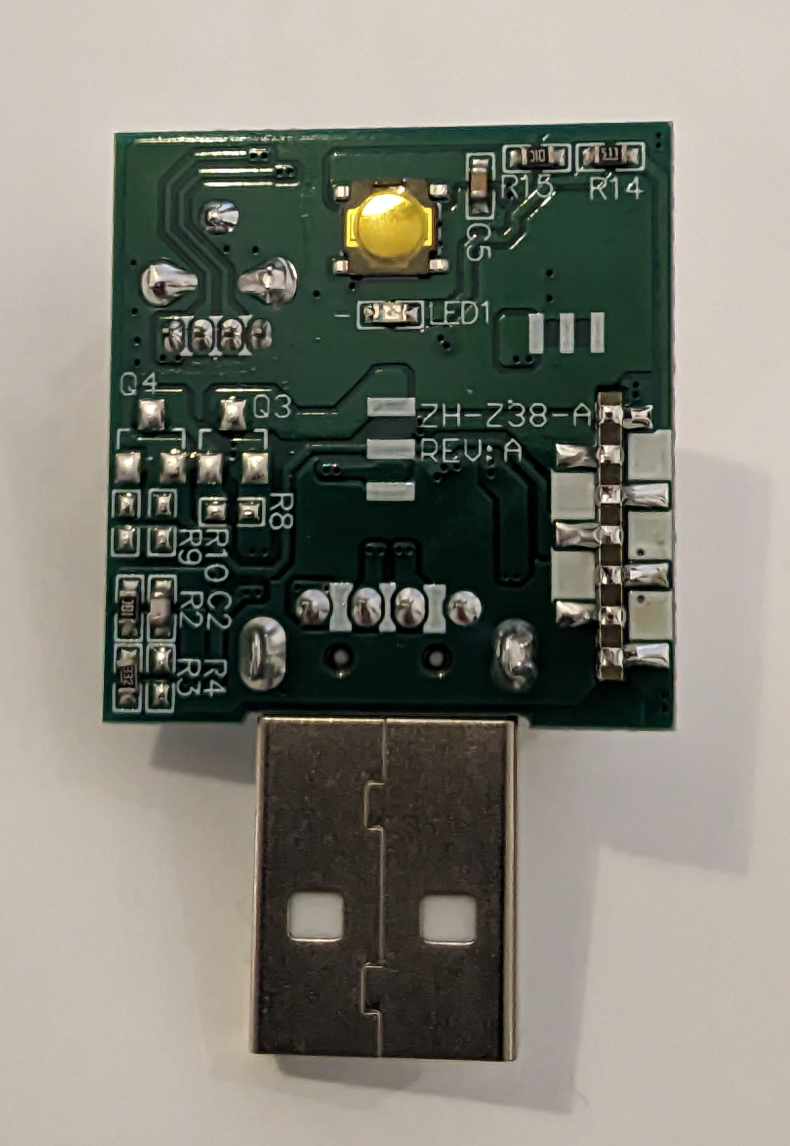

  • Both units were opened by unclipping the latches, then the Wi-Fi chips were desoldered from the main board and flashed with OpenBeken using BK7231Flasher.
  • The two samples used different processors: BK7231N/CBU and BK7238/T1-U-HL.
  • I really like the cutting off of devices from the ubiquitous cloud, and at the same time the simplicity of use and professionalism of the OpenBeken project.
    I had a need to use a remote on/off switch for a USB-connected device, so I bought two pieces of cheap adapters.
    I was guided by the photos and the picture on the packaging, as they are described as Type C, but are in fact Type A.
    White USB adapter with a button next to blue packaging labeled “USB Type-C SMART ADAPTER” Wi-Fi USB switch module with type A port and printed power specifications Disassembled USB adapter showing PCB board and white plastic casing
    Quite easy to open, just undermine the latches and pull the flap upwards.
    I ordered two pieces and each looks different from the ones I've seen in other topics, plus each has a different processor (BK7231N/CBU and BK7238/T1-U-HL) .
    I've uploaded both seamlessly using the BK7231Flasher, having soldered them off the main board.
