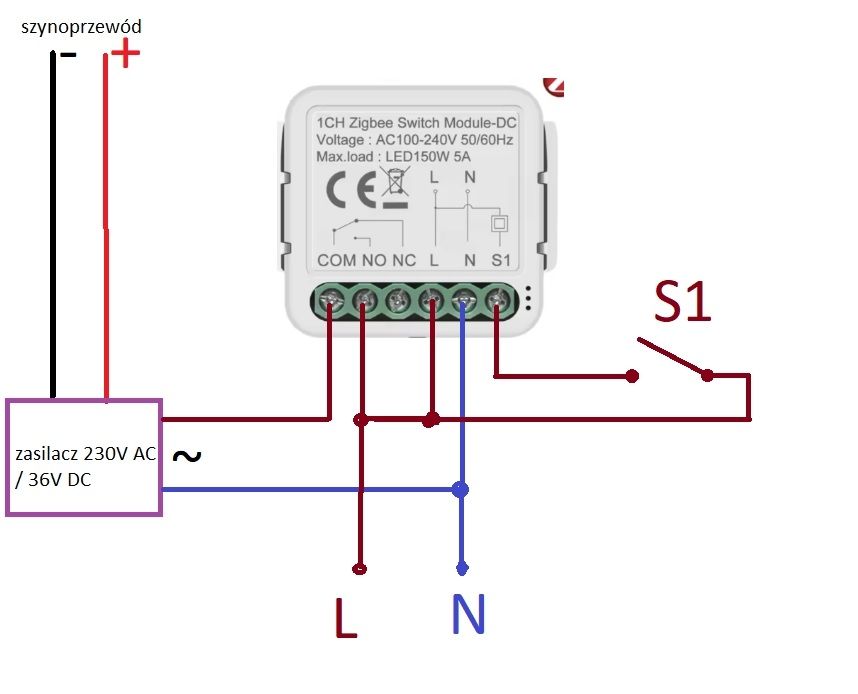

    Wiring diagram for a 1CH Zigbee switch module with COM/NO/NC, L and N terminals, and S1 switch
    Yes - it will work for you to just switch the power on and off to the busbars via this module from the button when you connect it as drawn as well as remotely provided it is designed to work remotely, because from what you've shown I'm not sure, probably a link to it would be more helpful, for I don't see a Reset/Pair button or radio or other communication symbol on it itself.... Admittedly there is something like that next to the word TUYA, but the logo of that company inherently has that stamp, well I also encounter that sometimes we buy not what we want, especially on a well known portal....
