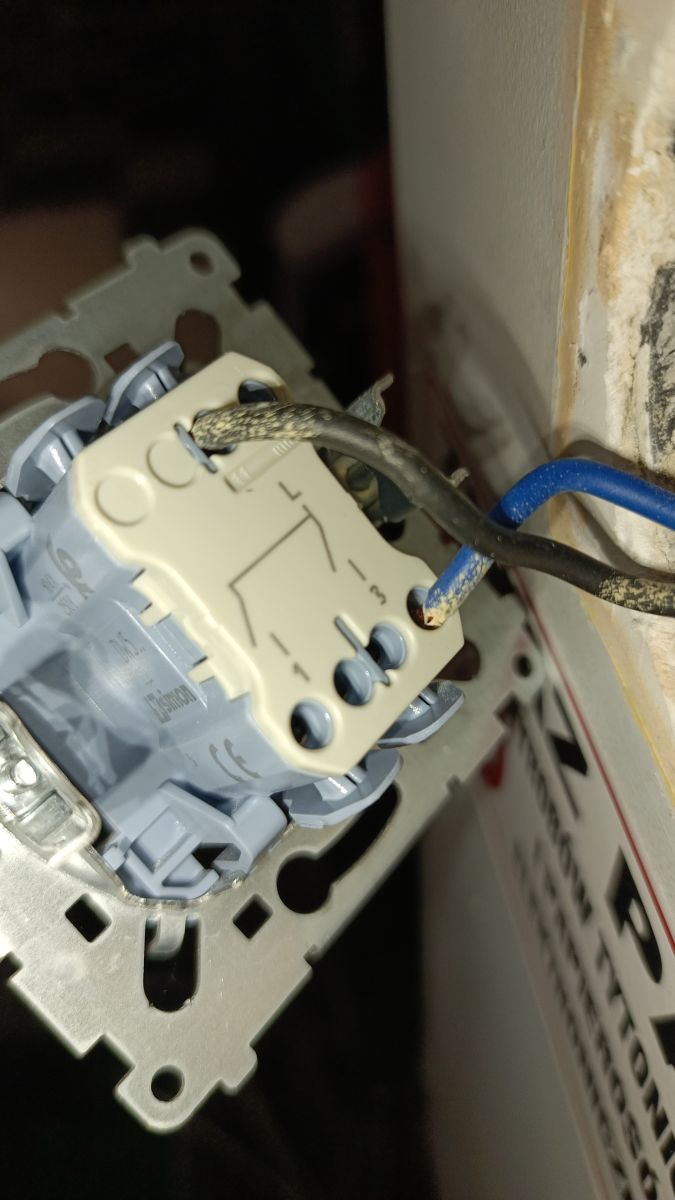

    I have two lamps that light up the car park in front of my house. They are connected to 230V and switched on using a switch in the building.
    What was my surprise when I looked into this switch and only two wires and a third hidden yellow-green wire appeared.

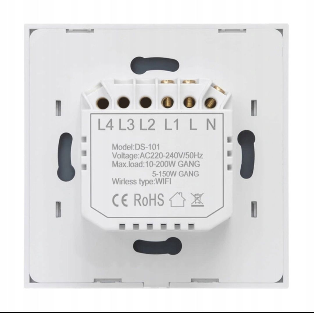

    As far as I know Smart switches have an input and an output is there any way of connecting such a switch to such an installation?
    Close-up of a light switch mechanism in a wall box with blue and black wires connected Back of DS-101 Wi‑Fi smart wall switch with terminals L4, L3, L2, L1, L and N

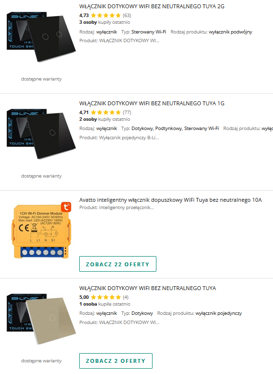

    There are special versions of switches which should work in such a situation, so-called "without neutral":
    Screenshot of listings for Tuya Wi‑Fi light switches “no neutral,” with product thumbnails and ratings

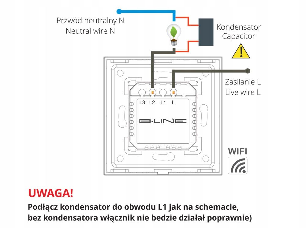

    Random example:
    Clicking light switch with Wi-Fi without neutral wire - firmware change - ATLO-WB3-Tuya
    Wiring diagram for a no-neutral Wi‑Fi light switch with a capacitor connected at the lamp.

    That is, I plug this capacitor into my neutral wire?

    I would first check if the power wire is phase or neutral.
    If it is phase - which it should be - then I would think about how to feed the neutral into this box to power the controller and everything will work :)

    I just don't know what the blue wire is, I won't be able to check until tonight
  • #6 21837197
    konsum
    Posts: 1529
    Help: 99
    Rate: 295
    I checked with a tester and there is voltage in all three wires, in the unconnected yellow-green one too, voltage disappears from the blue one when I turn off the light. I don't know what the voltage is because I didn't take a meter, I'll be here again tomorrow, then I'll take a meter.
