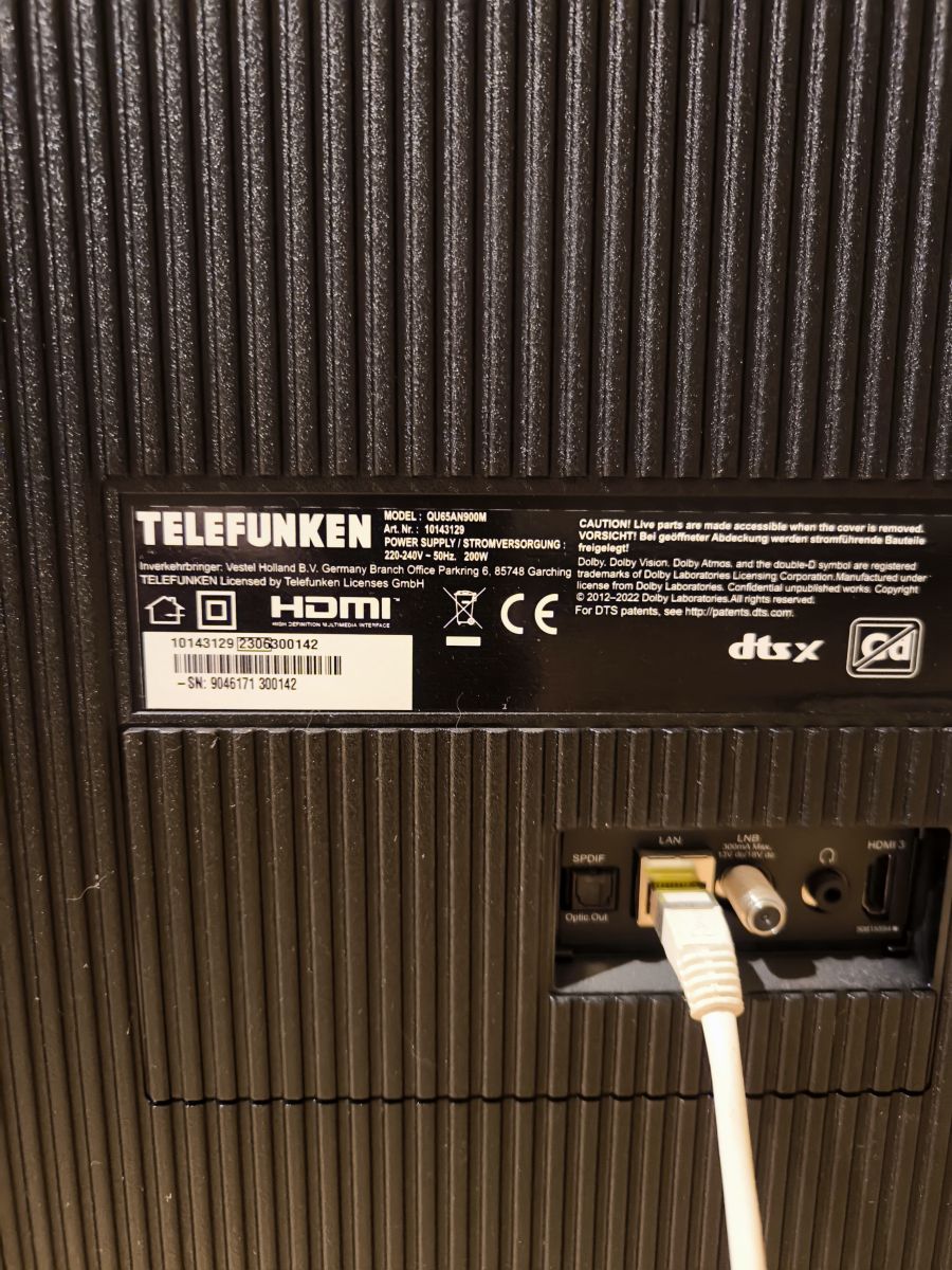

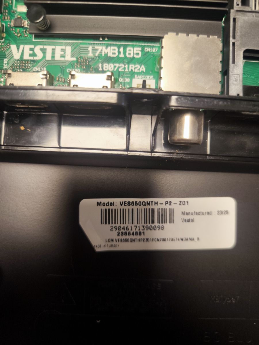

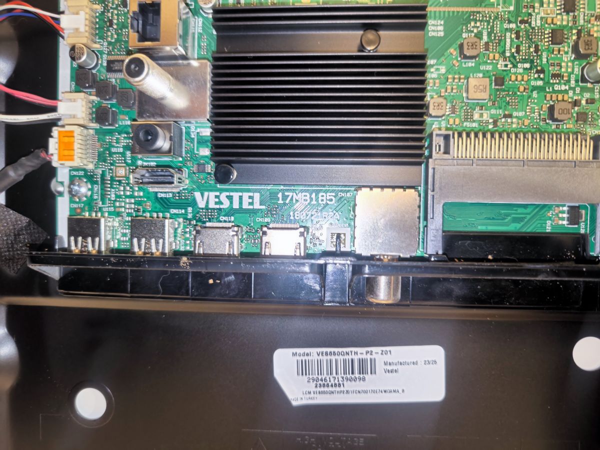

    Hello, I have a Telefunken QU65AN900M TV and after the update and restart, it doesn't want to run anymore. Where can I get the firmware for my Vestel base blanket? Thank you for your reply. I attach photos of the board and the label.

  • #6 21845644
    rob1
    Level 25  
    Posts: 1134
    Help: 68
    Rate: 140
    No longer bootable
    EMCC faulty

  • #8 21846686
    rob1
    Level 25  
    Posts: 1134
    Help: 68
    Rate: 140
    Defective TV memory
    The board needs to be repaired
    Added after 25 [minutes]:
    Do not load software from another type of TV!!!!then you lose receiver functions and do not know whether the remote control will work
