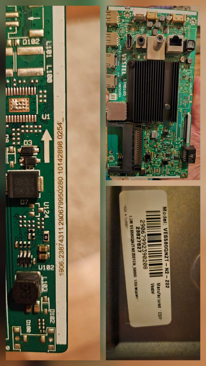

    I need firmware for a **Telefunken XU58AN660S** TV.
    Mainboard: **Vestel 17MB185**
    Panel: **VES580QNZT-N2-Z02**
    Profile ID: **23827827**
    Serial number: **9067992300206**
    Problem:
    The TV does not turn on. Only the **red standby LED is on**.
    Power supply is OK.
    I am looking for:
    • **USB recovery firmware** for 17MB185
    or
    • **full eMMC dump**
    If anyone has firmware compatible with **VES580QNZT-N2 panel**, please share.
    Photo of the board label is attached.
    Thank you.

    In most cases, with such symptoms, the EMMC KLM8G1GETF-B041 memory is damaged. Upload a snapshot of such a case, then update via USB.
    Added after 4 [minutes]:
    When flashing from USB, rename the file MDS_upgrade_image_no_tvcertificate.pkg to upgrade_image_no_tvcertificate.pkg

  • Standby light on, no button response or picture
    #7 21924270
    mind111
    >>21924161 >>21924161
    I’ve tried that and all the other options provided here:
    https://tavsiyeforumu.com/konu/vestel-yazilim-yukleme-anlatim.2744/
    No changes.
    The power board voltages look fine. The service manual I have is for a different revision, but the motherboard voltages look fine too.
    When I plug the TV into the socket, only the red standby light is on. The red light on the optical connection is on, and the motherboard’s CPU is warming up (I can feel it on the heat sink).
    There is no response to the remote control buttons or the physical buttons on the TV itself. The screen is black.
