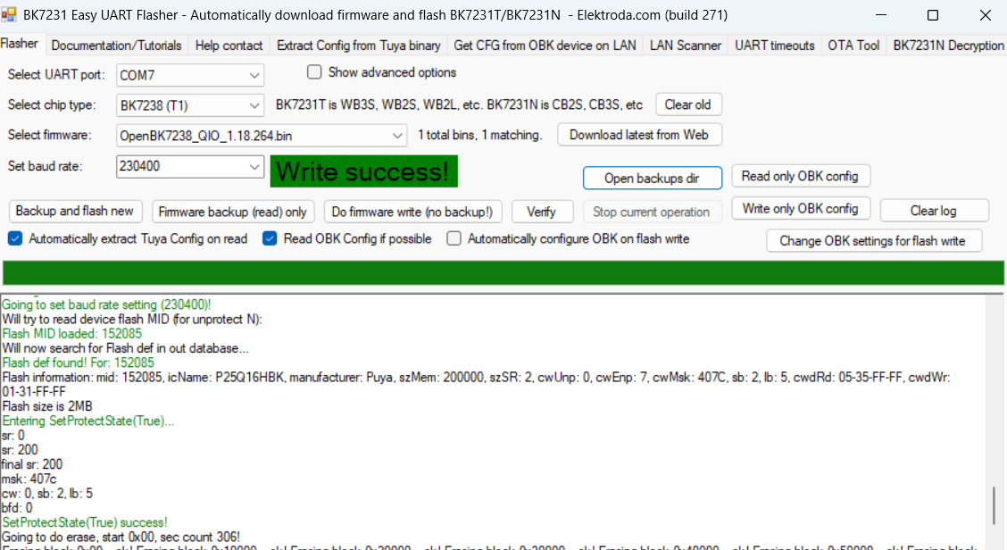

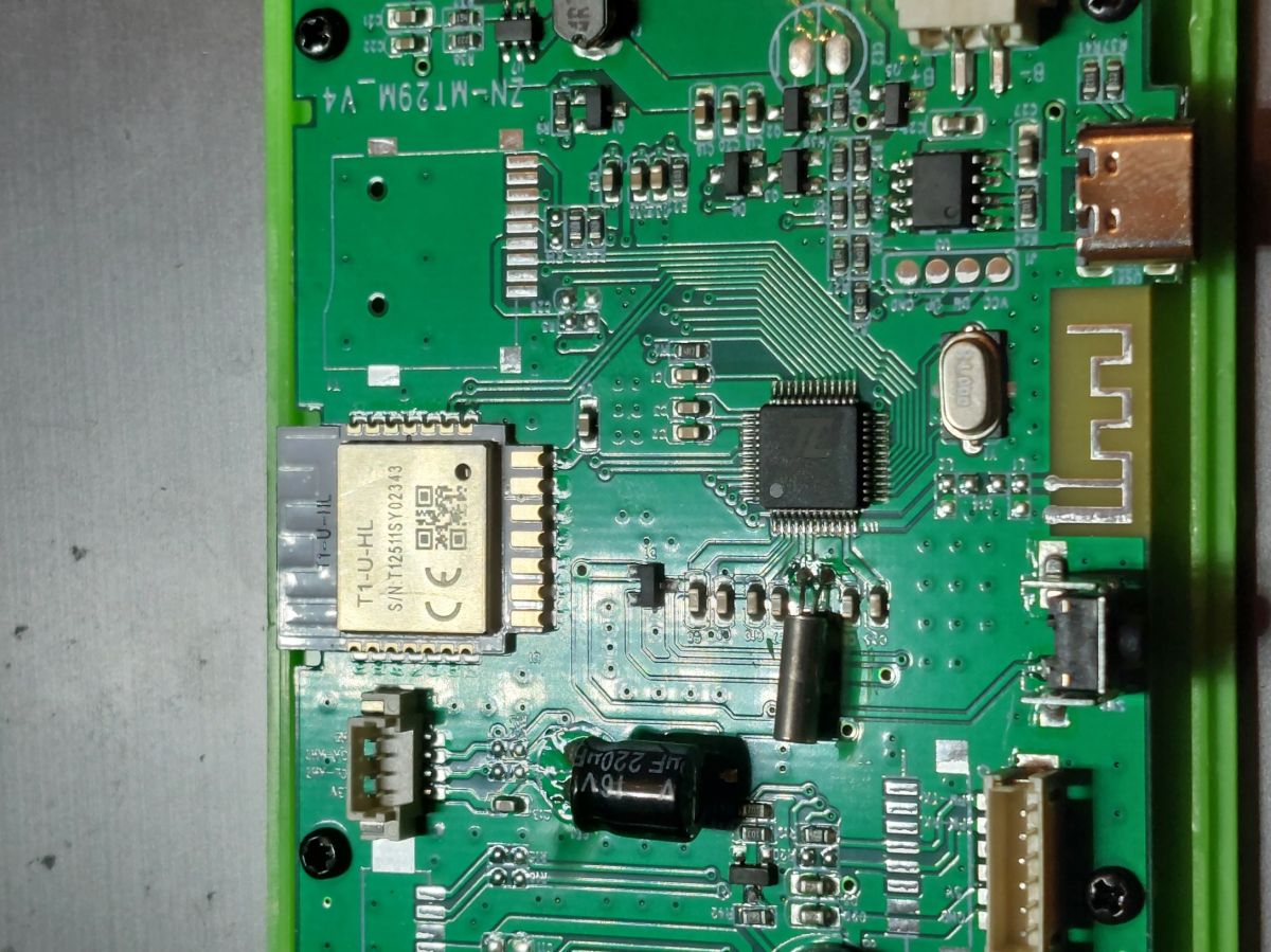

    @divadiow it looks like. Can I somehow check this without unsoldering the T1-U-HL screen?
    Screenshot of BK7231 Easy UART Flasher showing “Write success!” and a flashing log
    Close-up of a green PCB with a T1-U-HL module, an IC, and a micro-USB port

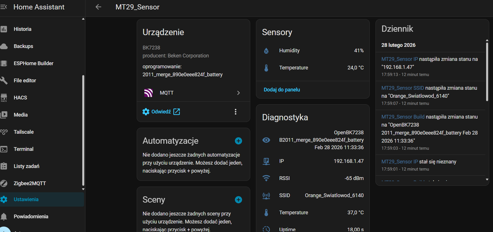

    @p.kaczmarek2, thanks. Yes, that's right. All that's left is to find 13 sensors and it'll be ok. If anyone has any ideas, I'd be happy to check. The AI is very keen to help me but, as you can see below, it's going reluctantly.
    Home Assistant screenshot showing MT29_Sensor device details with sensors and log panels.
    i am also attaching a possible batch for testing.
    • OpenBK7231T_App_2011_merge_890e0eee824f_OpenBK7238_battery.zip (2.04 MB) You must be logged in to download this attachment.
