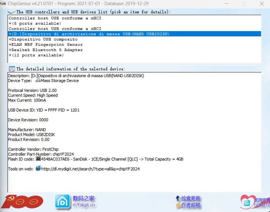

    CHIP GENIUS
    Description: [D:]Dispositivo di archiviazione di massa USB(NAND USB2DISK)
    Device Type: Mass Storage Device
    Protocol Version: USB 2.00
    Current Speed: High Speed
    Max Current: 100 mA
    USB Device ID: VID = FFFF PID = 1201
    Device Revision: 0000
    Manufacturer: NAND
    Product Model: USB2DISK
    Product Revision: 0.00
    Controller Vendor: FirstChip
    Controller Part-Number: chipYF2024
    Flash ID code: 4548AC037AE6 - SanDisk - 1CE/Single Channel [QLC] -> Total Capacity = 4 GB
    Tools on web: http://dl.mydigit.net/search/?type=all&q=chipYF2024

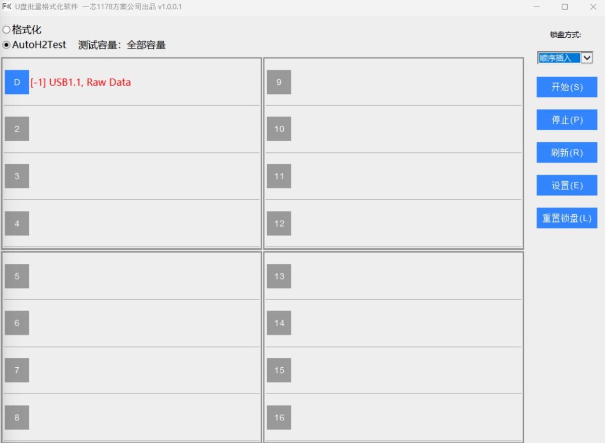

    I don't find this chip in the FirstChip software, I have used every version of FirstChip MP but none of them recognize it, it is only seen by FirstChip FC1178 CheckTools

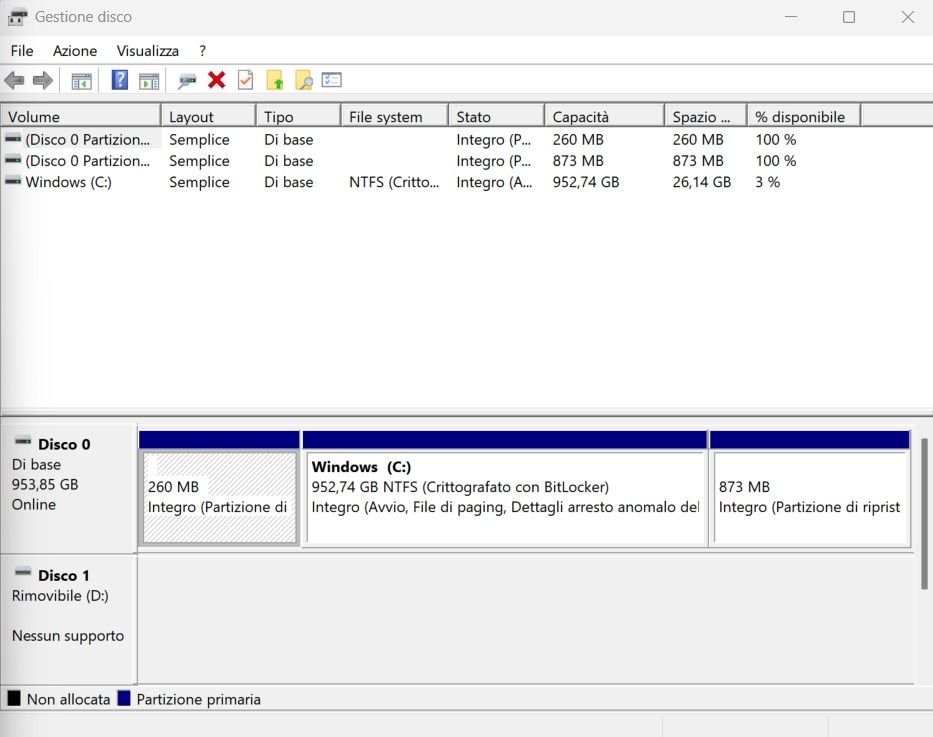

    It worked but I know it was a fake. Yesterday I inserted it, but it appears as a USB drive, and when I click it it says "Insert a disk into the drive".
    AI: When you plug the USB stick into your computer, does it show up in Windows Disk Management, and if so, what does it display (e.g., unallocated space, no media, errors)?
    In Disk Management it appears "No Media" and don't possible format

    >>21816791 Hi, I used fc diesorting but nothing, installed the driver but nothing, the program not recognize this chip USB pen
