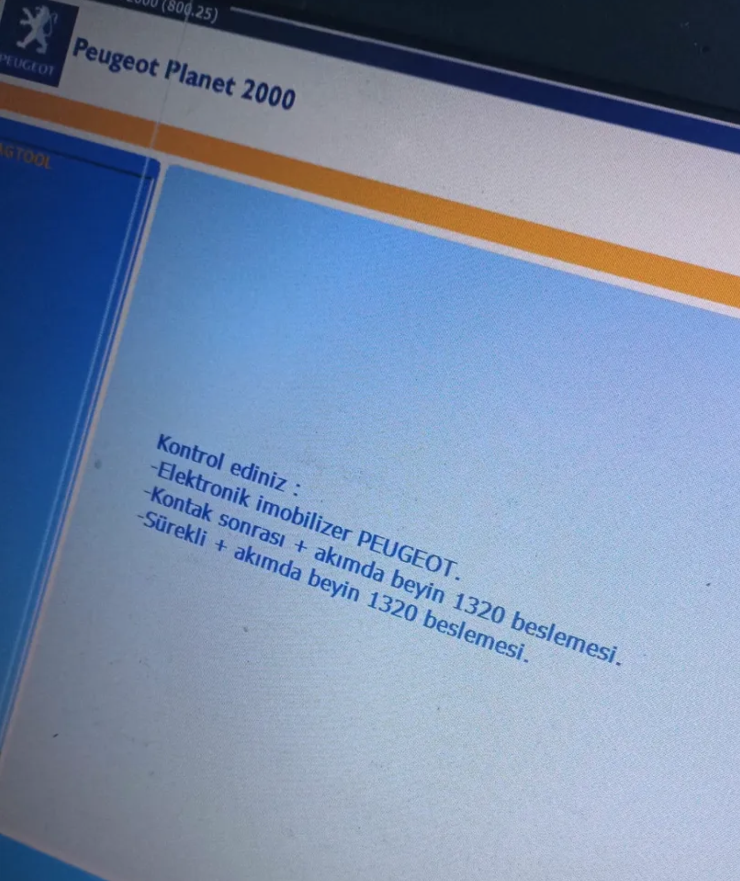

    Electrical problems with my Peugeot 307 CC 2.0 2004
    I am experiencing several strange electrical problems with my car.
    Problem 1
    The windshield wipers and headlights start operating by themselves without touching
    The starter motor cranks normally, but the engine does not start.

    Diagnostic Tools:
    PP2000 v7 and v9 — cannot connect, ECU communication error
    Launch — connects successfully, BSI/ECU/ABS all show Normal
    PP2000 gave these warnings on first connection attempt: "No permanent ve supply to ECU 1320" and "No post-ignition ve supply to ECU 1320"

    Screen showing Peugeot Planet 2000 interface with Peugeot logo and a Turkish checklist message.
