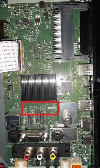

    Main 17MB171 ???
    Panel VES315WNGS-2D-N52 ???

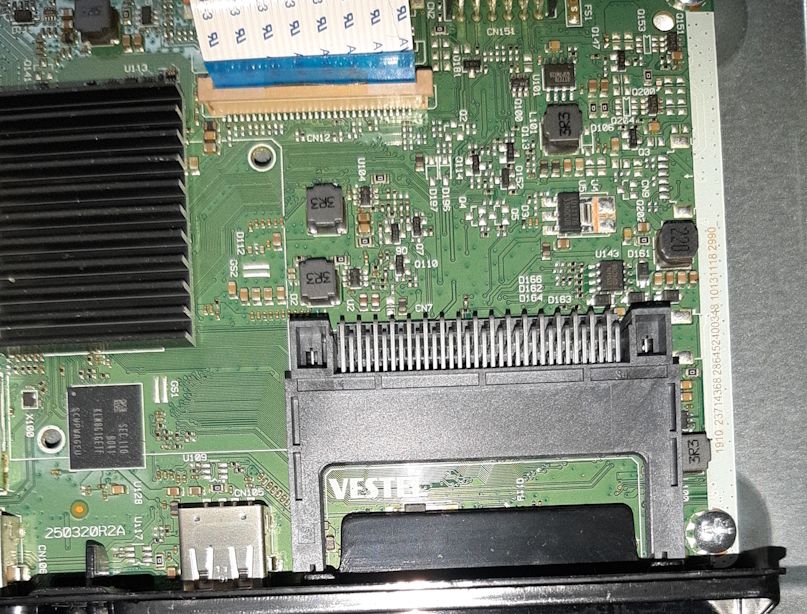

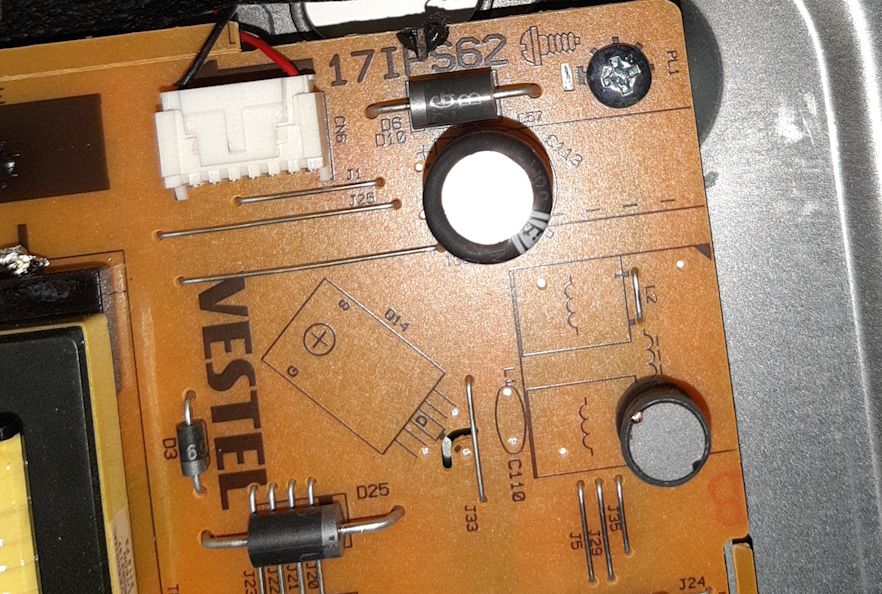

    Sorry, but I'm not very familiar with this. I think they are the following: 17IPS62 - 250320R2A. I'm attaching photos to be sure. If so, I'd like clarification on what else to do.

    Added after 4 [hours] 38 [minutes]:
    Sorry, I found it! 17MB171

    #4 21868572
    billobirillo
    Posts: 1110
    Help: 333
    Rate: 768
    here is the right software for your hitachi link
    main 17MB171
    panel VES315WNGH-2D-N51 cell HKC PT320AT02-2 V1.0
    the software is from a toshiba
    it will work with just one difference: the startup logo will change in toshiba
  • #5 21868667
    Candido9
    Great, the TV works perfectly now. Many thanks for your invaluable help.
