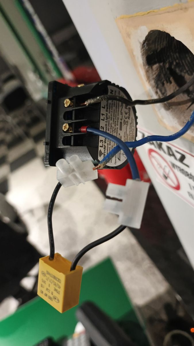

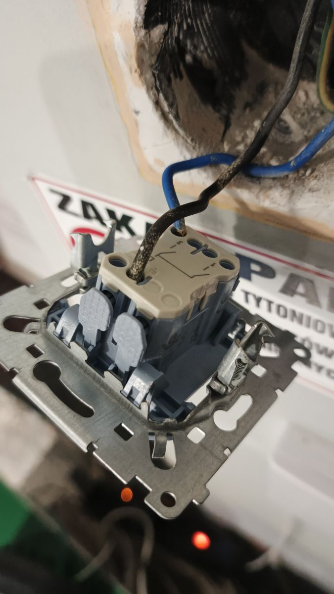

    I'd like some advice, I'm more concerned with gaining theoretical knowledge as this is more of a conundrum that an electrician will have to deal with, namely.
    I have a street light which I switch on with a normal light switch and a contactor is switched on, I wanted to install a smart switch so that this light starts automatically etc.
    The switch has a two wire installation, black phase and blue where the voltage appears when the light is switched on.
    I fitted the smart switch to the installation without Neutral initially without the capacitor that was attached for proper operation without the Neutral wire and when I turn on the light the contactor starts the lighting comes on, but after a fraction of a second it turns off because the switch loses power and regains it after a while.
    When I fitted a capacitor it works in a similar way, only that the power is maintained for a while longer and then it goes out again and switches off.
    Would anyone be so good as to advise if there is any way to make this switch work?
    I would add that there is a spare yellow/green wire in the box from the switch and once fetched I consulted an electrician he said it could be used to power this switch.

    It's not working properly because you don't have a load just a contactor coil.
    When does this lighting come on? You can give something else.

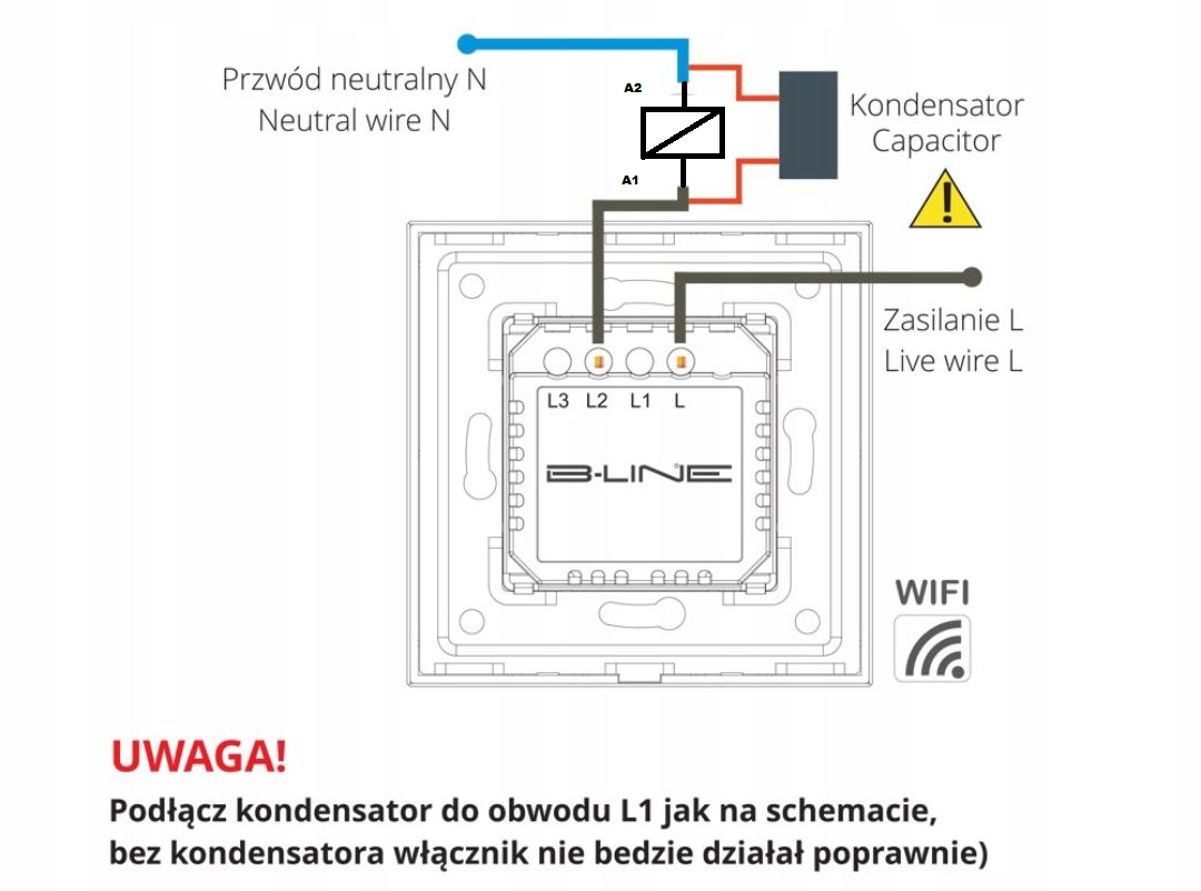

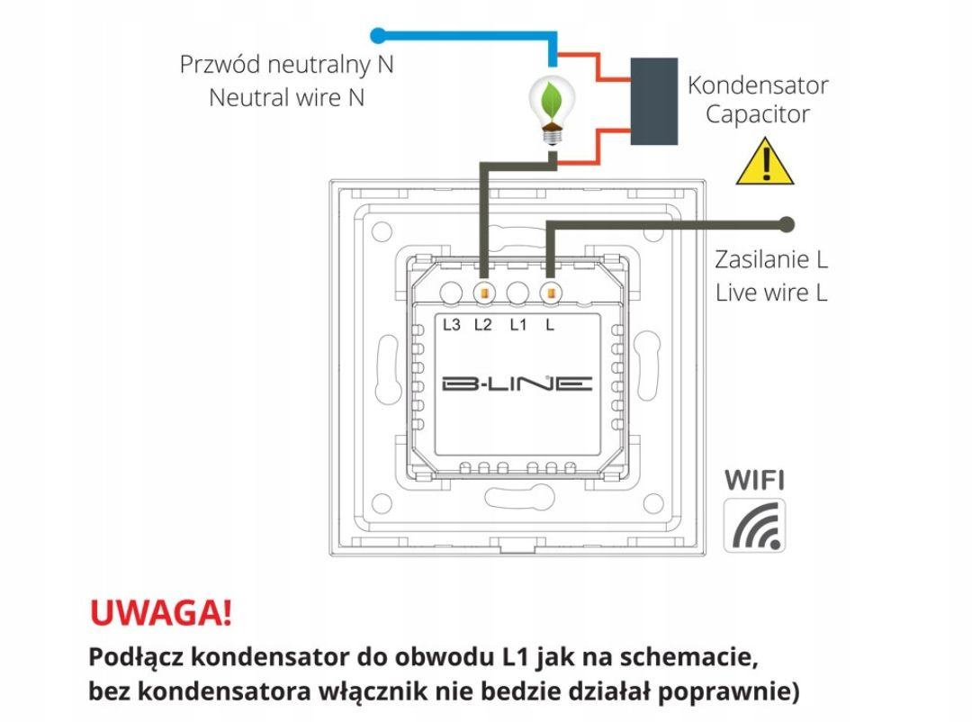

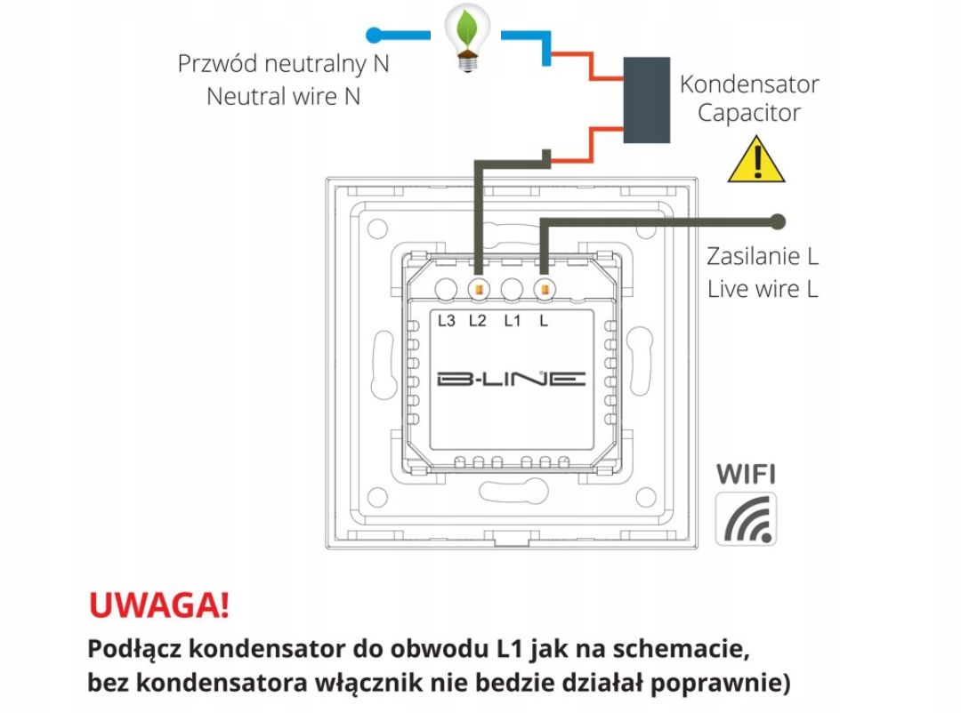

    You have connected it incorrectly according to the diagram
    it is supposed to be:
    Wiring diagram for B-LINE WiFi switch with capacitor, neutral N wire, and live L supply
    you have done :
    Wiring diagram for B-LINE switch module with capacitor connected to L1 and lamp circuit
    konsum wrote:
    Add that in the box from the switch there is a free wire in yellow-green colour and once downloading I consulted it with the electrician and he said that it can be used to power this switch.
    Tell the electrician to suggest such a solution at the qualification exam (he passes one every 5 years).

    tos18 wrote:
    Tell the electrician to propose such a solution at the qualification exam (he passes one every 5 years).
    I think what he meant was that you can switch this wire in the switchboard and make it neutral.
    tos18 wrote:
    You have connected this contrary to the schematic
    Unfortunately I have no way of getting to those tubes to connect that capacitor there.
    But is the capacitor to blame for this switch not working properly?

    konsum wrote:
    hands are falling off.
    konsum wrote:
    Unfortunately I have no way of getting to those lamps to connect that capacitor there.
    Why to the lamps if the switch controls the contactor ? - in parallel to the coil of the contactor.
    Wiring diagram for B‑LINE Wi‑Fi switch with neutral N, live L, and a capacitor connected to L1

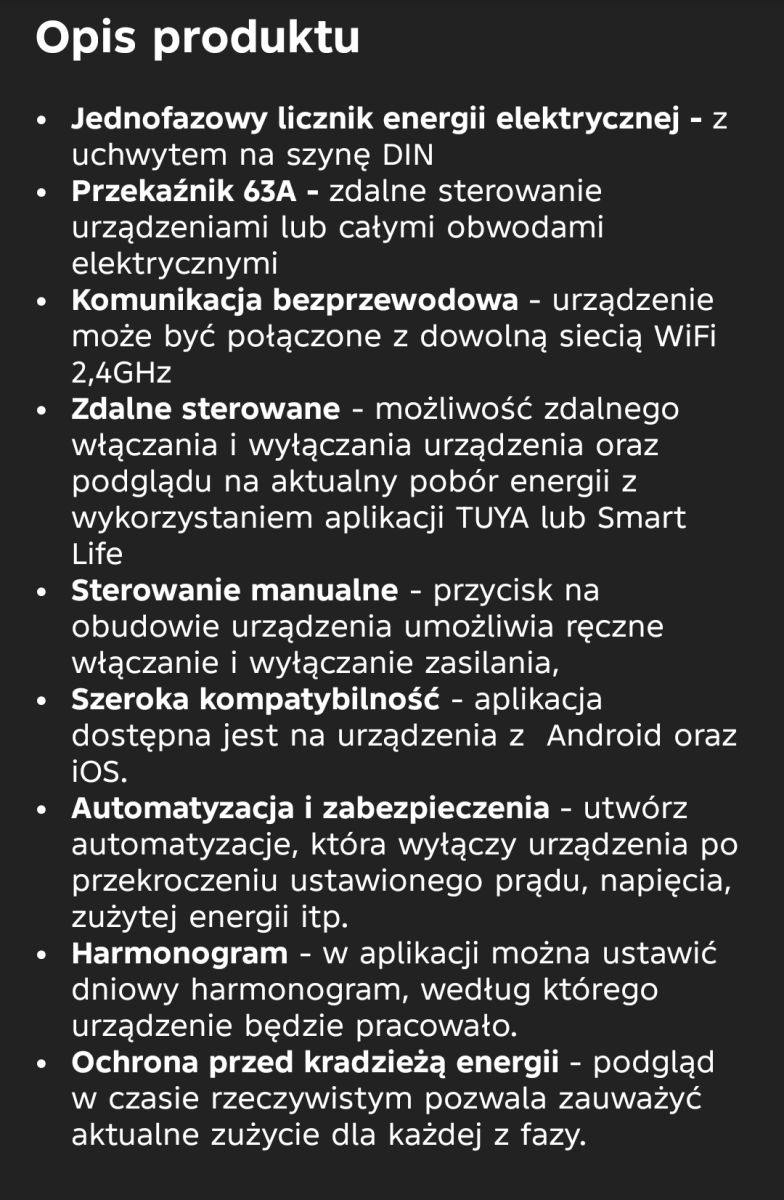

    And what do you think such a smart relay I can use and will work well with this installation?
    Tongou DIN-rail Wi‑Fi relay with N and L terminals shown in a product listing screenshot Screenshot titled “Opis produktu” listing features of an energy meter and 63A Wi‑Fi relay

    konsum wrote:
    the contactor is connected
    Connect in parallel to the contactor
    https://allegro.pl/oferta/eliminator-rozblyskow-zarowek-led-kondensator-wksl-13101838215
    >>21876186
    Instead of a contactor, this energy meter can be connected. It will not be possible to switch on manually and only with the switch, the one that has been on the wall so far.
